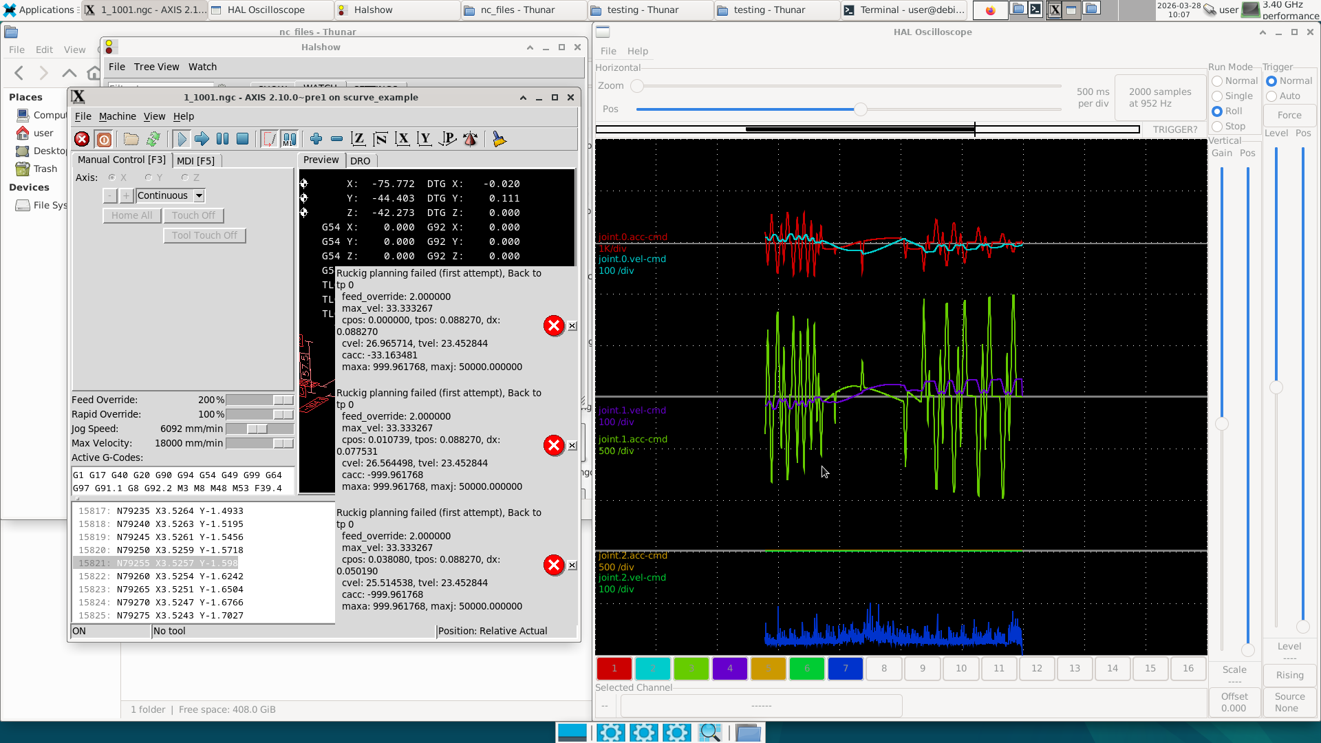

30 Mar 2026 11:09 - 30 Mar 2026 12:59 #344958

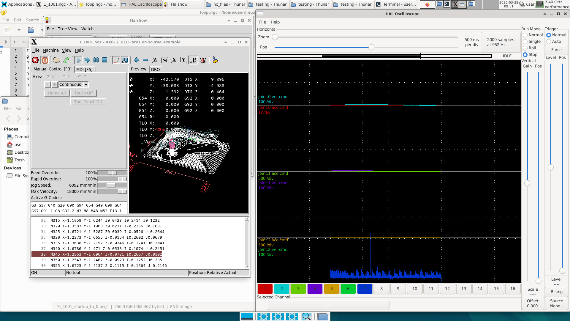

by endian
my next observation is - high value of G64 tolerance around 0.1(650us spikes) is spiking more than 0.001(250us spikes)
best setup till now ... most influential spiking thingy is the
Replied by endian on topic LinuxCNC S-Curve Accelerations
I think the best way to apply that... its consulate with Luca or Yang Yang if they are allready not using something like that now... I'm not that familiar with their code till now ... it toooo way complicated for meYes Rod .. it is solution but it is creating constant delay between control position -> DFIR -> current position of tool ....
It will not add any delay as it should be applied as the acceleration is calculated or read per servo cycle. Just not sure how you need to use it.
the size of the buffer is configurable.
Any other published moving average solution wanted to use loops which are a source of delay so I devised this..
One of the cleverest algorithms I have ever coded...
OPTIMIZATION_DEPTH... this creates real messARC_BLEND_ENABLE = 1
ARC_BLEND_FALLBACK_ENABLE = 1
ARC_BLEND_OPTIMIZATION_DEPTH = 8
ARC_BLEND_RAMP_FREQ = 64
ARC_BLEND_GAP_CYCLES = 64
TC_QUEUE_SIZE = 200
Last edit: 30 Mar 2026 12:59 by endian. Reason: setup add

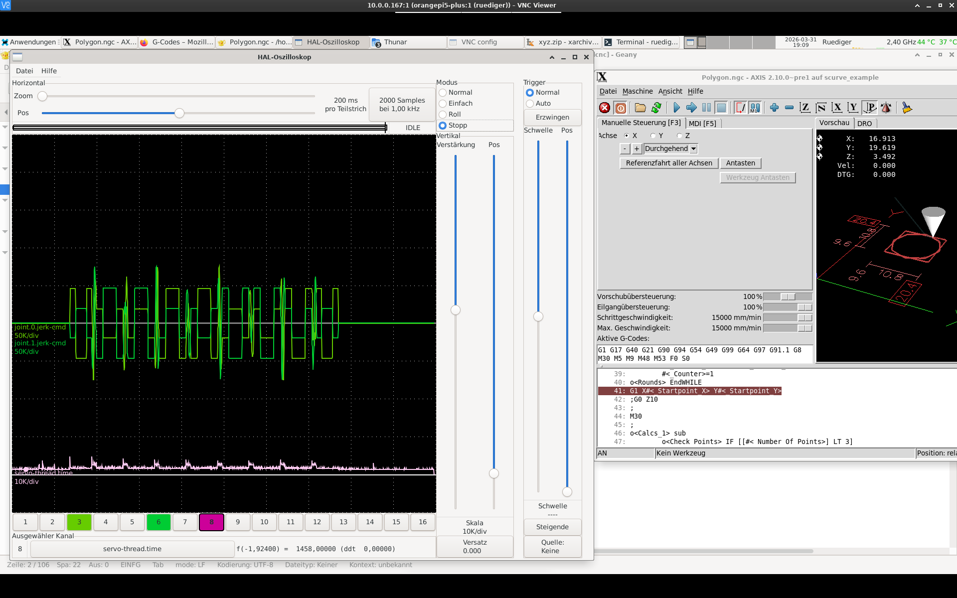

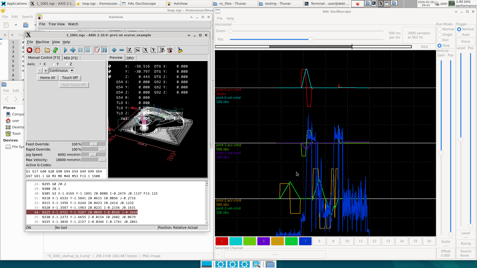

03 Apr 2026 14:27 #345128
by ruediger123
Replied by ruediger123 on topic LinuxCNC S-Curve Accelerations
@grandixximo
The machine is congigured with a 1ms servo cycle, the speed with 15 m/min, the acceleration with 5 m/s² and the jerk with 50 m/s³ so nothing unusual for servo axes.
P64 P0.01 Q0.0 is also not unusual.
In my opinion, the limits for jerk, acceleration and speed should not be exceeded so that the behavior of the machine is predictable.
The unusual thing from my point of view is that MAX_LINEAR_JERK and MAX_JERK are different.
If there are restrictions on certain parameters, please let me know so that I can take them into account in my tests.

03 Apr 2026 20:36 - 03 Apr 2026 22:20 #345135
by grandixximo
Replied by grandixximo on topic LinuxCNC S-Curve Accelerations
@ruediger123
The restriction is the corner itself. A sharp corner is a mathematical direction discontinuity. The velocity vector must change by ~191 mm/s across a 45° turn. With a 1ms cycle time, respecting 50 m/s³ jerk would require spreading that change over ~3800 cycles, during which the machine travels nearly a meter. No feed rate fixes this, the problem is geometric.
The only mathematically correct solution within your parameters is for the planner to detect that no valid cornering speed exists that satisfies the jerk limit given the available segment geometry, and fall back to a full stop at the corner. That is exactly G61.1 behavior.
This is actually a valid point and potentially a missing feature: the junction velocity calculation should be jerk-aware, and when the jerk-constrained cornering speed rounds down to zero, the planner should stop rather than arrive too fast and spike. Currently it may only be acceleration-aware at the junction, which allows a non-zero entry speed that looks acceptable to the acceleration limit but still violates jerk because the ramp does not fit in the available geometry.
The practical workaround in the meantime is either G61.1 explicitly, or a P tolerance of several mm to give the planner room for a proper S-curve through the corner. P0.01 is geometrically equivalent to sharp.
