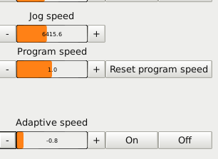

Update :
I had to change speedcontrol.py to add a negative value for the adaptive feed widget, named speedcontrol widget in glade.
To do this, i had have done some research before.
You see, you can set a negative value. In glade this is not possible. Normal you can't do this, unless you change 1 text line in
the speedconrol.py file. Located : linuxcnc../lib/python/gladevcp/speedcontrol.py
Oke what to change in that file? Look ad this comment code i added to the custom gscreen python file :
#Open speedcontrol.py in directory : /home/grotius/linuxcnc../lib/python/gladevcp/speedcontrol.py
#Change hard settings :
#        'min' : (gobject.TYPE_FLOAT, 'Min Value', 'The min allowed value to apply',
#        -10.0, 99999.0, 0.0, gobject.PARAM_READWRITE | gobject.PARAM_CONSTRUCT),
#In gmocappy they set negative value like this :   self.widgets.spc_jog_vel.set_property("min", -10)
#In custom gscreen here, the widged is called : adaptive_speed
Value -10.0 is in this case the max negative value for speedwidget's. This is working for all the widget's you want, but just
add the intitial code to the widget.
Gmocappy has trouble not with negative jogging widget's, but with negative override value's. I don't know why that is...
I think Norbert know's this.
In the glade file you don't have to change anything.
The custom gscreen python code is now expanded with setting the speedcontrol widget to negative value.
Also you have to tune the widget in setting speed and incremental ( speed in millisec. and incremental in 10 times or 100 times or what you want )
So here the code :
self.widgets.adaptive_speed.set_property("min", -1)
self.widgets.adaptive_speed.set_property("max", 1)
self.widgets.adaptive_speed.set_value(0)
#increment
self.widgets.adaptive_speed.set_property("increment", 0.1)
#inc_speed
self.widgets.adaptive_speed.set_property("inc_speed", 100)
I think the linuxcnc software developpers will pick this up and merge it into the next linux version. For now we have to do it by this way. And it's working very good. Also the widget looks nice and is ready for touchscreen use i read somewhere.
Last edit: 07 Feb 2018 21:18 by Grotius.

Yesterday i added a few new lines in the python program, this is basis for THC function. (torch height controller)
I have tested the THCUD funtion orginally written by JT. I also have compiled the THCUD module to different working modules before, i will make a example of how to do this later.
Testing of machine set up go's good when you have a complete set up of motors next to you, while your wife is sitting on the cough with no underwair. Then your view is perfect.
#thc function, this has to do with the linuxcnc thcud component and is connected in postgui.hal file
       self.c = hal.component("thc")
       self.c.newpin("enable", hal.HAL_BIT, hal.HAL_IN)
       self.c.newparam("velocity", hal.HAL_FLOAT, hal.HAL_RO)
Okey here we have a pin and a parameter. The pin is for enable the function with yes or no. The parameter is for passing the value,
like 0 or 2 or 10 or 15524454. Float is for big value's. Bit is for yes or no. Only 1 or 0.
Okey next we add :
    #THC function on or off, see thcud component in postgui.hal => link method over there : thc_on.enable
    #For more info visit : http://linuxcnc.org/docs/html/man/man9/thcud.9.html
    def on_thc_on_pressed(self, widget, data=None):
        self.c['enable'] = 1
        #set directly the velocity value to the parameter, widgets don't update that for you unles you press them :
        self.c['velocity'] = self.widgets.thc_speed.get_value()
    def on_thc_off_pressed(self, widget, data=None):
        self.c['enable'] = 0
    def on_thc_speed_value_changed(self, widget, data=None):
You see i make a self.c ---- The other function was a self.h ---- This was a other function, so i have chose a new letter "c" it could be "x" also. It works always.
If you open up halshow you can see it's working. Perfect.... So if you want you can do everything you want with linuxcnc.
I changed the colors of the widget's if they are on. That saves a color led. In fact the led is integrated in the speedcontrol widget.
So that's cool !!!
The widget is value 42, the halshow is 1 digit different. This is no problem. It has to do with the way of upgrading the widget in the code.

            self.widgets = gscreen.widgets
            self.gscreen = gscreen
            #for mdi, you have to add this :
            self.command = linuxcnc.command()
So now the mdi command are working, great !!!
For those who are interested, latest gscreen project file's are included.
Feel free to add special feature's, or expand this to your own project.
The keyboard function's are not implented yet. So you can slam the keyboard, but at this moment it is not working.
Maybe tommorrow, hihi.
