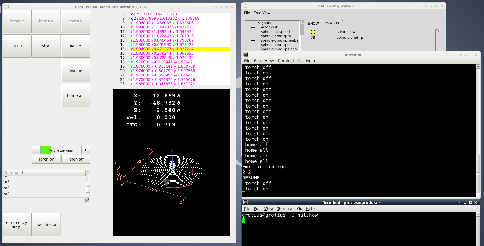

10 Mar 2018 20:49 - 10 Mar 2018 21:27 #107195 by Grotius
@Project update,
Related to the 4 question's yesterday, i solved question 1 and question 2 :
Question 1.
When i simulate a g-code and press pause the machine stops moving. Okey at that moment i want to simulate a torch or spindle restart.
This is not possible when in auto mode. Is there a tiny trick to make this possible. I also try this in the axis program. Result is the same.
Question 2.
When i change color's to the speedcontrol widget for example red to green, when program is running i sometimes get a error : Bad drawable pixmap.... It describes also there is a program bug.
Also the speedcontrol widget update is different from hal value when pressing.
I solved this problem by adding a secundairy update sequence. I would say the python code of speedcontrol.py should do this for you.
Solution question 1 and question 2 :
When you want to restart the torch or spindle in running program, it only works in pause.
To my confusing you cannot do a M3 mdi command. This is not working. I don't know why?
I tried this also in axis, it has the same issue. In Gmocappy the plasma torch start is working, but this is not done
with m3 command. So for simple user's a m3 command in pause mode would be a great thing to realise in my opinion.
I would prefer also to integrate the m4 and m5 macro the same time.
In my tiny program i get this working by adding the following code :
def on_torch_on_pressed(self, widget, data=None):
    print " torch on "
    self.c.spindle( 1, self.widgets.power.get_value())
    self.widgets.power.set_property("color", gtk.gdk.Color("#5dff00"))
    x = self.widgets.power.get_value()
    self.widgets.power.set_value(x+0)
  def on_torch_off_pressed(self, widget, data=None):
    print " torch off "
    self.c.spindle( 1, 0 )
    self.widgets.power.set_property("color", gtk.gdk.Color("#ff2e00"))
In above example, the spindle speed or in my case plasma power is the value of the speedcontrol widget. " self.widgets.power.get_value() " Also when torch is on, speedcontrol widget is turning green. When torch is off,
speedcontrol widget color is turning red. To update the color of the widget i have to do a extra update code wich is basically empty,
but nessecery. I would think there is some code missing in the speedcontrol.py code.
The speedconrol.py update code for changing colors :
[/code]
It only set's a unchanged value. But color's are changing.
Within this program i get no errors about :
So this is also good news. This errors where at the ubuntu version. But now i am on linuxcnc cd with all updates working.
Complete program included :
File Attachment:
File Name: archive.tar.gz
File Size:5 KB
Okey now i added the homing all function in Python code.
In glade i added a button with the handler : on_home_all_pressed
So i glade i don't use the home mdi widget anymore. For inexperienced users, glade with the standard
widget's are great to start with. You don't have to explore difficult code.
Normally you can do for all axis the factor : -1
But somehow this is not working.
def on_home_all_pressed(self, widget, data=None):
    print " home all "
    self.c.home(-1)
To solve this issue do separate axis homing, this goes good, multiple homing also good :
    print " home all "
    self.c.home(0)
    self.c.home(1)
    self.c.home(2)
This is very nice.
Last edit: 10 Mar 2018 21:27 by Grotius.

Okey screen now looks like this :
For this tiny program you can type in terminal : halshow
Then you can see if your programmed value's are reality.
I am thinking about what to investegate next....
