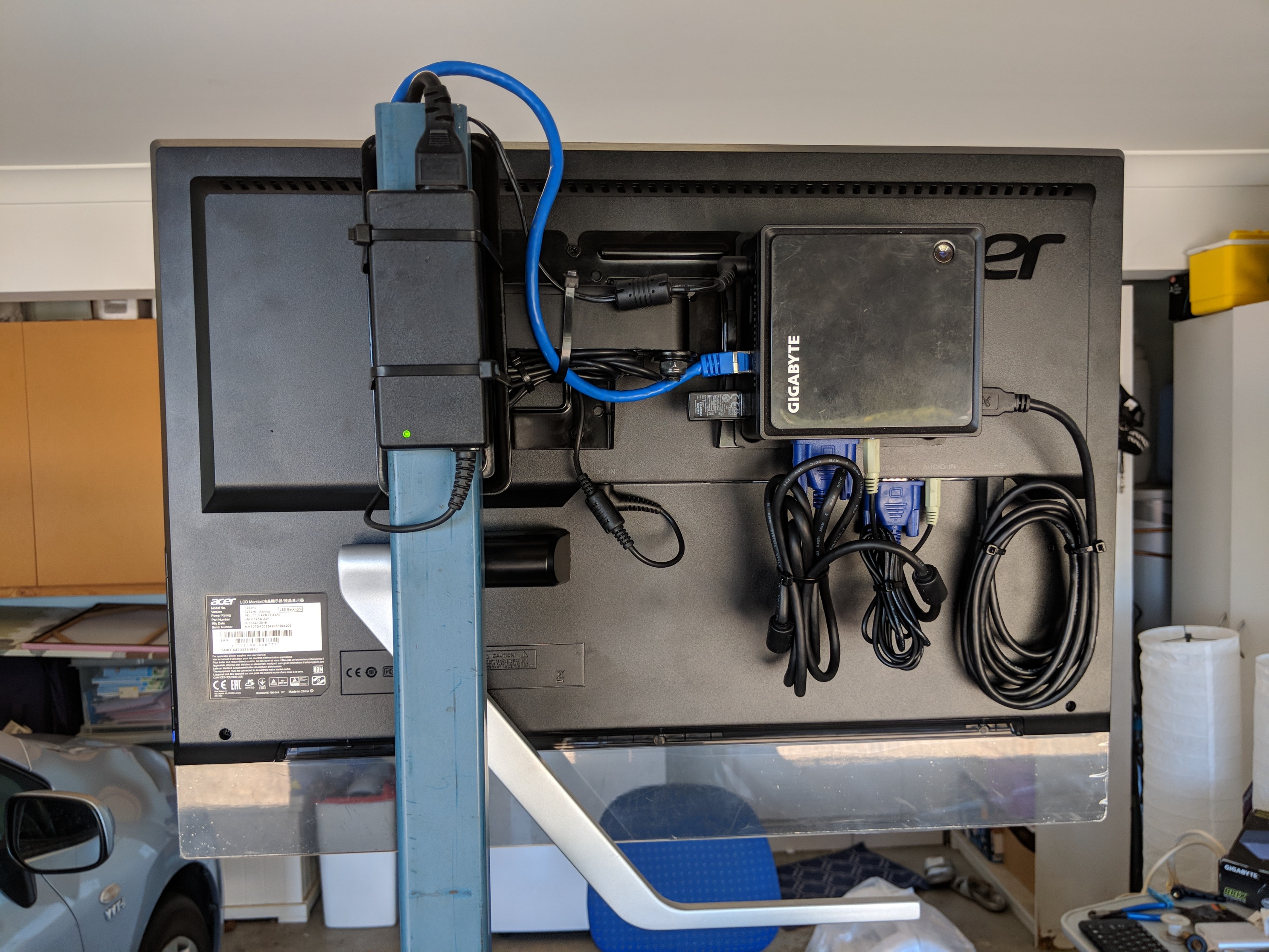

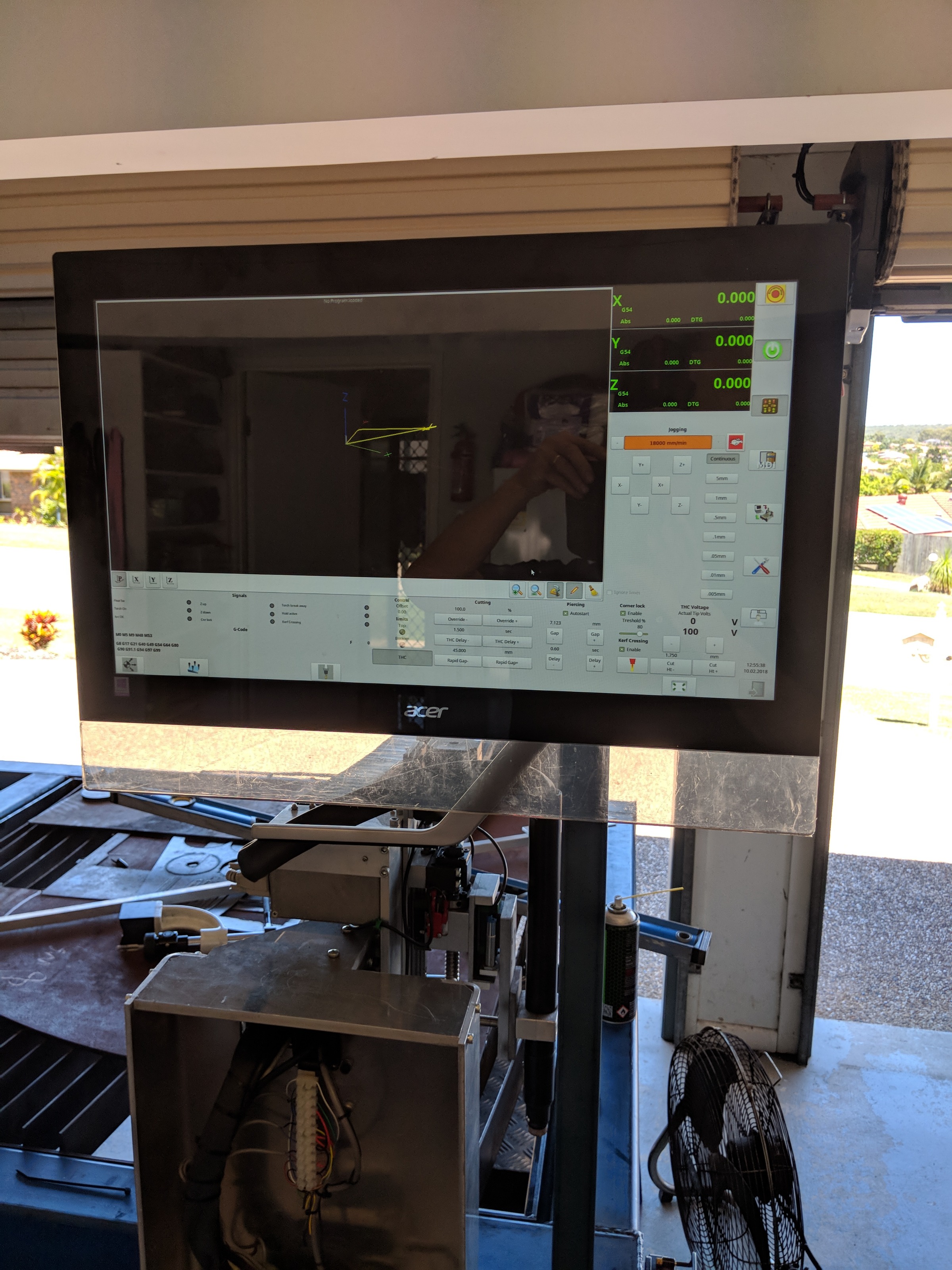

Still off topic but I did a bit of tidying up today and here is why I like the Mesa 7i76e and Gmocappy (with Linux onboard keyboard).
The touch screen and the Ethernet connection to the control box makes for a very tidy install as I just needed to get the ethernet cable and power for the monitor and PC up the support post.

Excuse me for my late responce. Your pc set up including touch screen looks very compact. Nice.
This looks up to date. Okey i have a little idea for your screen.

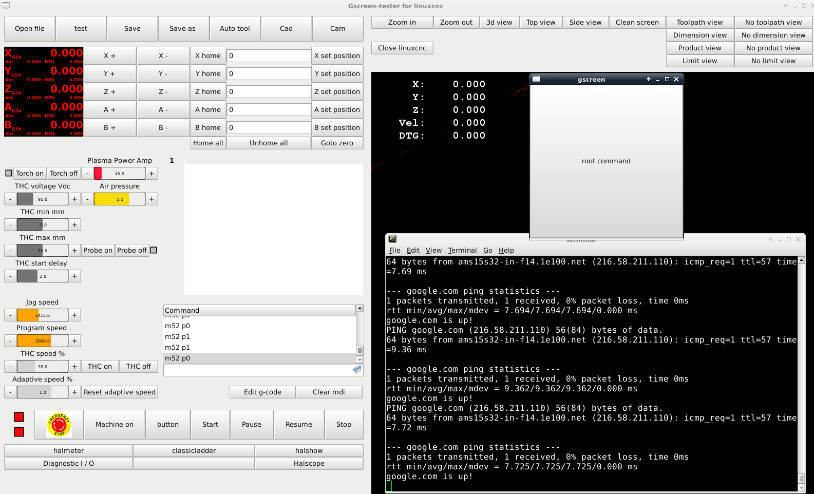

I have done much work to my screen. What i want to know is how to open or activate a secudairy glade screen with a button in the same project. Can be a file close window or whatever.
Okey this is solved :
def on_test_pressed(self, widget, data=None):
        self.widgets.window2.show()
        print " test pressed "

For fun i thought how fast can i ping to google with real time kernel using root command and a button in linuxcnc :
def on_root_command_pressed(self, widget, data=None):
         while True:
               hostname = "google.com" #example
               response = os.system("ping -c 1 " + hostname)
               if response == 0:
                  print hostname, 'is up!'
               else:
                  print hostname, 'is down!'
               time.sleep(0)
This thing is running at 0-1 ms.
It's really fun to know how things are working and what you can do with a linuxcnc controller.
Many thanks for the M68 commando.
I can manipulate g-code now, but i cannot do a M68 command in auto mode.
Hmm, there is a solution, bit i have to think.
You see also window2 pop up if you press the test button.
If you press then root command, it will do a ping. I did also loading a webbrowser, but this placed in a glade window
takes more time. This can be handy for see the M or G commando list
I think the M3 command can be solved in the custom.hal file, but i will look to solve it in a .comp file. For real time
you can compile it just like the THCUD file is a compiled file. I have done this before.
The endless loop funcion also works :

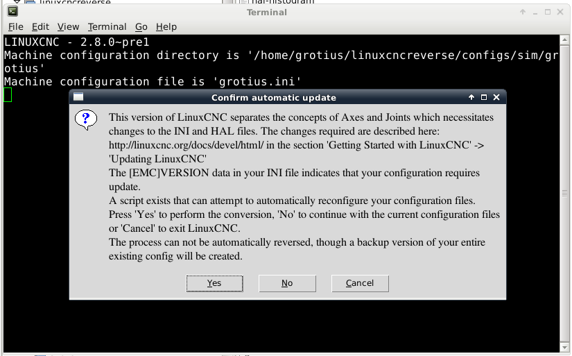

At this moment i have the old grotius gui updated and working sinds 5 minutes.
So finally i have a stand alone appliction working.
I was lucky i had the directory structure good in one time, with placing the files at the good place in the system.
When loading the old linux version i get this picture :
So i did yes.
And to my surprice is was giving messages on the terminal during startup.
For those who also want to update, i had 2 major issue's to solve :
1. The stand alone gremlin from the jt-tutorial was not working, so i deleted all this in the code. And add a glade gremlin widget.
2. Change code, important is to use linuxcnc in code, then most of errors will be gone. :

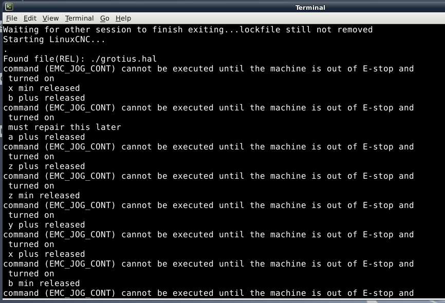

I have now the program stand alone running. Only strange startup message is :
How is it possible to release some buttons during startup procedure ?
Still the joint mode is a problem. Multiple homing command's are not possible.
I need a python text to set the axis in joint mode.
But for the rest, it seems to work good.
