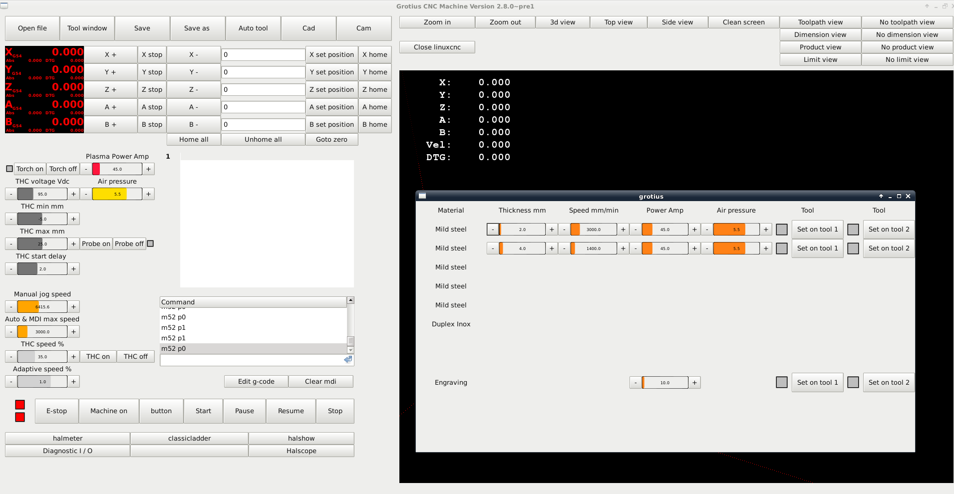

14 Feb 2018 01:30 - 14 Feb 2018 01:39 #105848 by Grotius
@Update:
Hi have started a test to add some plasma tool settings to a list that will be converted / uploaded / or configured into the gcode file.
So that can be handy for users that want to have a easy set up when they don't have the required plasma experience.
I will just expand the input section and will take a try to get this functional in python.
You can press the button Tool window. Then there pop up's a secondairy tool window.
In this window the settings will be a big list, users can click a setting for actual job.
So i think this will be handy.
Please don't look at the main window. This is far from finished. I must first take time for functionallity.

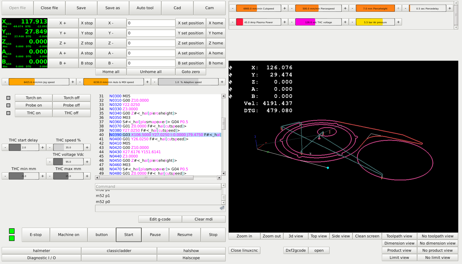

17 Feb 2018 21:37 - 17 Feb 2018 22:10 #106099 by Grotius
@Project update :
Okey i have tried dxf2gcode several times, also looked into the source code. For small files it go's guite good.
If i have a dxf around 800kb or 1mb, it's a problem for dxf2gcode to load. Also is has problem's to make output code.
In terminal i see error code related to postprocessor.
Then i changed the standard linux plasma sheetcam postprocessor. It is now completely set with variable g-code output to my linux screen selected plasma tool. I see i forgot the piercedelay time in the gcode. This works perfect ! Only problem is that the kerf width cannot be a variable g-code output so far as i know.
Okey now i am going to investegate a dxf to g-code python code for circle holes. It was posted here on the forum in the past.
I wonder if i can bring this code down to minimum requirements for glade and python. After that expand this code into a complete dxf to g-code conversion in fast speed output.
Problem after that is the inner and outher contour ofsett's and lead in's. But i wil give it a try.
The python file is named dxf2holes.py see also attachment.
It is a good example how to filter dxf files and save them as g-code.
It is the first step to cam program. This program is bases on Tkinker (graphic's), so i will make a basic dxf to gcode
integrated in the linuxcnc program. A nice widget to execute external python programs in linuxcnc is to add :
#in top section of program
import runpy
#in loop section of program
runpy.run_path("/home/grotius/linuxcncreverse/nc_files/holecircle.py")
I used upper trick with dxf2gcode. It was openening, loading dxf file, making output g-code in linuxcnc without seeing the dxf2gcode program itself.

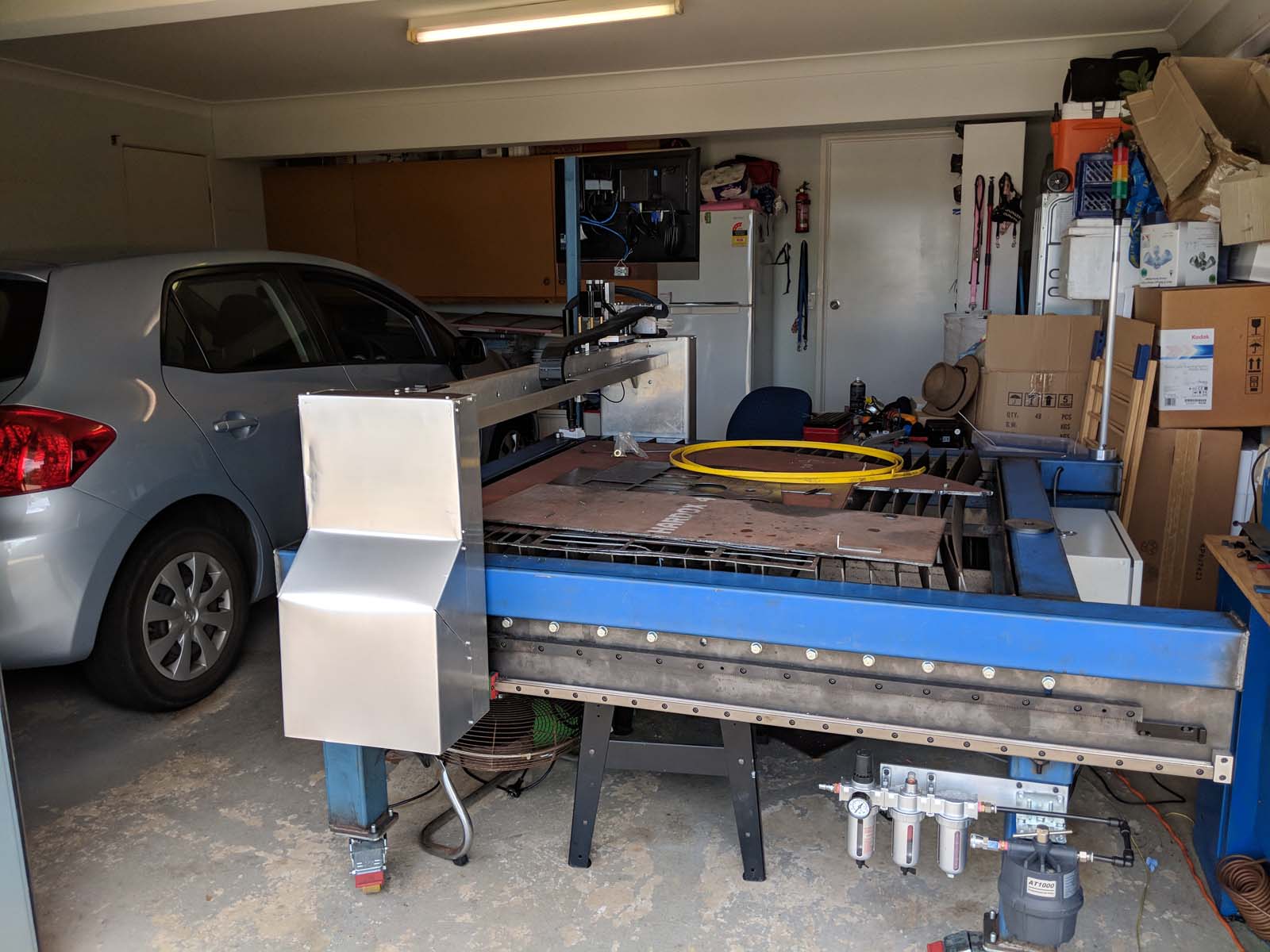

23 Feb 2018 22:47 - 23 Feb 2018 23:32 #106417 by Grotius
@Rodw,
Thanks for the pic's. Is your wife happy with plasma in the garage?
The gantry cover is alway's difficult to design and to produce. You did a quite good job !

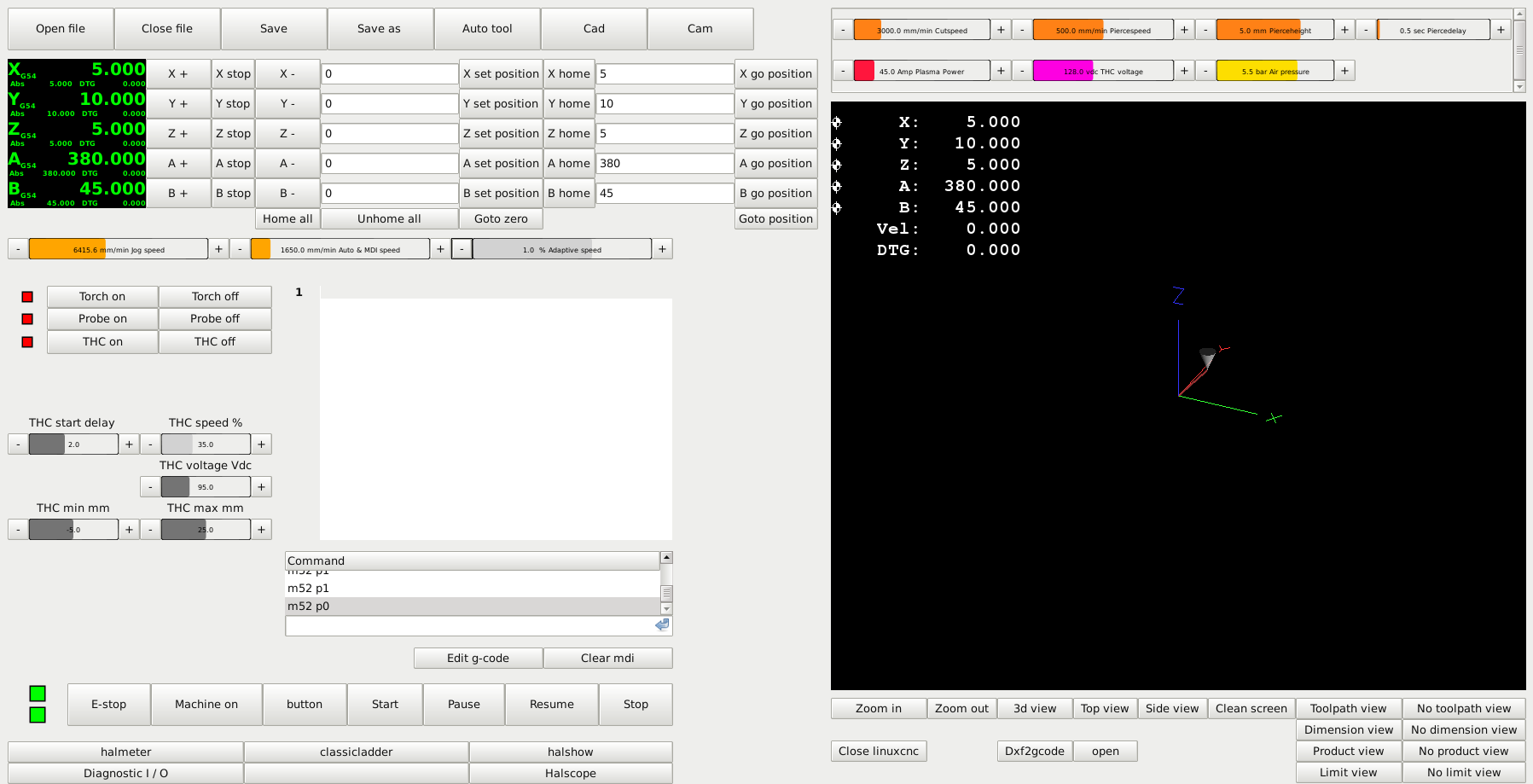

@project update :
Tonight i made a python code for moving the machine in a position over 5 axis based on the speed value of the screen speed mdi widget. So i think this is nice.
I first had a tuple error in terminal startup. So i was searching for tuple and python code on google.
The code looks quite simple after all, i had to solve this with a + sign.
def on_b_go_position_pressed(self, widget, data=None):
        self.entry1 = self.widgets.b_go_label
        self.x = float(self.entry1.get_text())
        self.command.mode(linuxcnc.MODE_MDI)
        self.command.wait_complete()
        #this is a tuple example, see http://www.linuxtopia.org/online_books/programming_books/python_programming/python_ch13s03.html
        command = "G01 B{0}".format(self.x) + "F{0}".format(self.widgets.program_speed.get_value())
        self.command.mdi(command)
        print " goto position "
    def on_goto_xyzab_position_pressed(self, widget, data=None):
        self.entry1 = self.widgets.x_go_label
        self.entry2 = self.widgets.y_go_label
        self.entry3 = self.widgets.z_go_label
        self.entry4 = self.widgets.a_go_label
        self.entry5 = self.widgets.b_go_label
        self.y = float(self.entry2.get_text())
        self.z = float(self.entry3.get_text())
        self.a = float(self.entry4.get_text())
        self.b = float(self.entry5.get_text())
        command = "G01 X{0}".format(self.x) + "Y{0}".format(self.y) + "Z{0}".format(self.z) + "A{0}".format(self.a) + "B{0}".format(self.b) + "F{0}".format(self.widgets.program_speed.get_value())
        print " goto xyzab position "
The code is for 5 separate axis button's to move in a textbox entered position and for all axis entered position.
Advantage is if i expand this with a plasma start macro, you can cut steel in different shapes, except circular trough only distance input's. It's the beginning of a paramatric shape library.
Last edit: 23 Feb 2018 23:32 by Grotius.
24 Feb 2018 01:57 #106419 by rodw
Not too happy and one of the reasons I want to finish it off is to make more room.
Thanks for the comments about the cover and downdraft. I have grooved ally plate before with a circular saw to bend it. I will probably remake the cover and get someone to fold it properly. Its only 1.6mm aluminium so my tiny little pan brake folds it OK, but it is just 100 mm too short to do the job properly. I have not had much time to do any more to my machine.

09 Mar 2018 19:25 #107168 by Grotius
@Project update,
I have now some experience with the touch screen and Ubuntu.
At this moment i have to solve a few item's in my custom screen design and python code.
I have a 4 question's at the moment.
Question 1.
When i simulate a g-code and press pause the machine stops moving. Okey at that moment i want to simulate a torch or spindle restart.
This is not possible when in auto mode. Is there a tiny trick to make this possible. I also try this in the axis program. Result is the same.
Question 2.
When i change color's to the speedcontrol widget for example red to green, when program is running i sometimes get a error : Bad drawable pixmap.... It describes also there is a program bug.
Also the speedcontrol widget update is different from hal value when pressing.
I solved this problem by adding a secundairy update sequence. I would say the python code of speedcontrol.py should do this for you.
Question 3.
A python code for converting dxf to gcode for files over 1mb. And the theory about how the inner and outher offset's are progammed in pyton.
Question 4.
How to start up linuxcnc in terminal with ubuntu? This i will also google.
