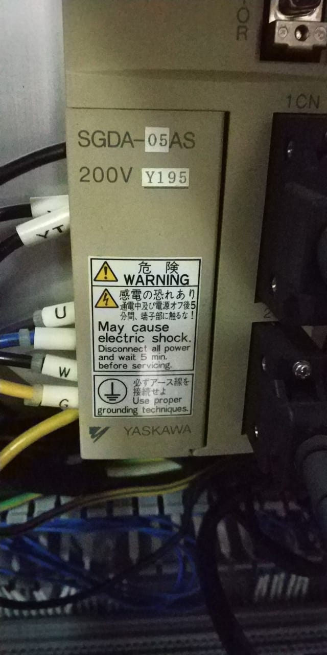

Thanks Tommylight . I am going through posts.
What you think about retaining Analogue Drives . In your experience will they give trouble later.
- Posts: 21887
- Thank you received: 7461
06 Apr 2020 10:29 #162882
Replied by tommylight on topic hurco hawk 30 retrofit
If you read that topic you will see that i had trouble with the original drives, they failed one by one so had to change them all.
Pity as the Yaskawa drives are very good and tuning the original drives took 5 minutes total for the two working axis.

These drives are hardly used . Ill take a chance
Hawk -30 is a basic machine.The machine don't have an ATC , has manual speed change for spindle..
From my study I got the idea as below..
MESA card with 4 Analogue channels need to be selected.(7i33 ?)
just need ~ 20 I/o for PLC (Do I need additional card for this?).
I noticed you are using lot of cards "7i92, 7i77, 7i74, 7i70, 7i71 and maybe another 7i84 and 7i73 for pendant". Why is that?.
Sorry.. too may questions . I am a mechanical engineer.
If you have a wiring diagram it will be very helpful.
