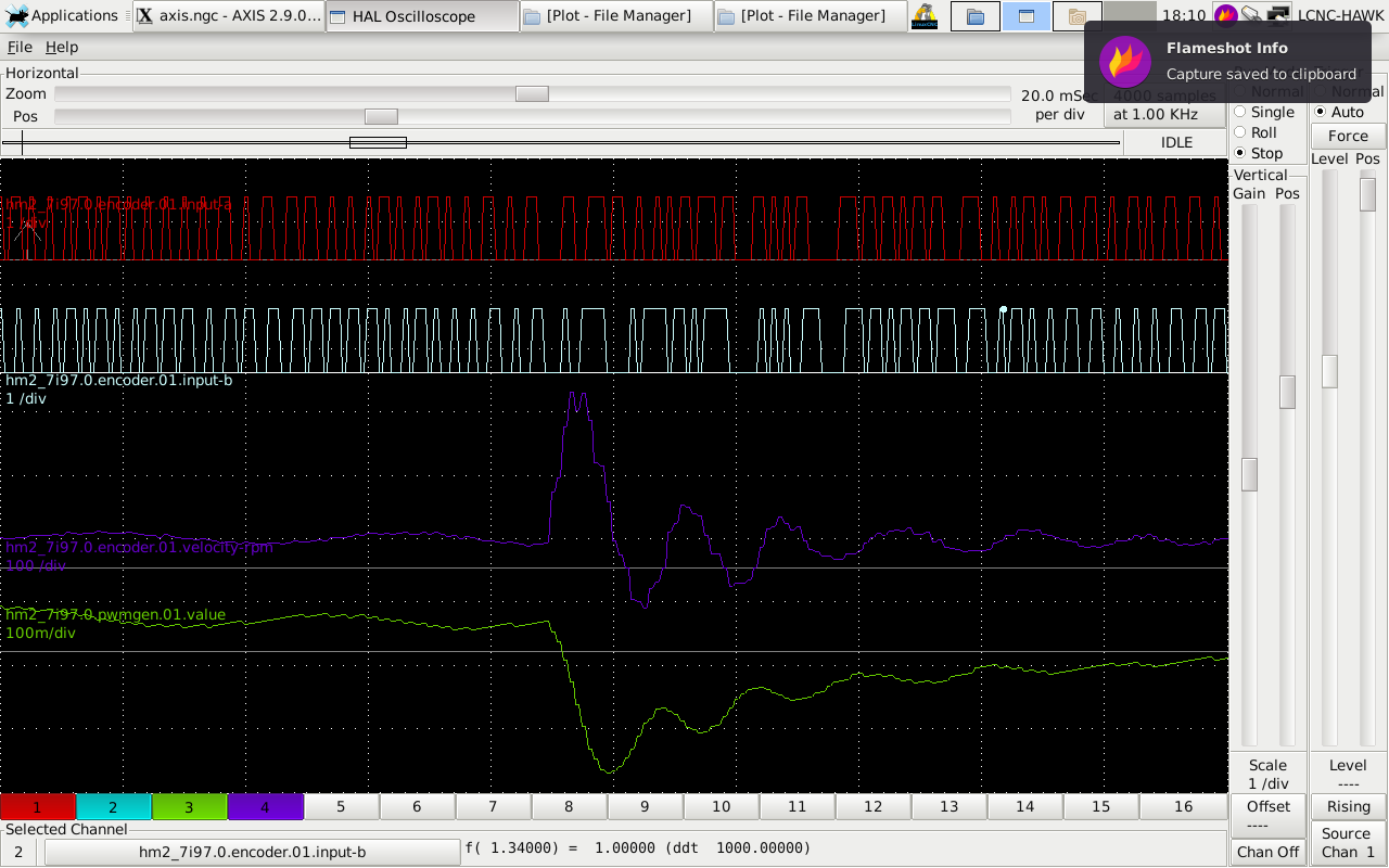

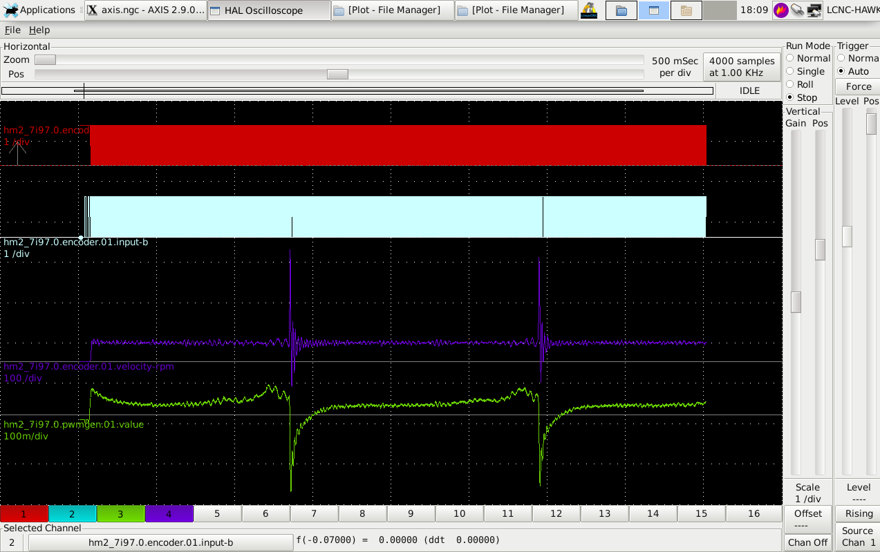

HI All,
I was able to run the machine finally . All axis and spindle are working . But I have an observation on Y and X axis . During Jogging I am finding that axis is jerking . I have taken the Halscope plot . See attached pics for reference
enlarged View
Logs are also attached .
To verify hardware and connections I scoped using oscilloscope . encoder pulsed looks clean . (no gaps or missing pulses .)
Z axis is working OK . Anybody faced this issue before ?. Please guide.
Riaz
enlarged View
Riaz

Do the jerks happen at the same locations?

Replied by NEMARIAZ on topic hurco hawk 30 retrofit
It's repeating in regular intervals throughout travel. I checked ball screw it's free .No catching any where.
- Posts: 18080
- Thank you received: 5316
17 May 2021 16:11 #209238
Replied by PCW on topic hurco hawk 30 retrofit
Linear or rotary encoders?
