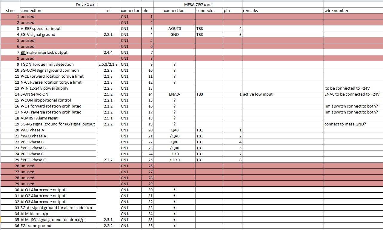

I have started working on this retrofit after a long break . I am doing the circuit diagram now . servo drive is SGDA05AS from yaskawa. and mesa 7i97 is used for retrofit. I have few queries
encoder power and GND connections, below is recommendation from drive
where as mesa card has 5V and ground pin given separately ( i think it is used to power separate encoder).
TB1 PIN FUNCTION DIR
1 QA0 TO 7I97
2 /QA0 TO 7I97
3 GND FROM 7I97
4 QB0 TO 7I97
5 /QB0 TO 7I97
6 +5V FROM 7I97
7 IDX0 TO 7I97
8 /IDX0 TO 7I97
how do I connect in this case?
thanks

- Todd Zuercher
- Posts: 4762
- Thank you received: 1463
27 Aug 2020 18:46 #179718
Replied by Todd Zuercher on topic hurco hawk 30 retrofit
Just as in the diagram you posted above.
You simply don't connect the +5v
TB1 PIN => SERVOPAC CN1
1 QA0 => CN1-20 PAO
2 /QA0 => CN1-21 /PAO
3 GND => CN1-19 0v
4 QB0 => CN1-22 PBO
5 /QB0 => CN1-23 /PBO
6 +5V nc
7 IDX0 => CN1-24 PCO
8 /IDX0 => CN1-25 /PCO
1 QA0 => CN1-20 PAO
3 GND => CN1-19 0v
4 QB0 => CN1-22 PBO
6 +5V nc

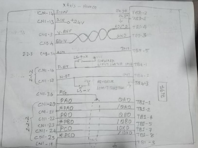

- NEMARIAZ
- Posts: 28
27 Aug 2020 18:52 #179720
by NEMARIAZ
Replied by NEMARIAZ on topic hurco hawk 30 retrofit
Thanks Todd,
- NEMARIAZ
- Posts: 28
27 Aug 2020 18:57 #179721
by NEMARIAZ
- Todd Zuercher
- Posts: 4762
27 Aug 2020 19:36 #179727
That looks like all that is needed. The encoder index (IDX0) signal is optional. It is possible one or more of the alarm signals or the alarm reset might be useful, but not nessisary. Also the rotation prohibit inputs are sometimes connected to hard limit switches but also not nessisary.
