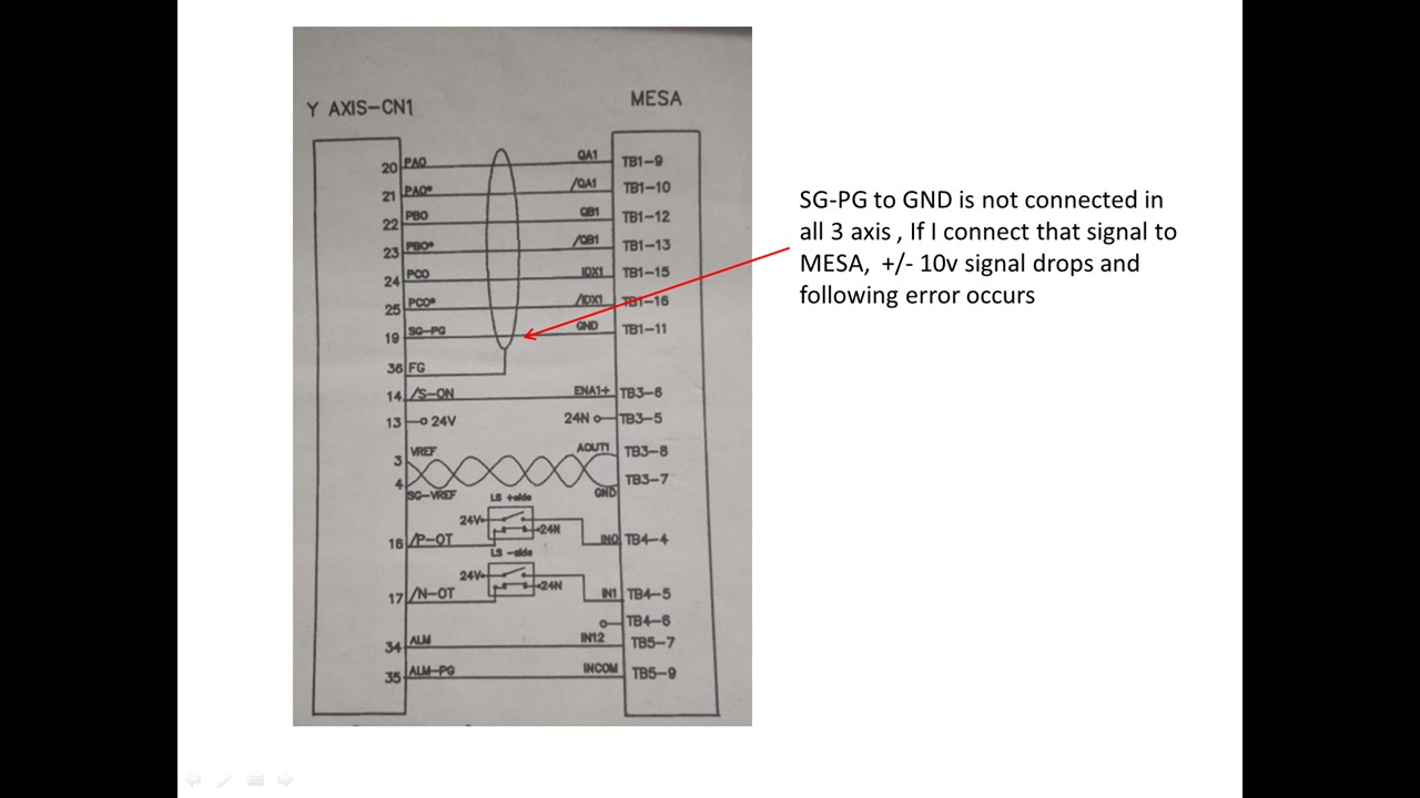

- NEMARIAZ
- Posts: 28
19 May 2021 11:31 - 19 May 2021 12:40 #209484
by NEMARIAZ
Replied by NEMARIAZ on topic hurco hawk 30 retrofit
Hi

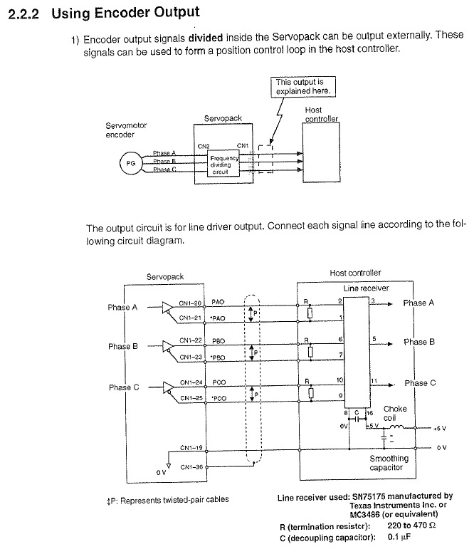

One important information . Encoder ground from Yaskawa drive can not be connected to MESA encoder ground . This connection causes analogue signal to short out . I am not sure Why . So all encoder works without ground from Servo .Can this cause this?.
Any body from MESA here can throw some light.
This is the encoder connection recommendation from Yaskawa
Regards
Riaz
Regards
Riaz
Last edit: 19 May 2021 12:40 by NEMARIAZ.
- Posts: 18080
- Thank you received: 5316
19 May 2021 13:17 #209504
Replied by PCW on topic hurco hawk 30 retrofit
Sounds like you have the 7I77s analog out connected to the drives ground
(input common)
(input common)
- NEMARIAZ
- Posts: 28
19 May 2021 13:42 - 19 May 2021 13:42 #209507
by NEMARIAZ
So shorting happens inside MESA? Card is 7i97
Last edit: 19 May 2021 13:42 by NEMARIAZ.
- Posts: 18080
19 May 2021 13:47 - 19 May 2021 13:55 #209510
Encoder ground and analog are common on the 7I97 (or 7I77)
I suspect you have the 7I97's analog output wired to the drives
input ground (which is also probably common between the
drives encoder output and analog section)
You should be able to verify this with an ohmmeter
Note that if you fix this, you will reverse the current feedback direction
so will need to change the sign of the analog output in hal
Last edit: 19 May 2021 13:55 by PCW.
- NEMARIAZ
- Posts: 28
19 May 2021 15:36 #209521
by NEMARIAZ
That means I need to swap analog signal and ground ..and check?
- Posts: 18080
19 May 2021 16:03 #209526
I would verify how its currently connected (with an Ohmmeter),
that is do the 7I97 AOUT pins connect the the drives input or
encoder grounds?
encoder grounds?
- NEMARIAZ
- Posts: 28
21 May 2021 19:56 #209792
by NEMARIAZ
i interchanged Analogue and GND and checked . no change in situation.
looks like some buffer circuit is required. Any suggestions?.
