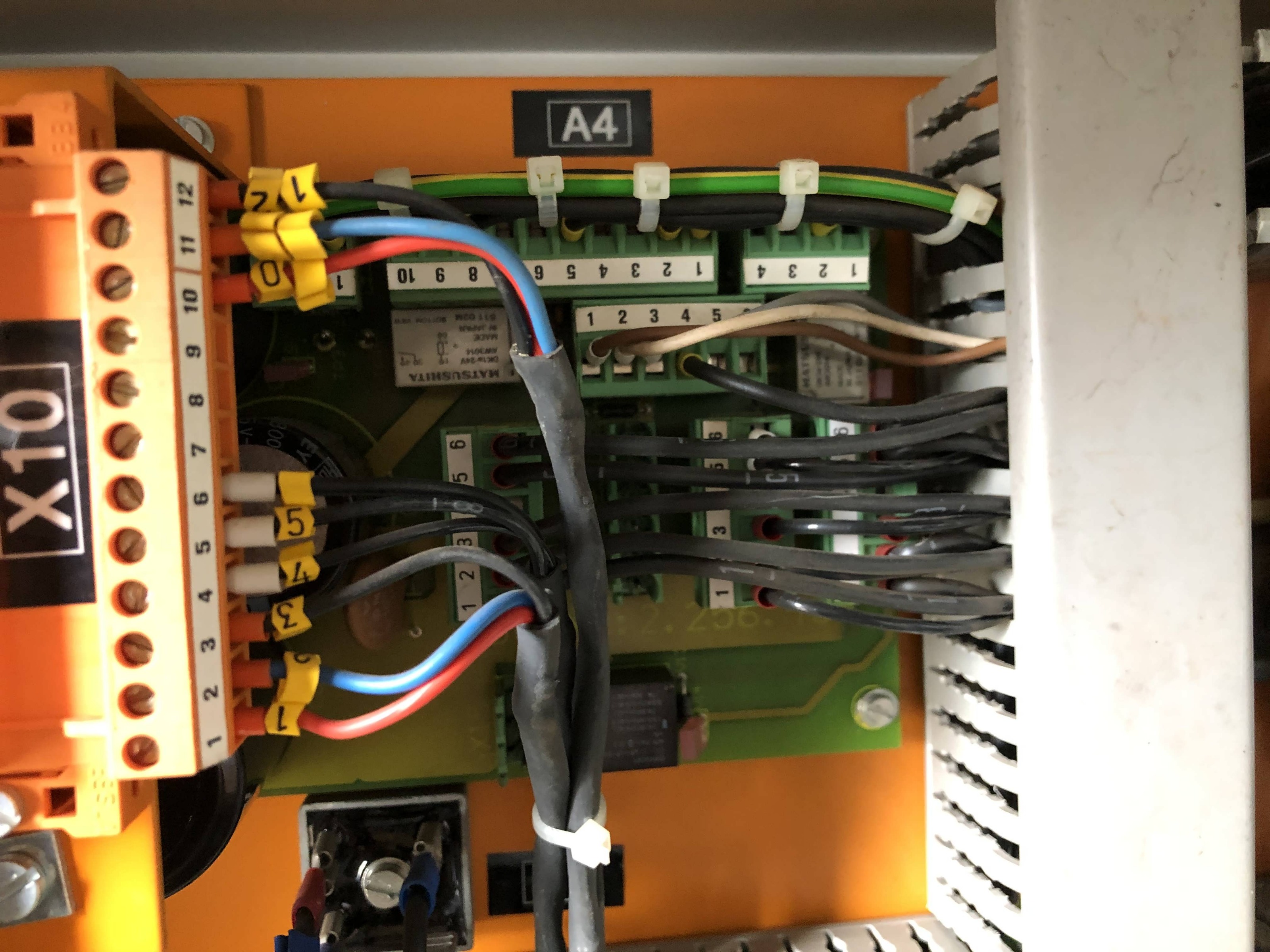

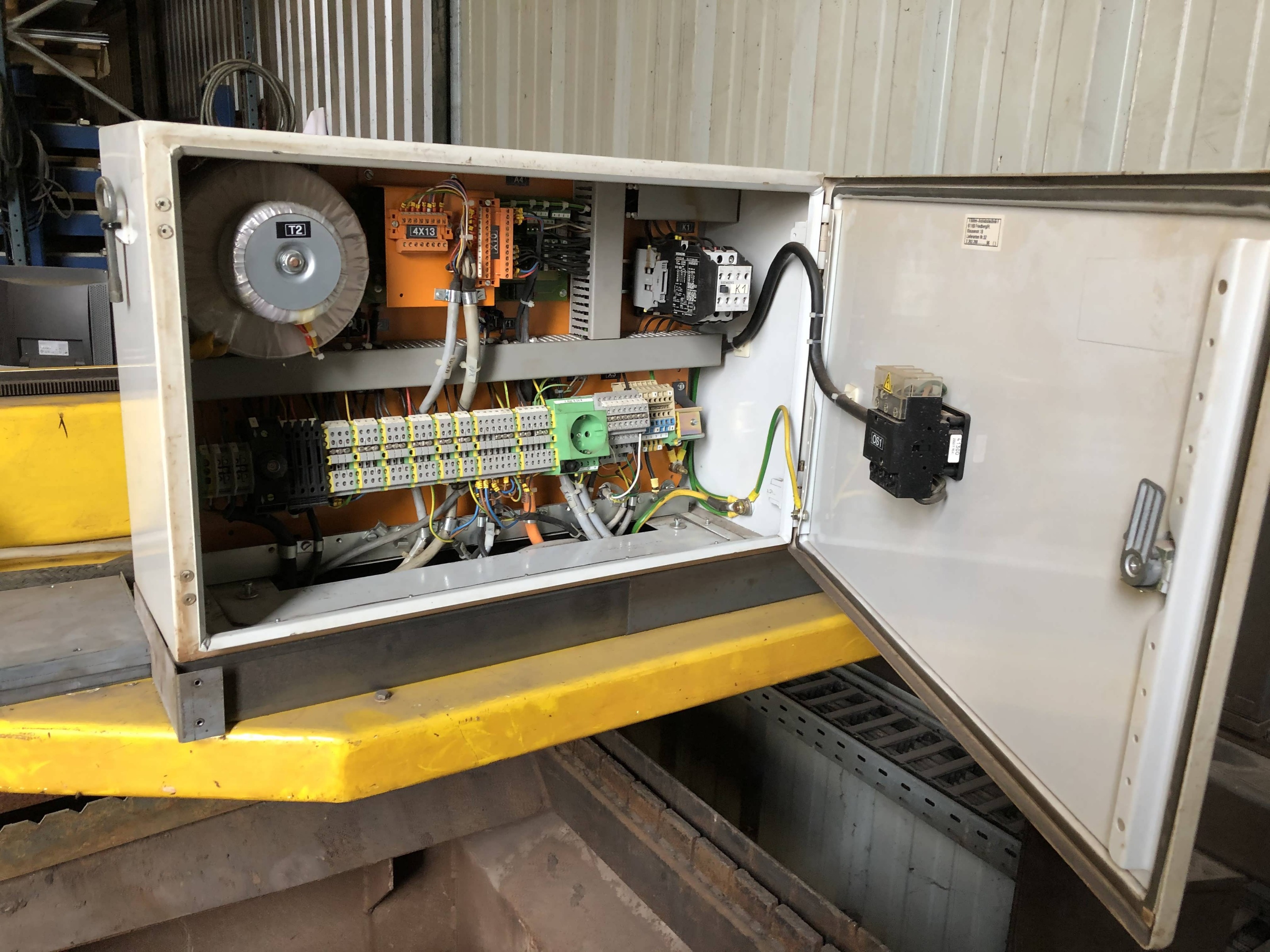

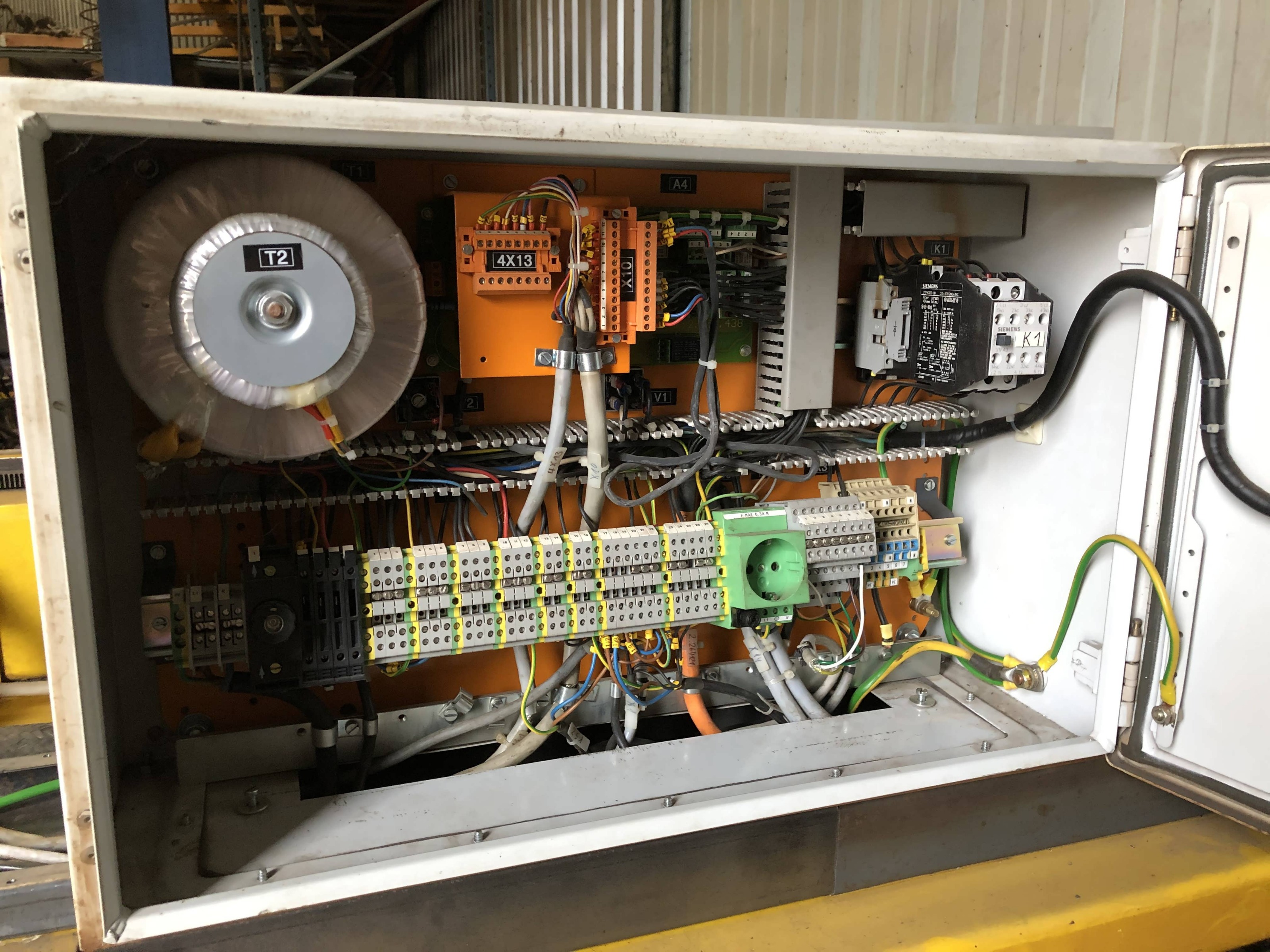

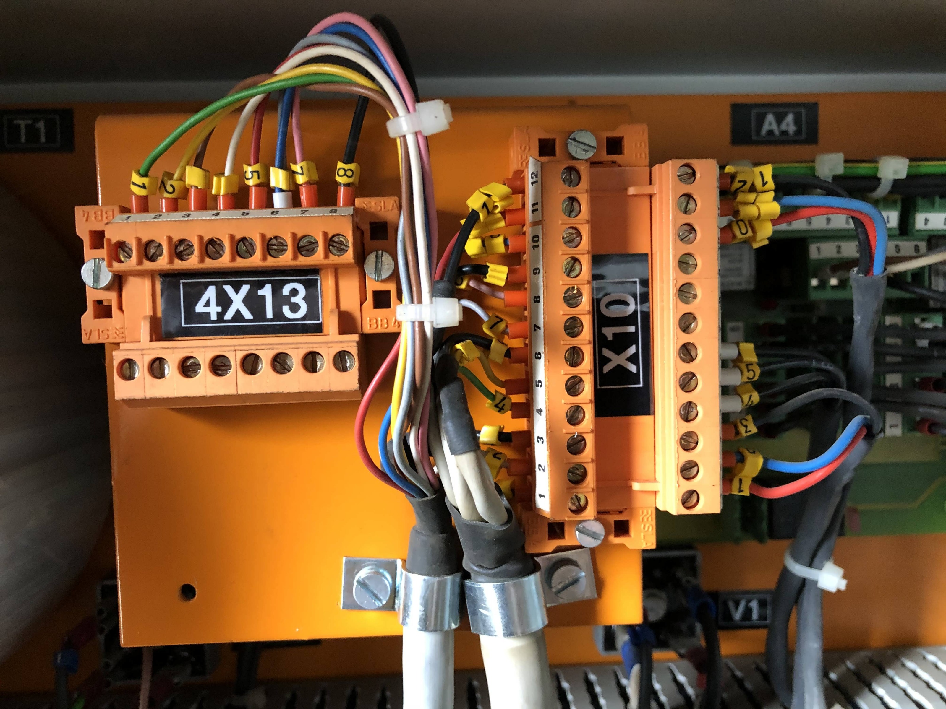

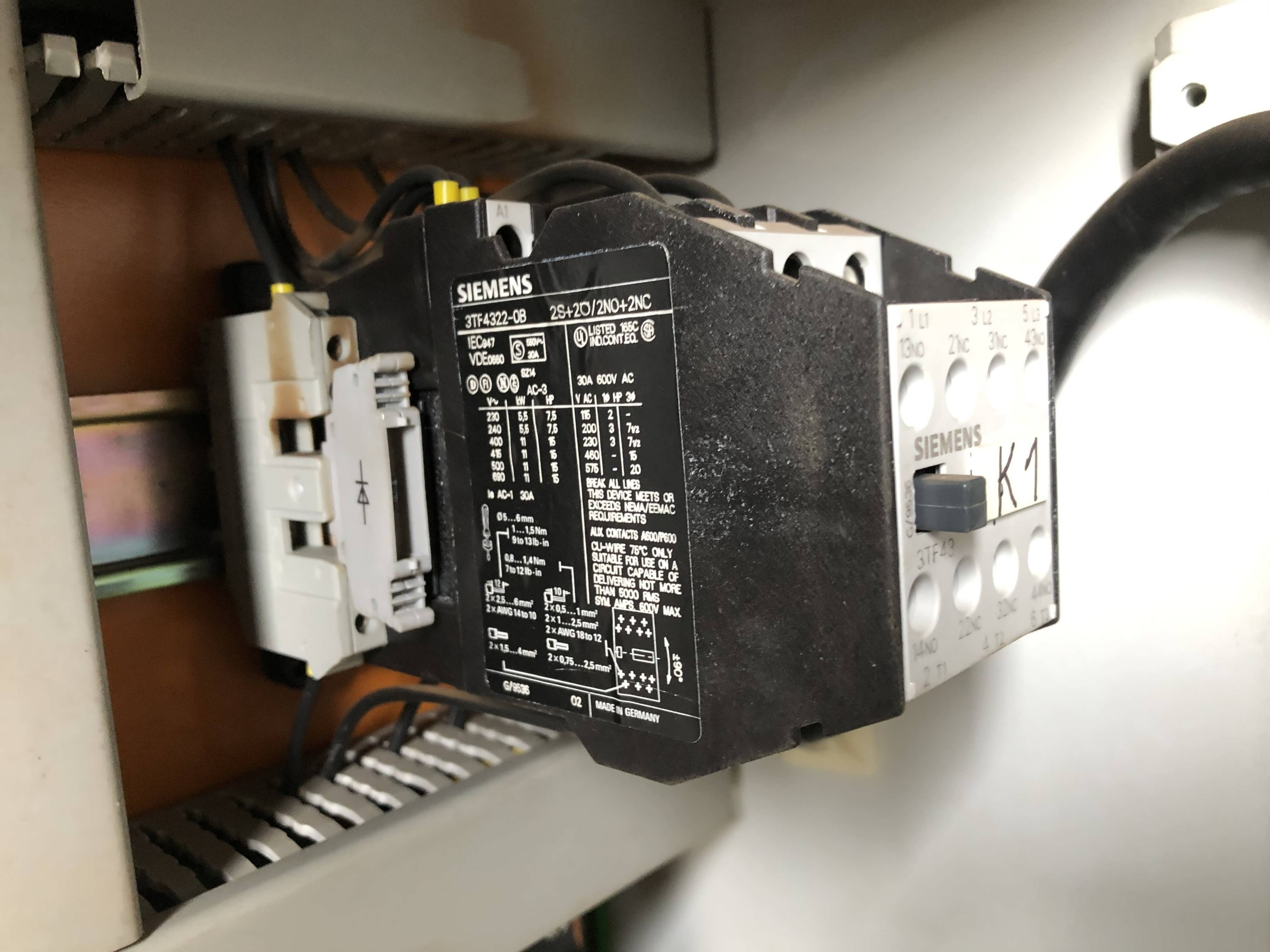

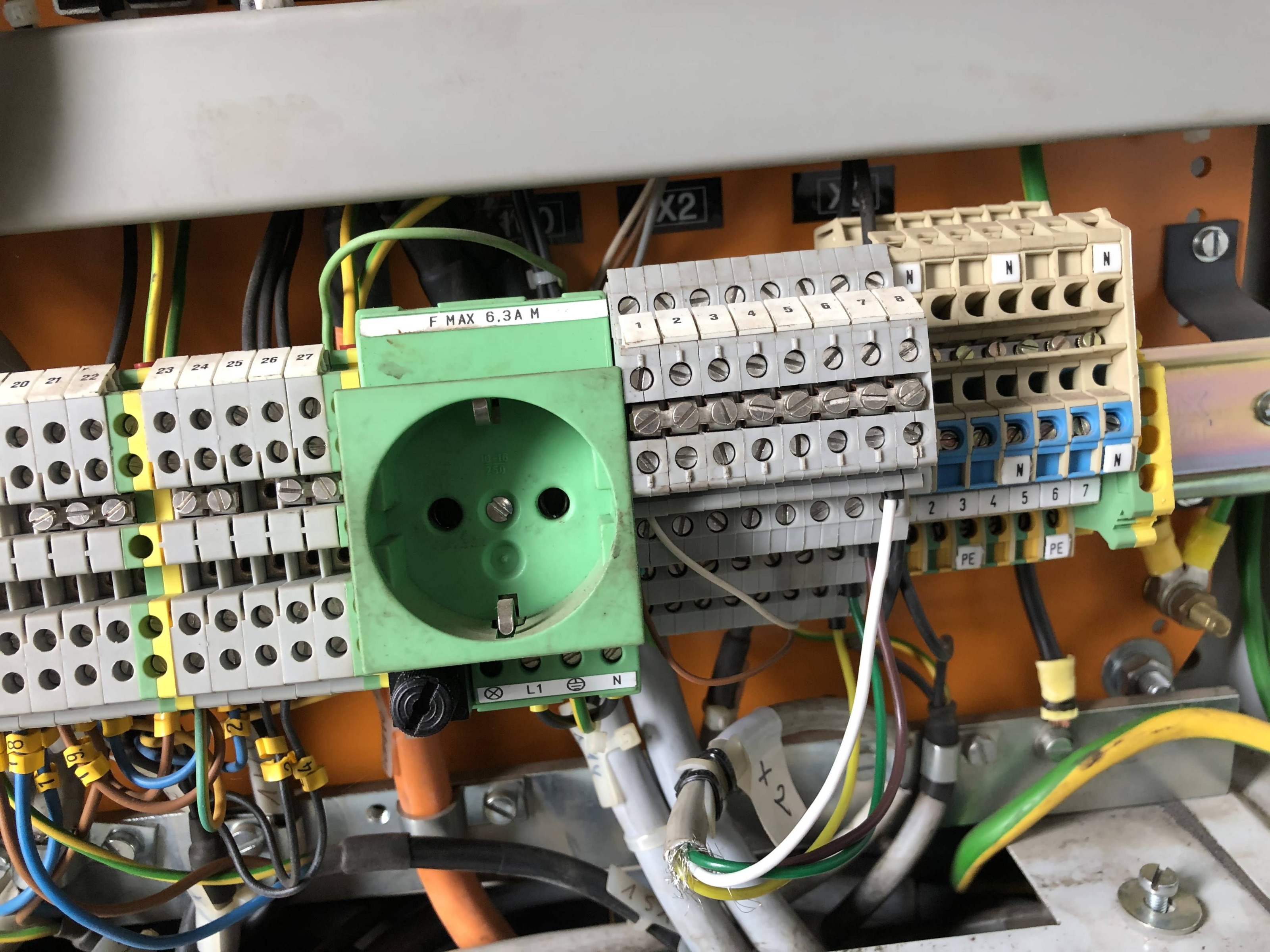

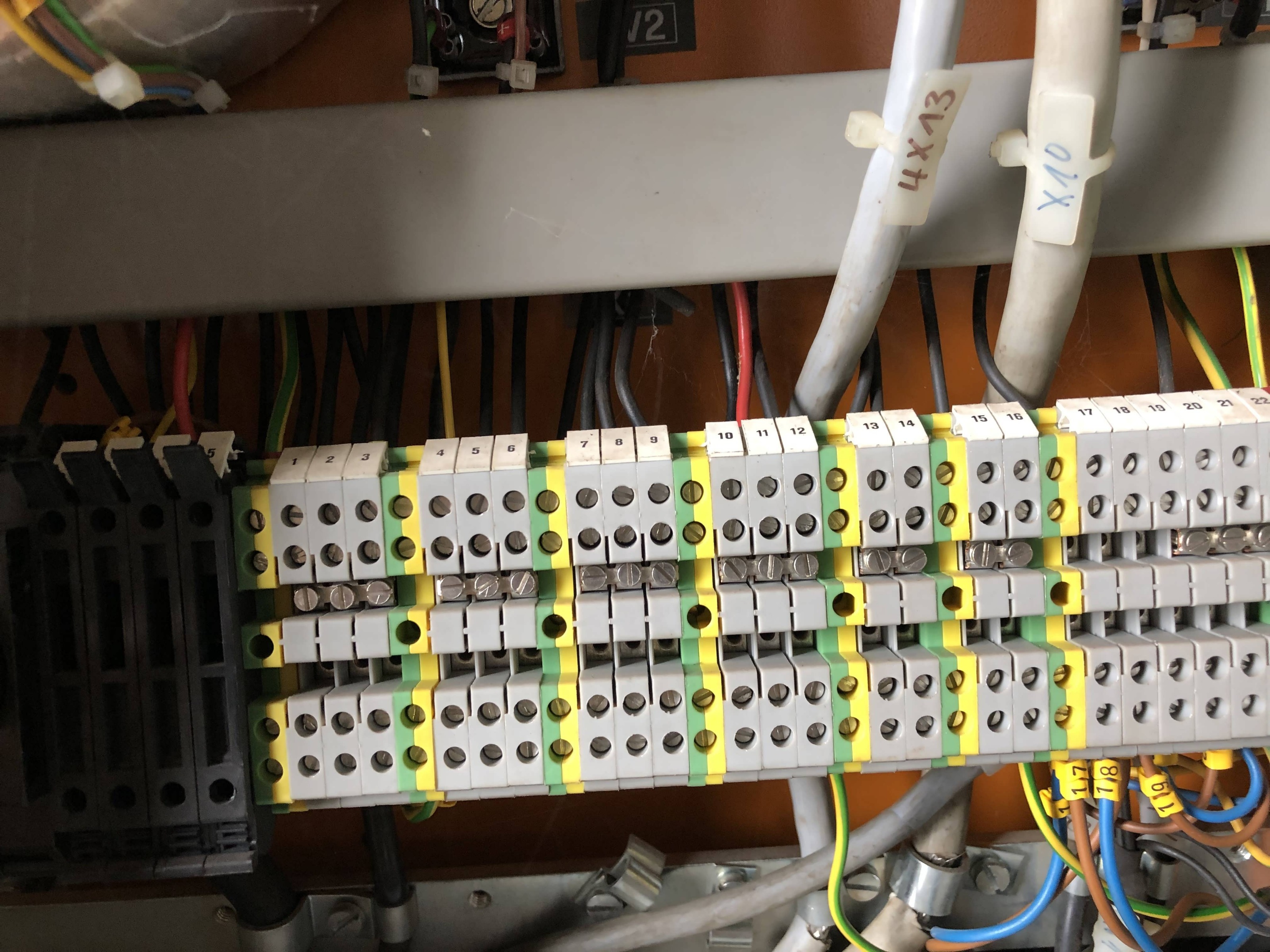

My friend is hunting for the wires. Some of the wires go to the power box then to the control box. We are thinking about putting the mini-atx box and all the cards in this same powerbox as there is enough space to hold all the components there. We can then add just a screen keyboard mouse cables from the power box to the esab control box where we will install the screen.
This will allow us to remove the extra wiring going from this box to the esab control box.
Is this a good idea?
- Posts: 20232
- Thank you received: 6880
27 Jun 2020 17:06 #172879
Replied by tommylight on topic Esab Ultrarex UXD-P2000 Upgrade Project
No wires go to the power box, everything should be installed in the control box.
The only wires that go from control box to the Z axis are 4 motor wires and floating switch wires.
