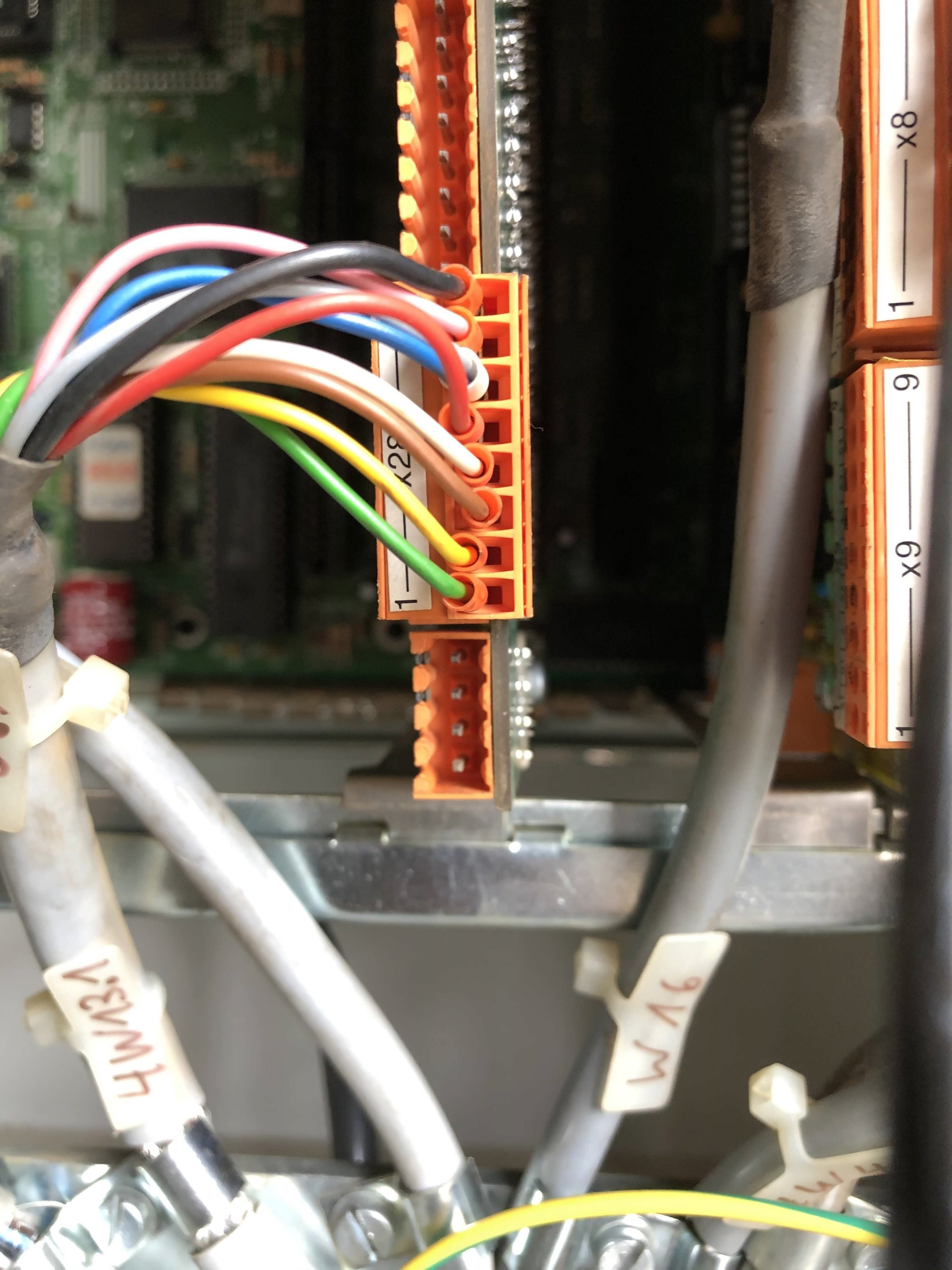

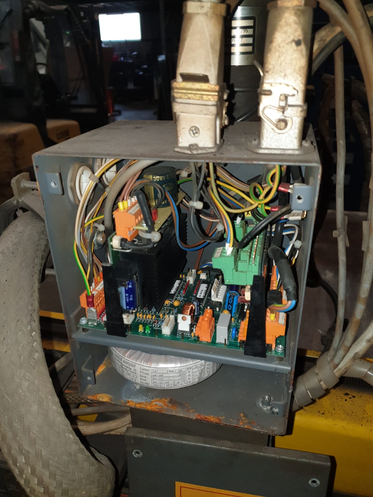

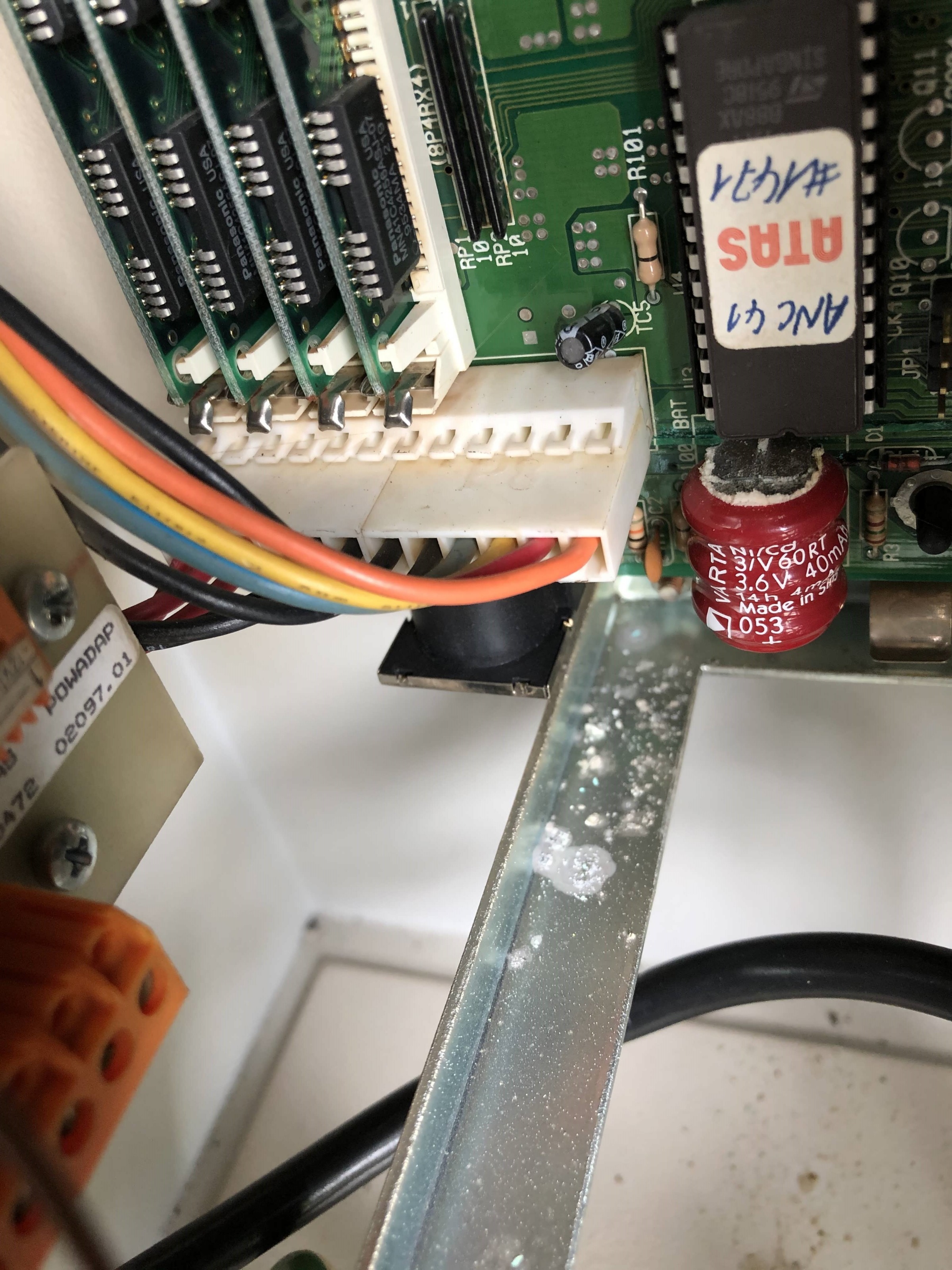

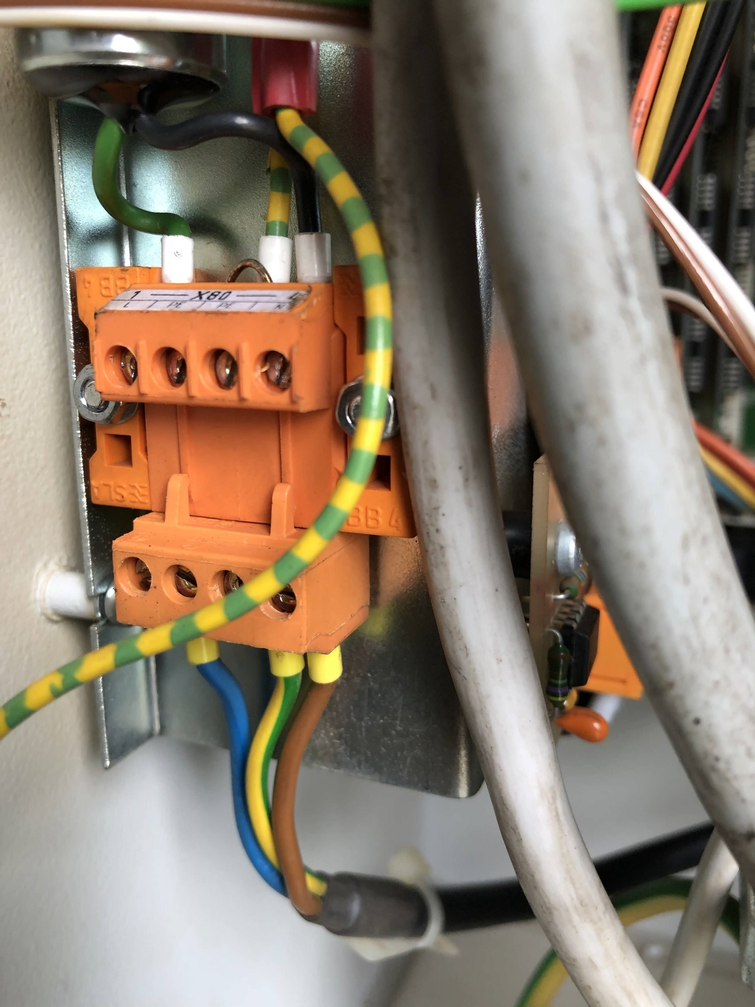

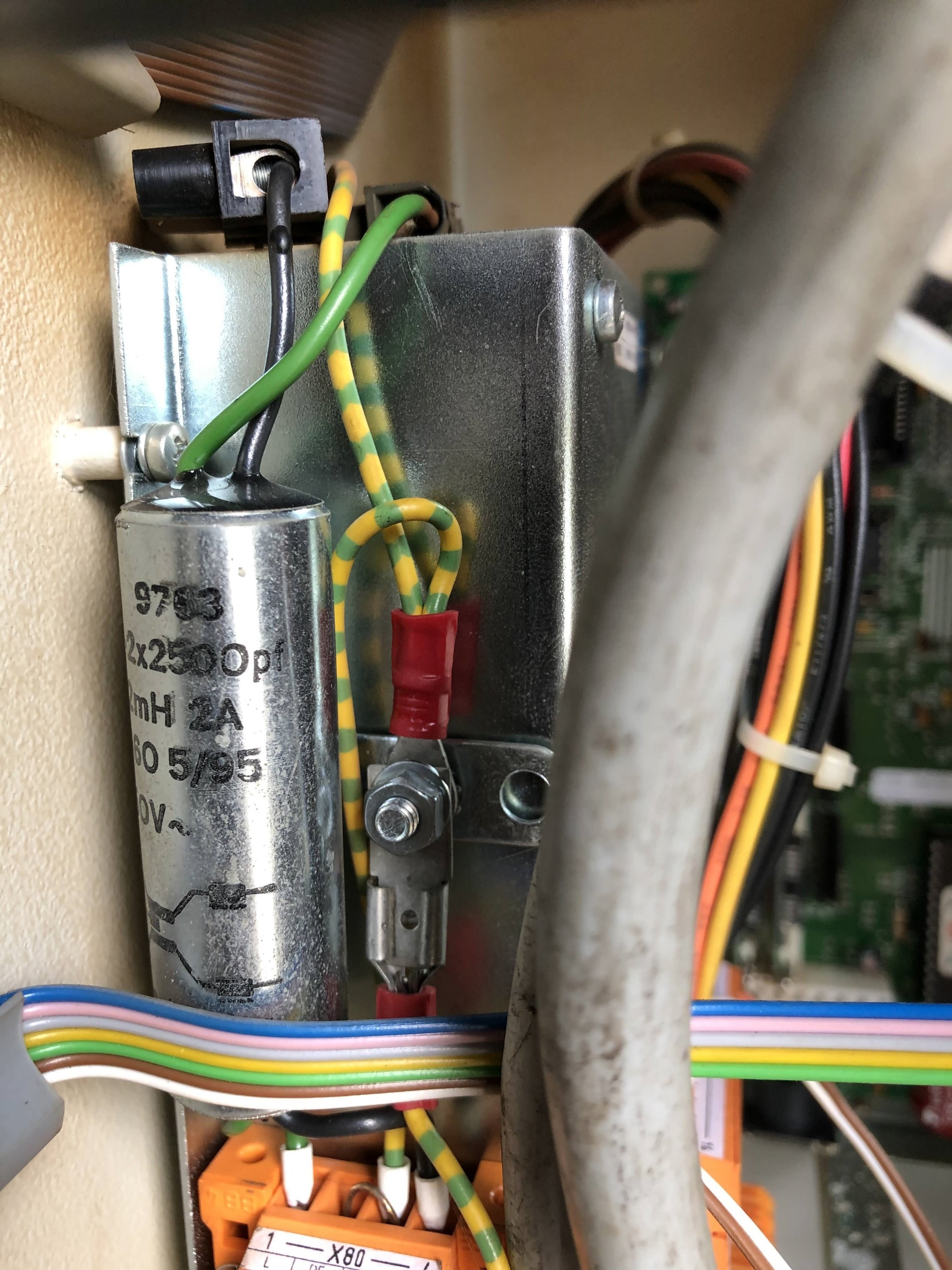

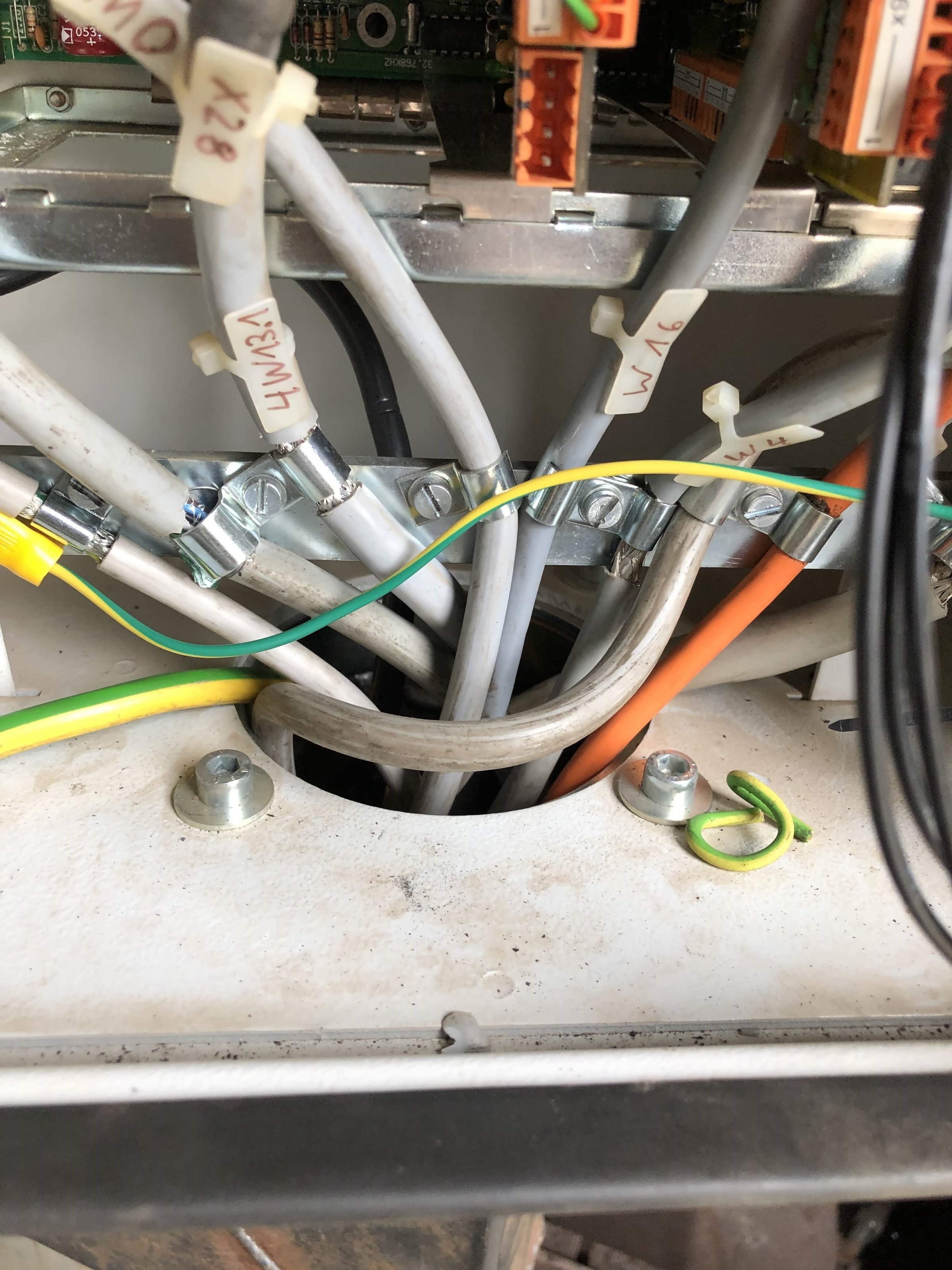

Replied by tommylight on topic Esab Ultrarex UXD-P2000 Upgrade Project
That is the power control box, or power box.
I would not install anything there, to much stuff already.
- Esaber
- Posts: 135
- Thank you received: 15

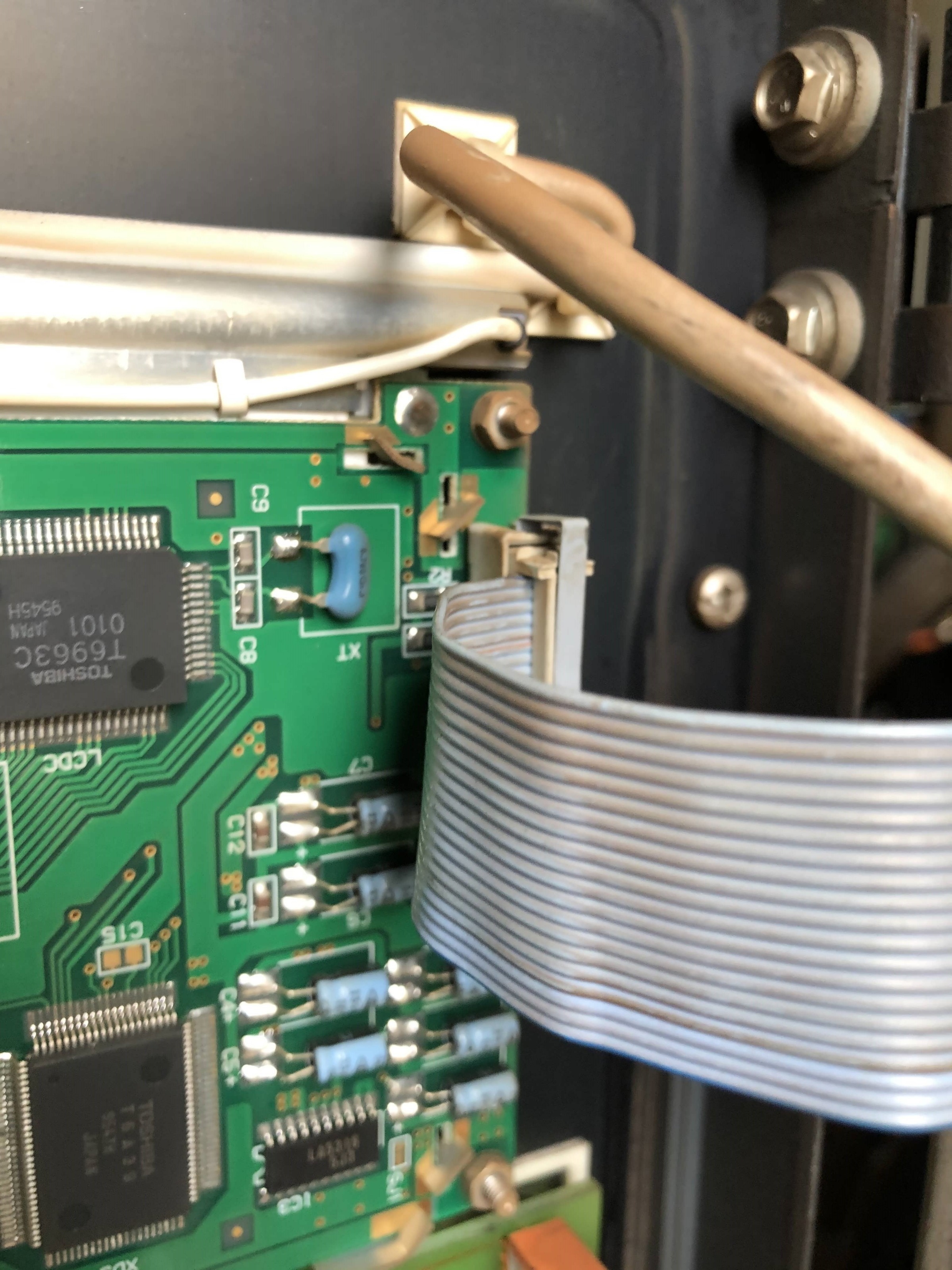

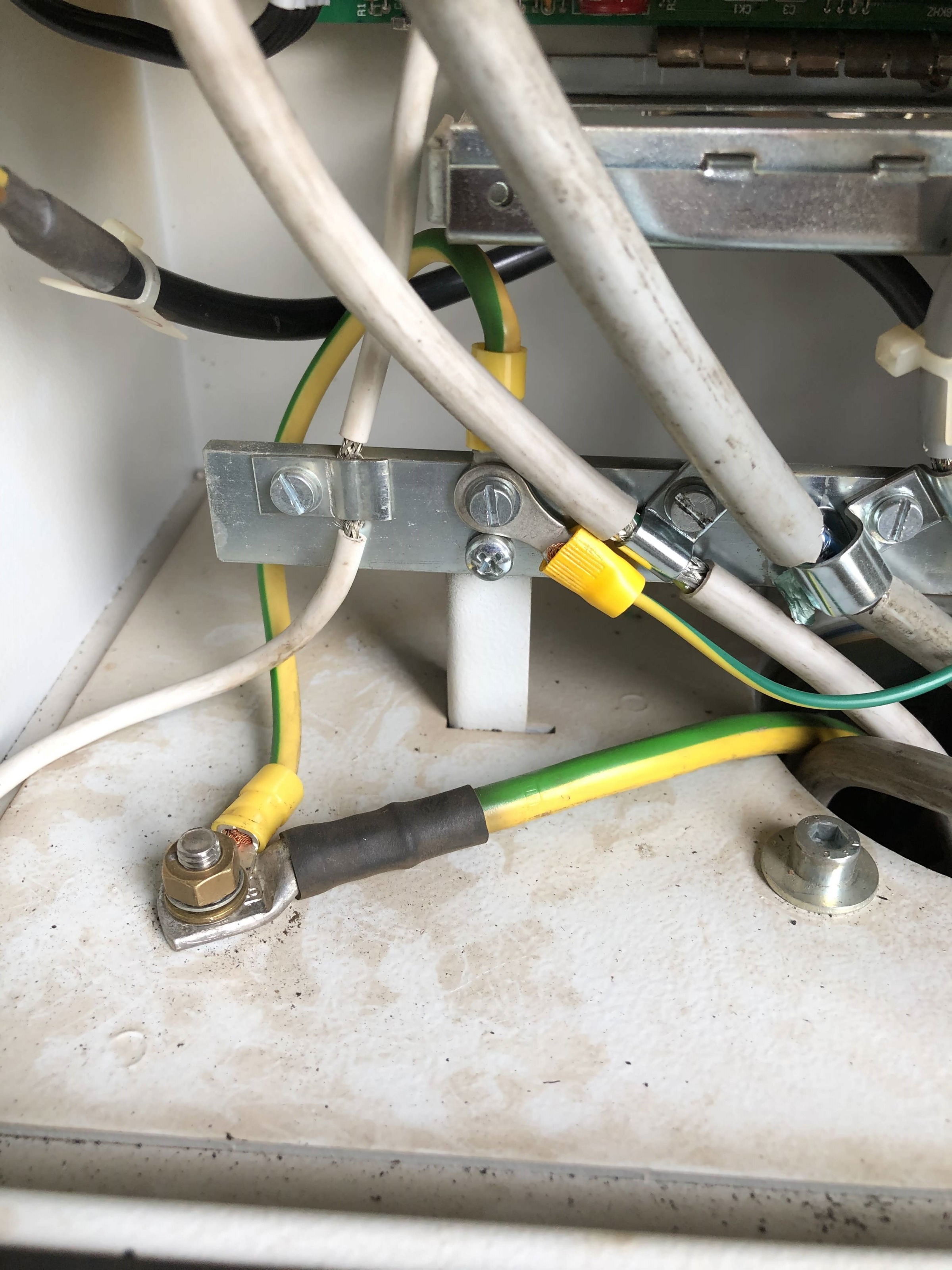

27 Jun 2020 17:37 - 27 Jun 2020 17:40 #172885
by Esaber
Replied by Esaber on topic Esab Ultrarex UXD-P2000 Upgrade Project
OK. We will empty the control box and put the computer and the cards there:
Relays have not been delivered yet.
Last edit: 27 Jun 2020 17:40 by Esaber.

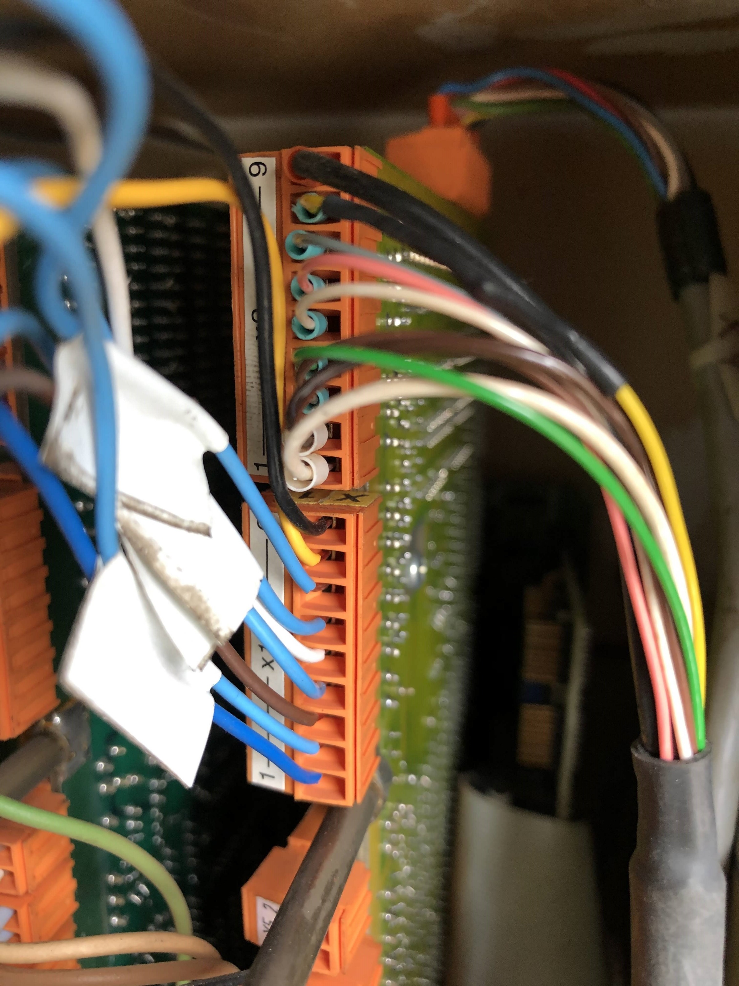

27 Jun 2020 18:43 - 27 Jun 2020 18:45 #172895
by Esaber
Last edit: 27 Jun 2020 18:45 by Esaber.

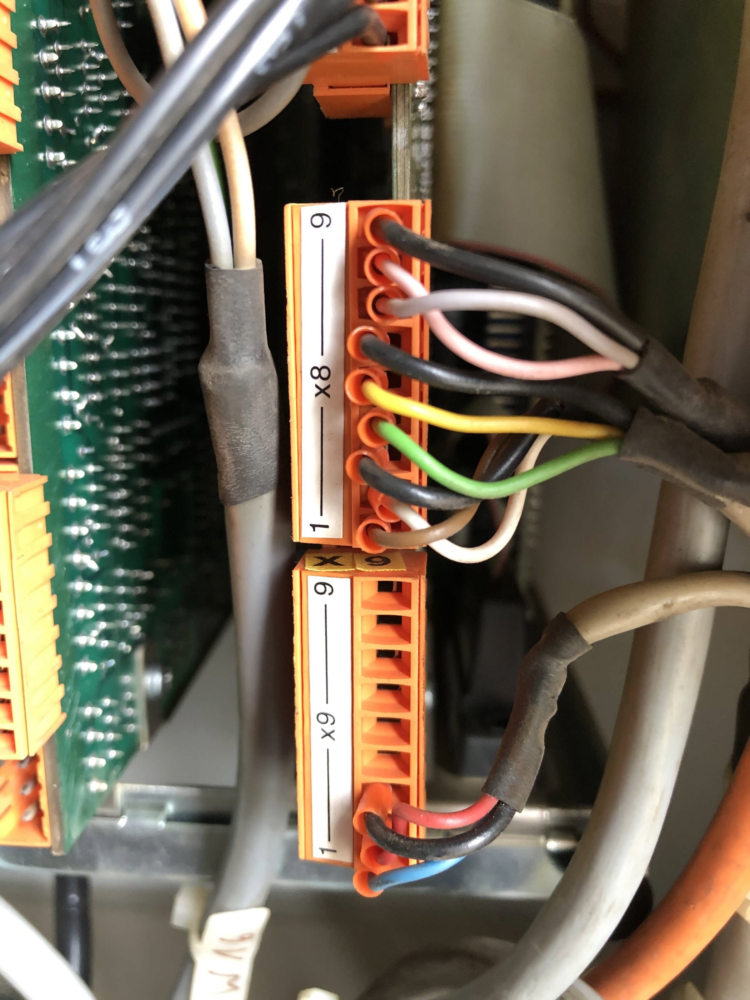

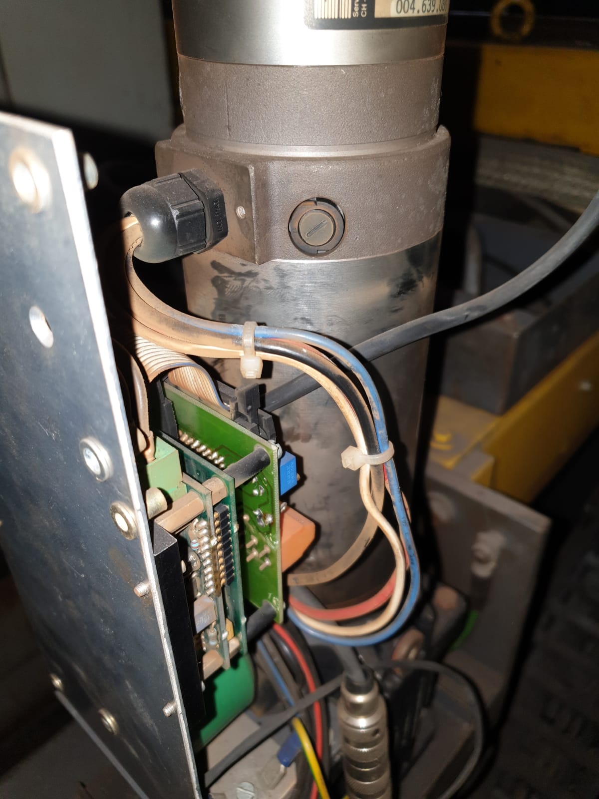

27 Jun 2020 20:05 - 27 Jun 2020 20:16 #172903
by Esaber

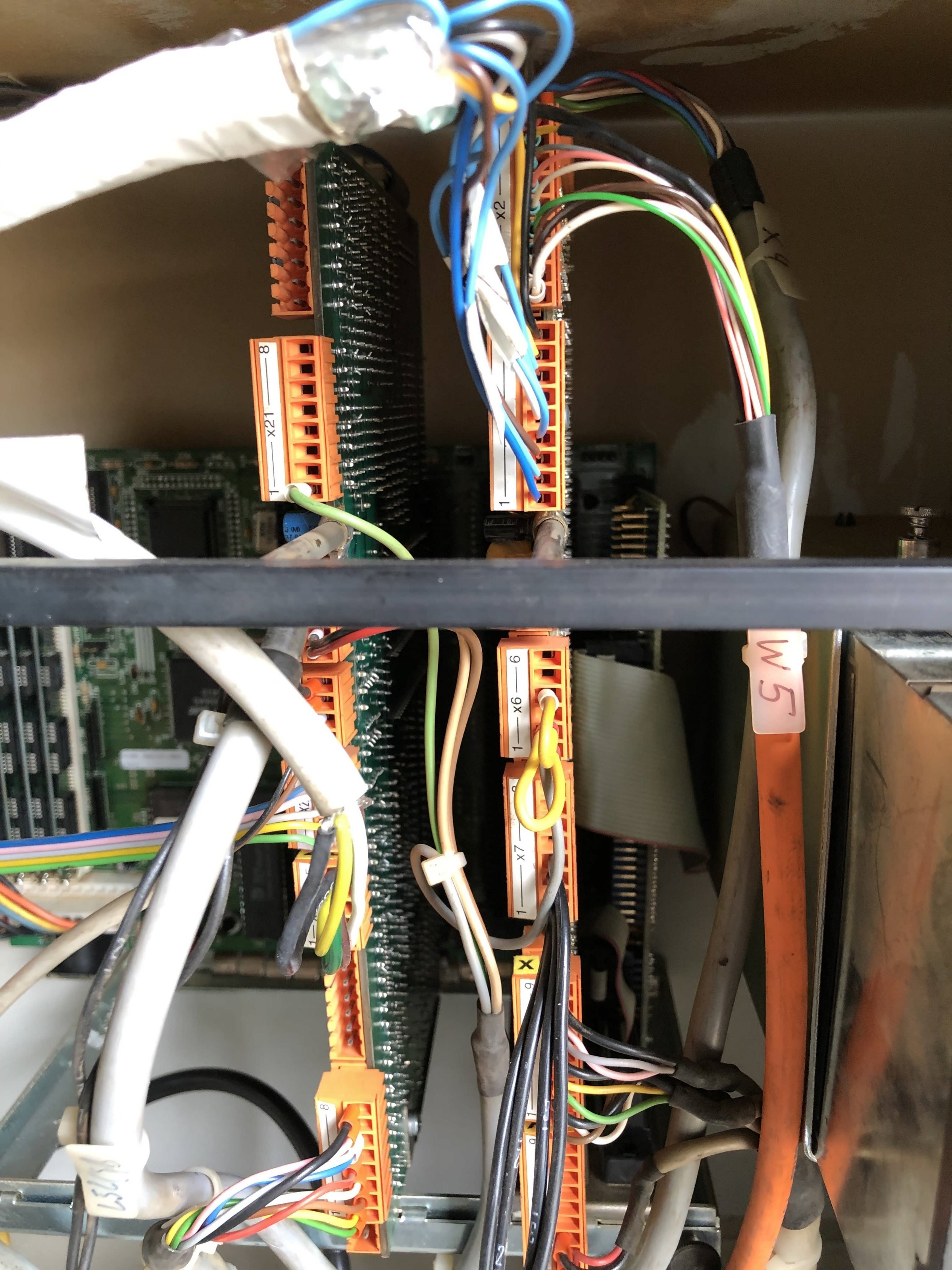

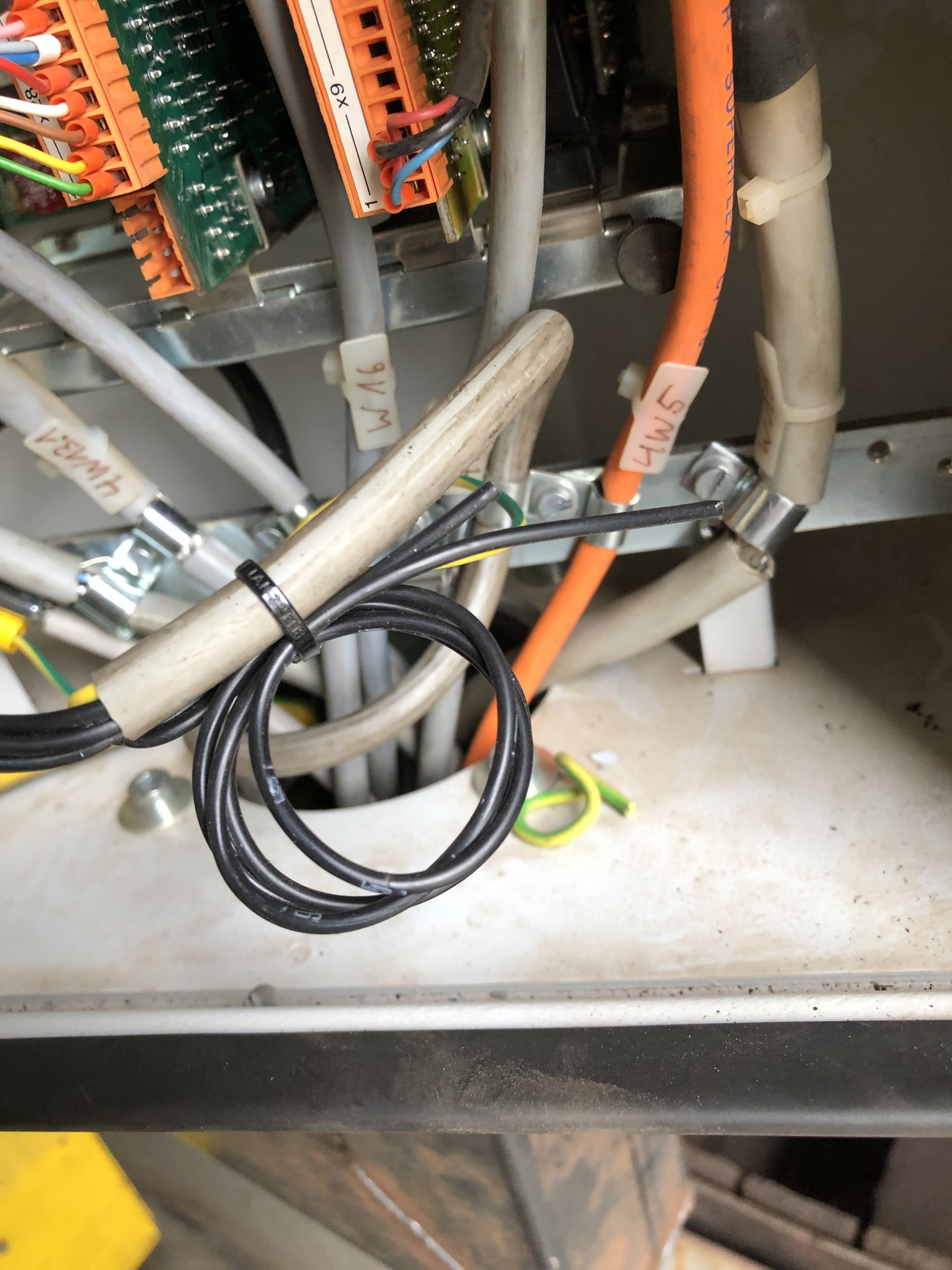

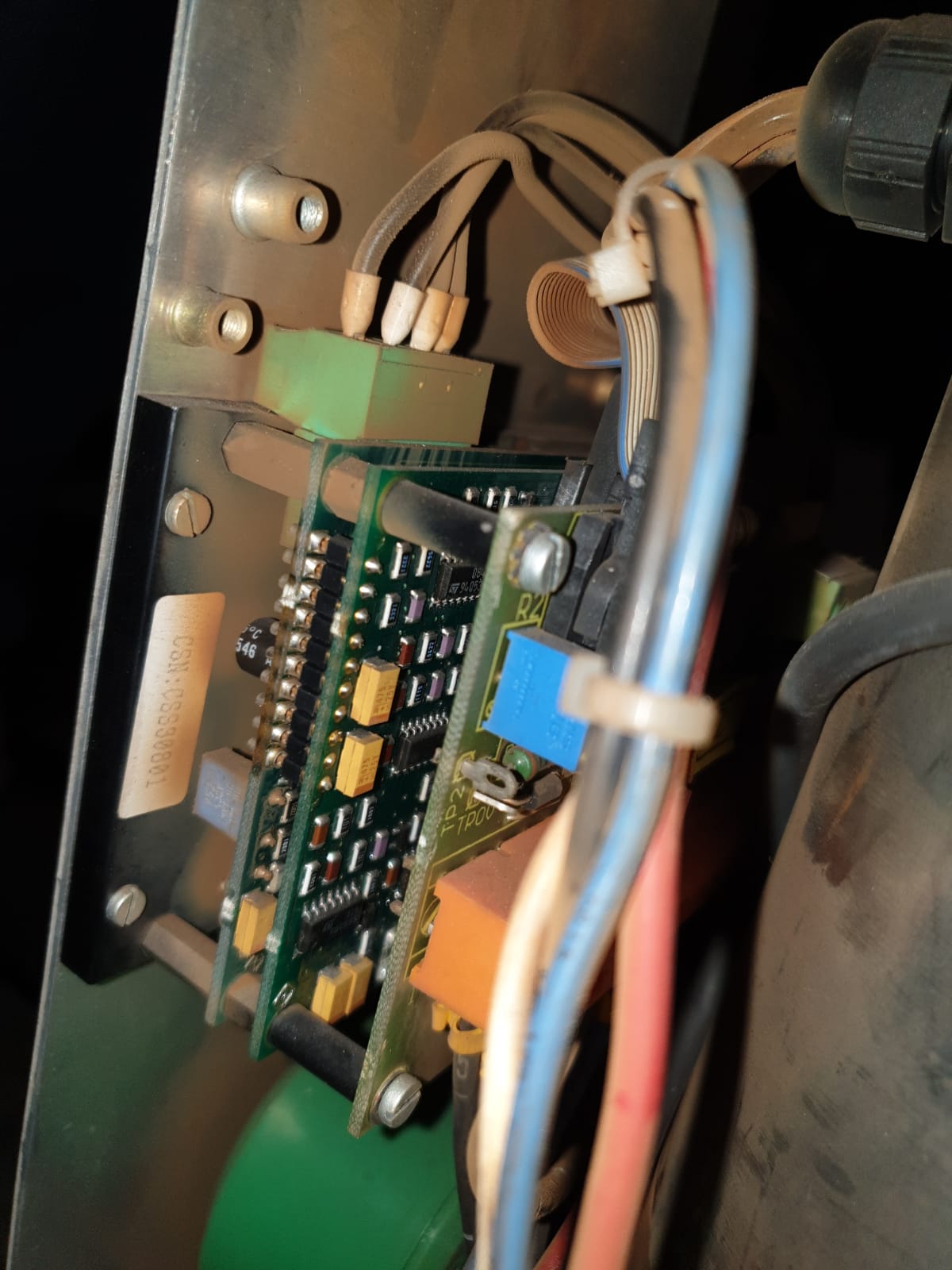

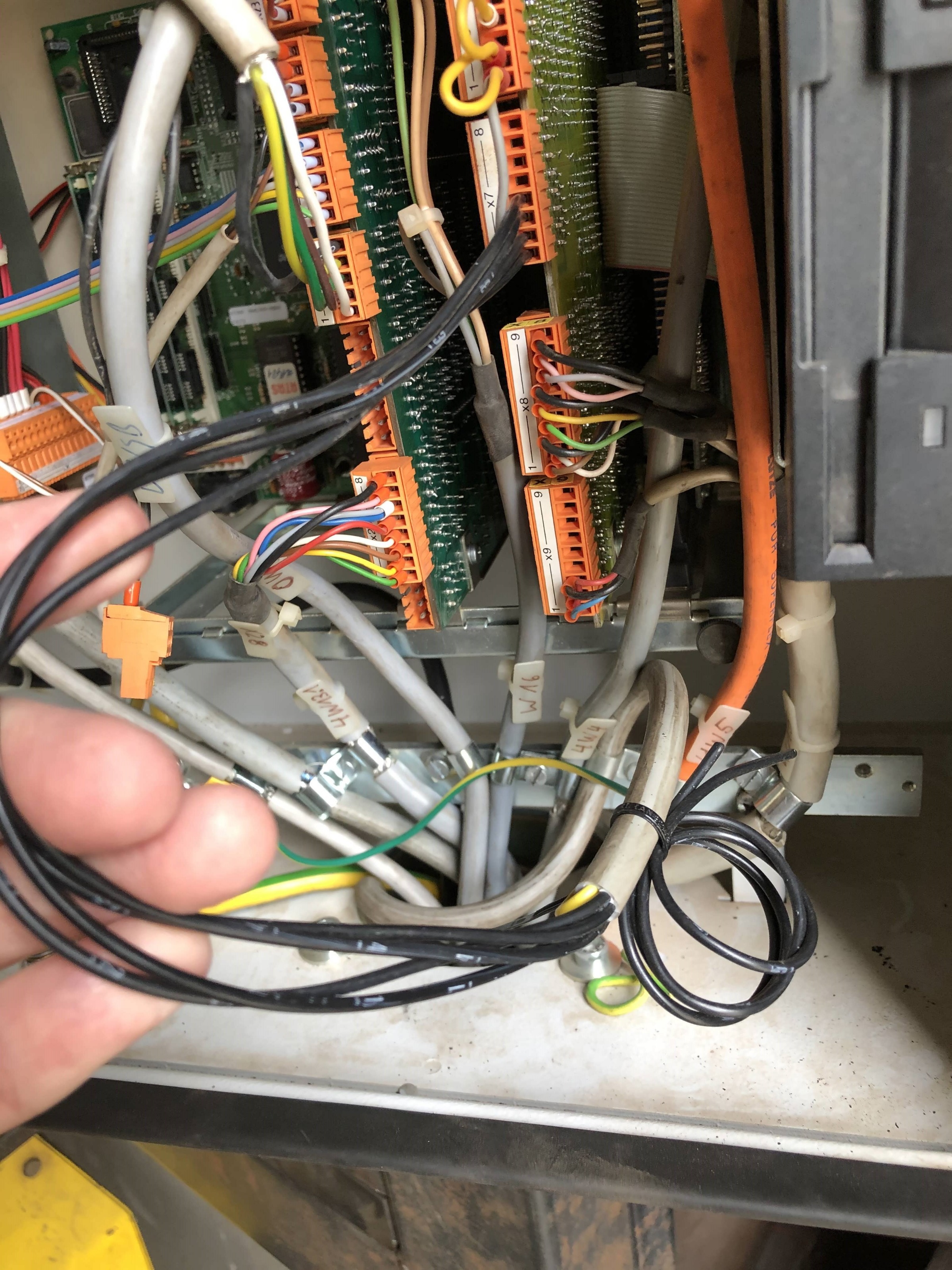

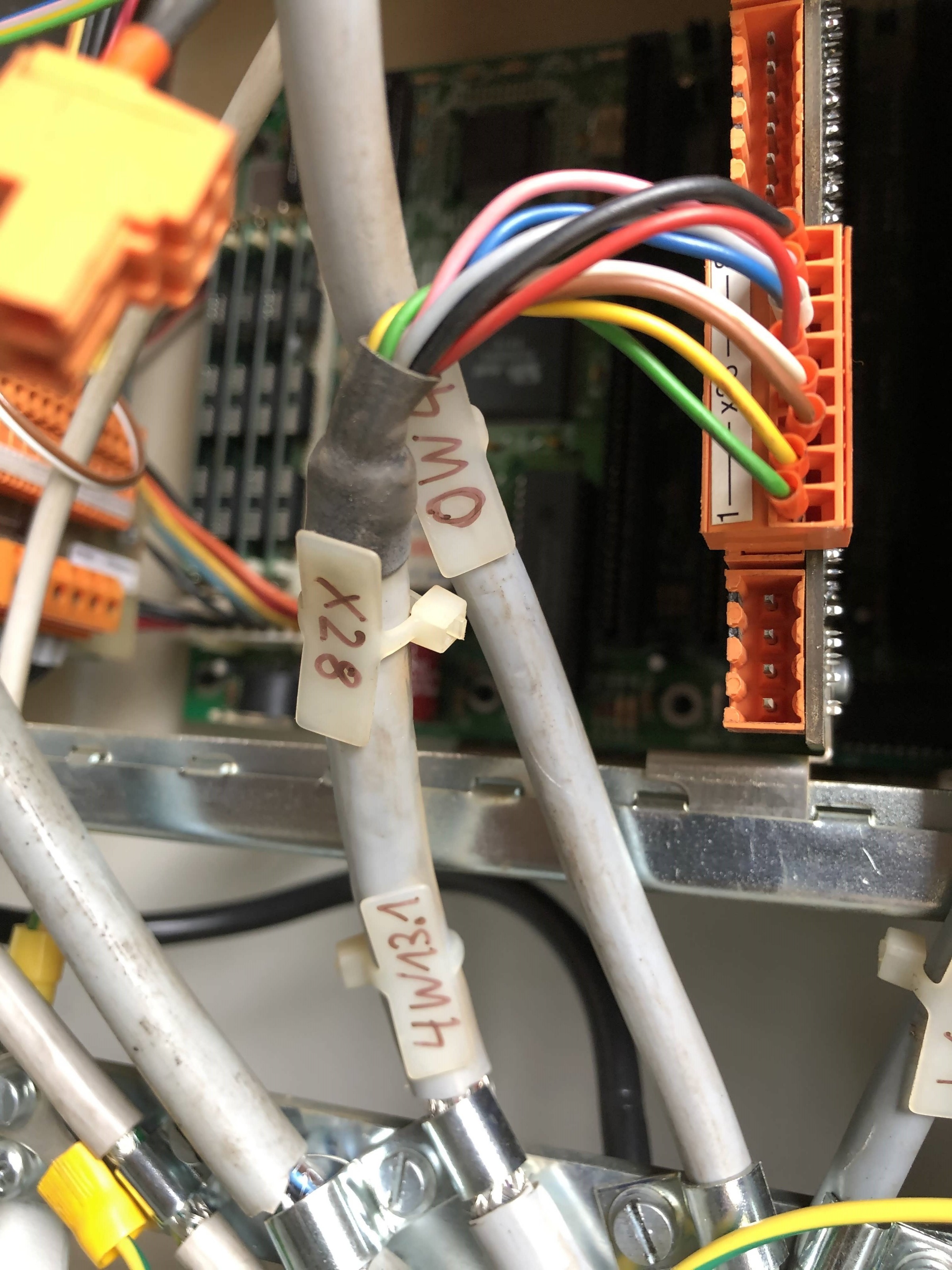

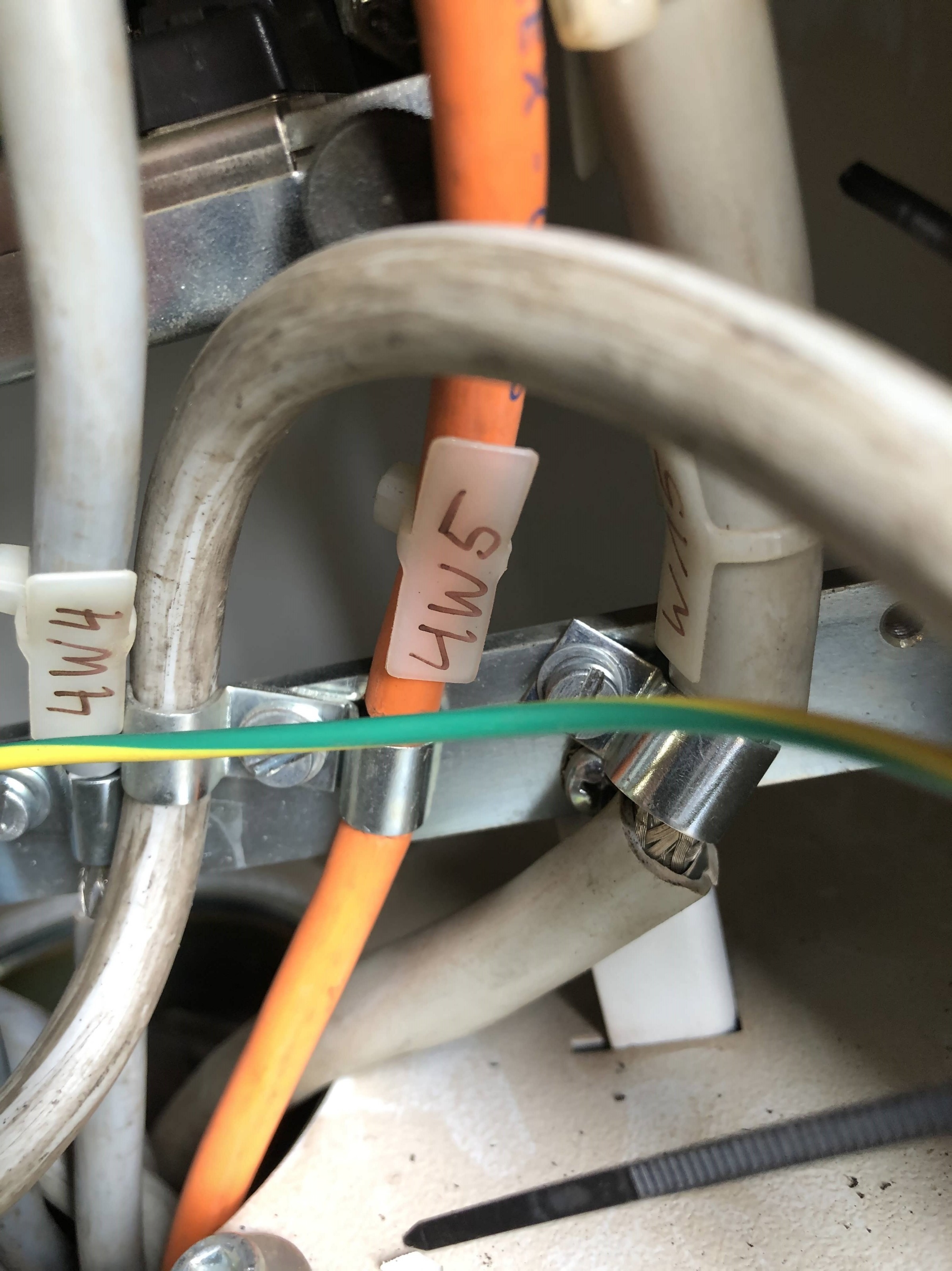

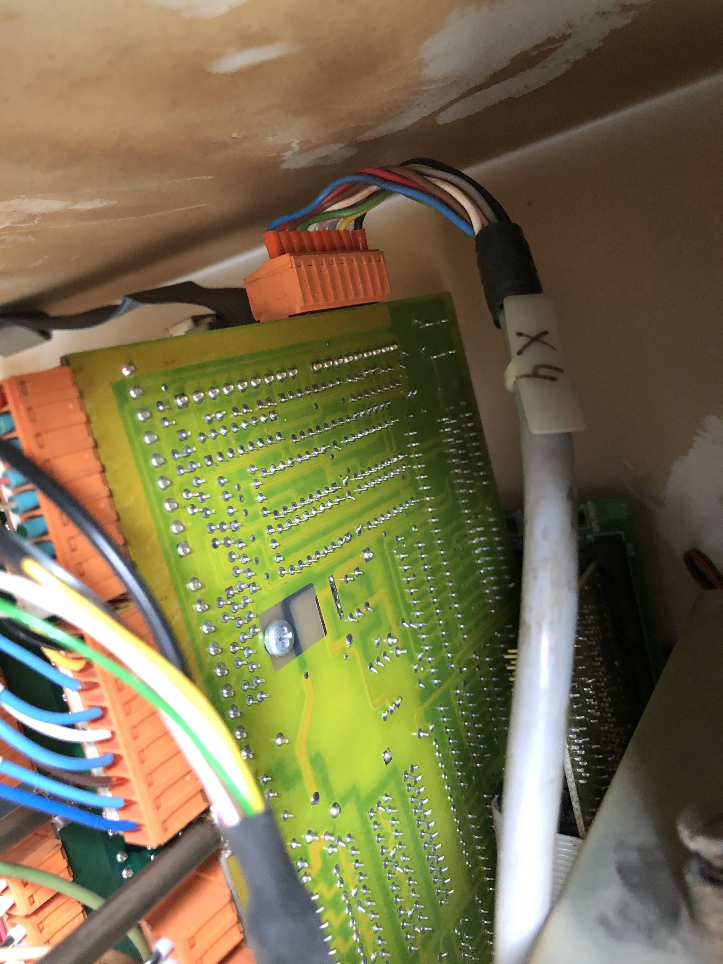

SO I went back in time and read your post.
The Z motor board goes.
The plasma cutter box stays.
The X/Y motor boards stay
Last edit: 27 Jun 2020 20:16 by Esaber.
- Posts: 20232
- Thank you received: 6880
27 Jun 2020 20:39 #172907
No, not the board, that is the servo drive for the X axis motor.
- Posts: 20232
27 Jun 2020 20:41 #172908
The only things to remove:
Z axis motor to be replaced
Control box electronics where the monitor was.
Nothing else.
Nothing else.
