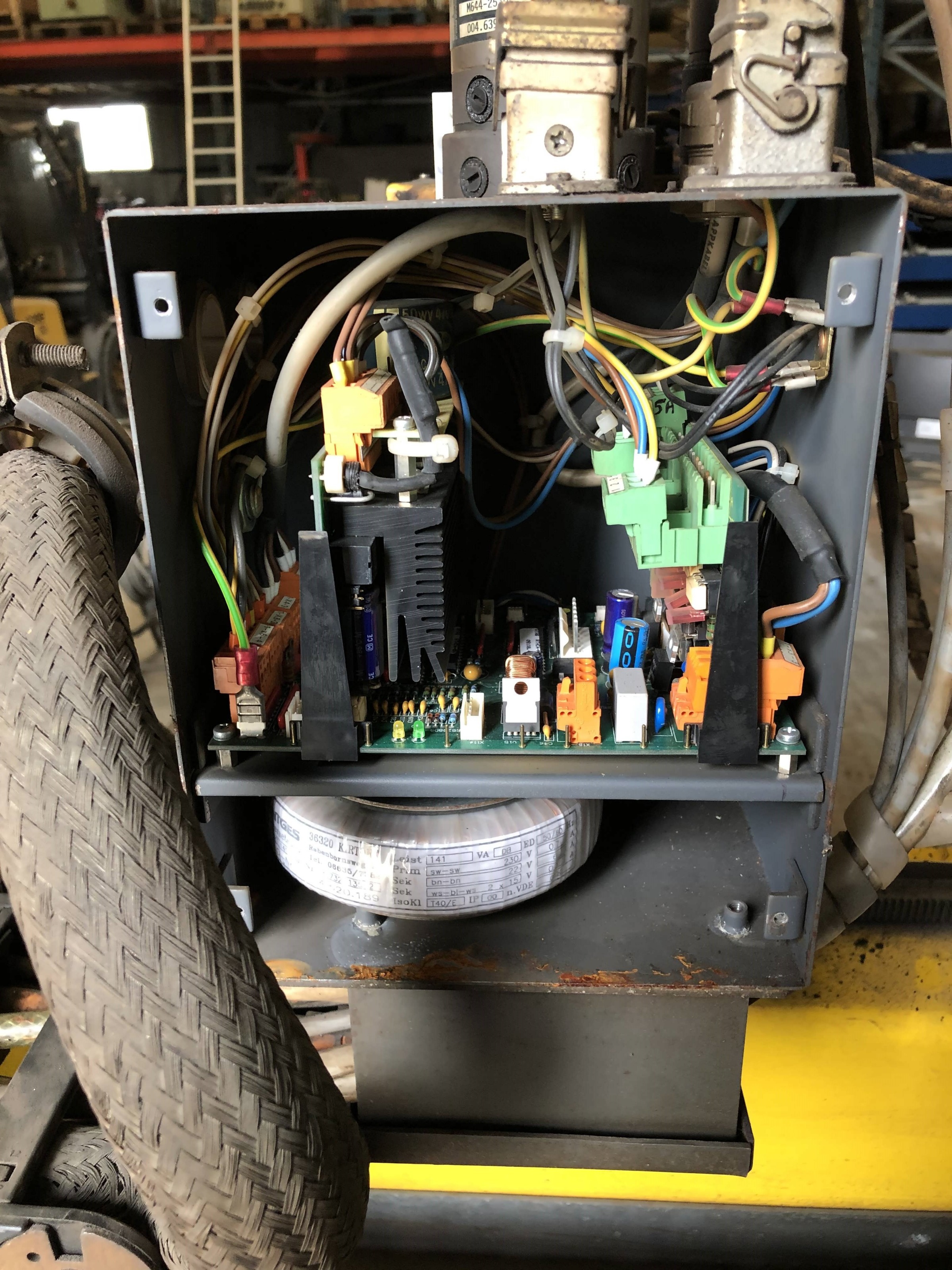

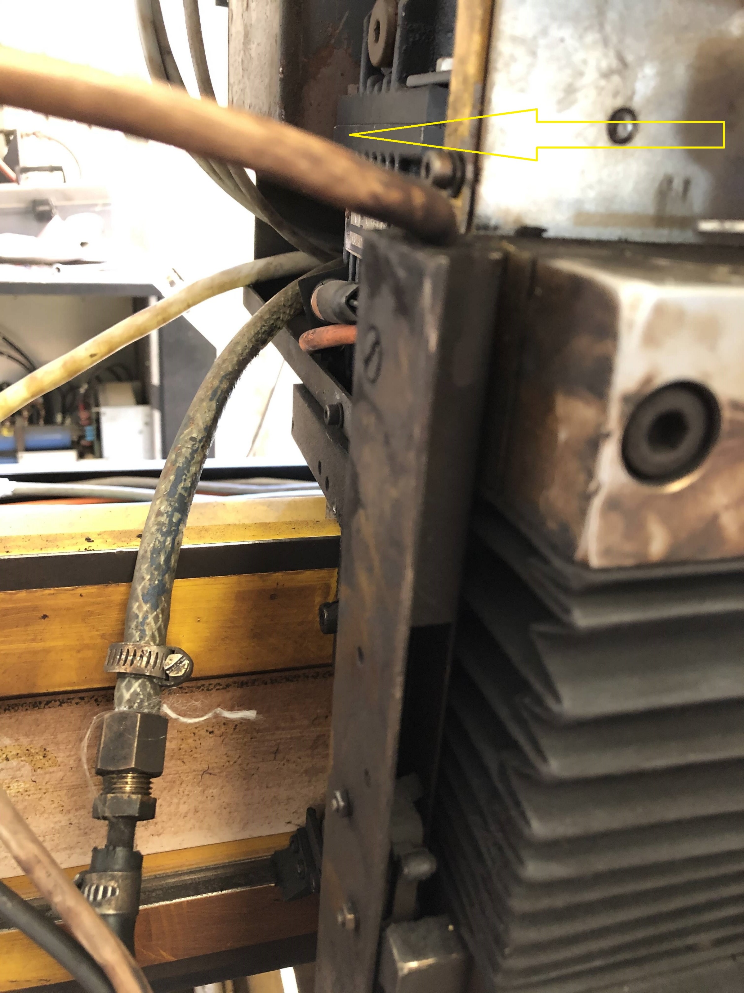

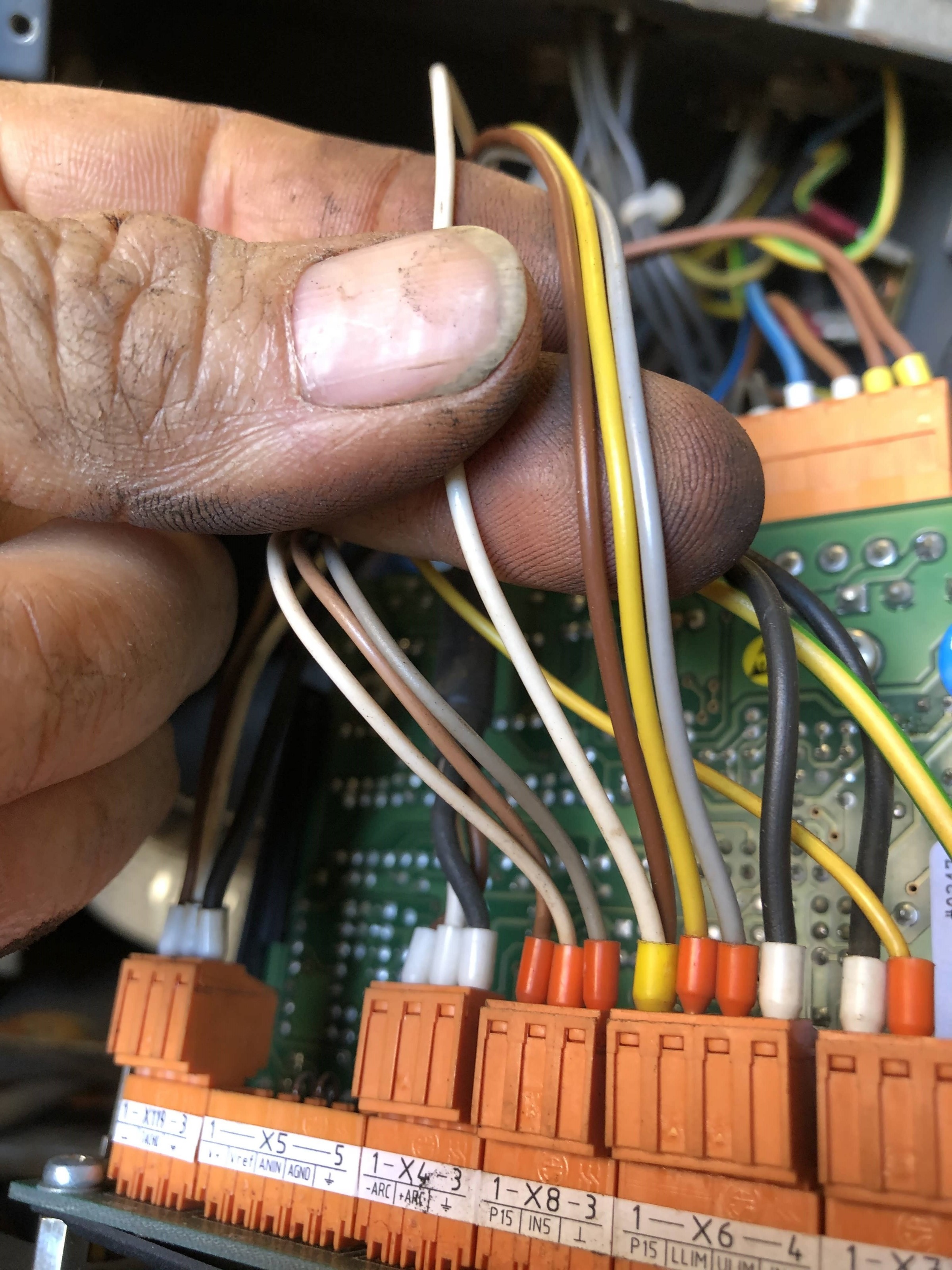

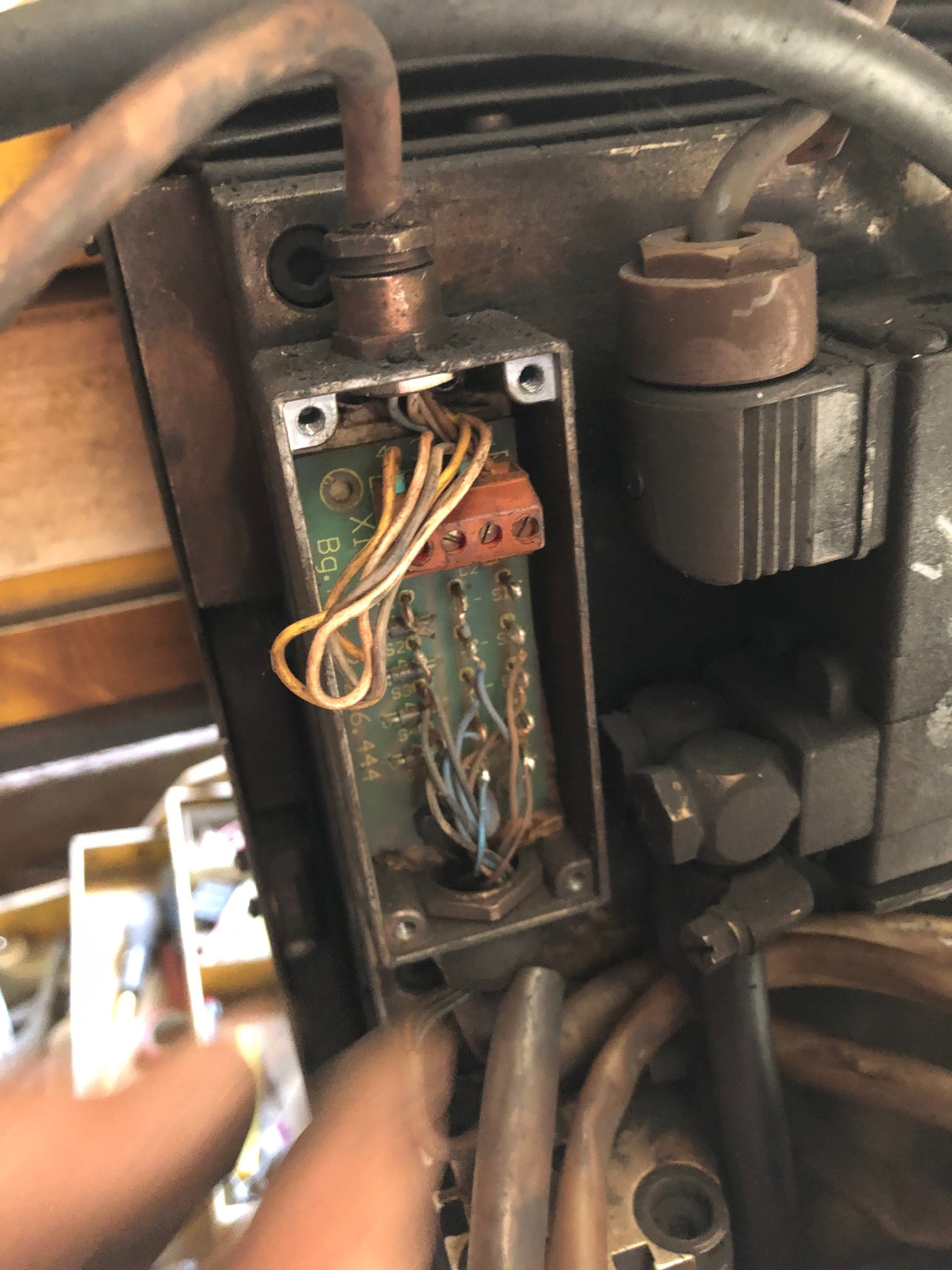

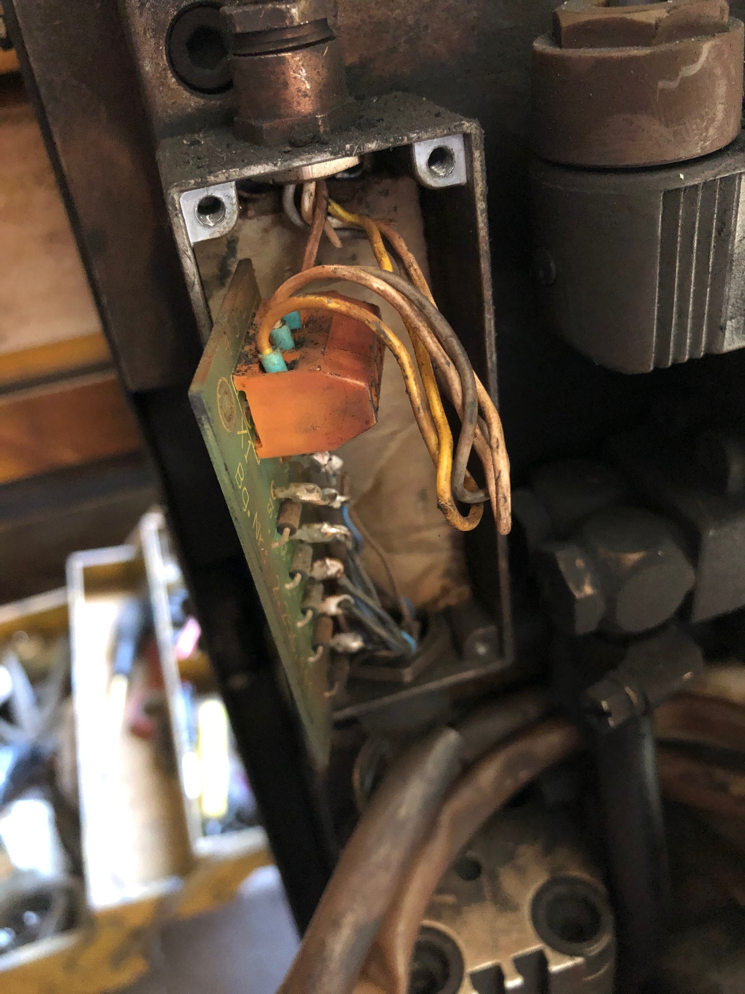

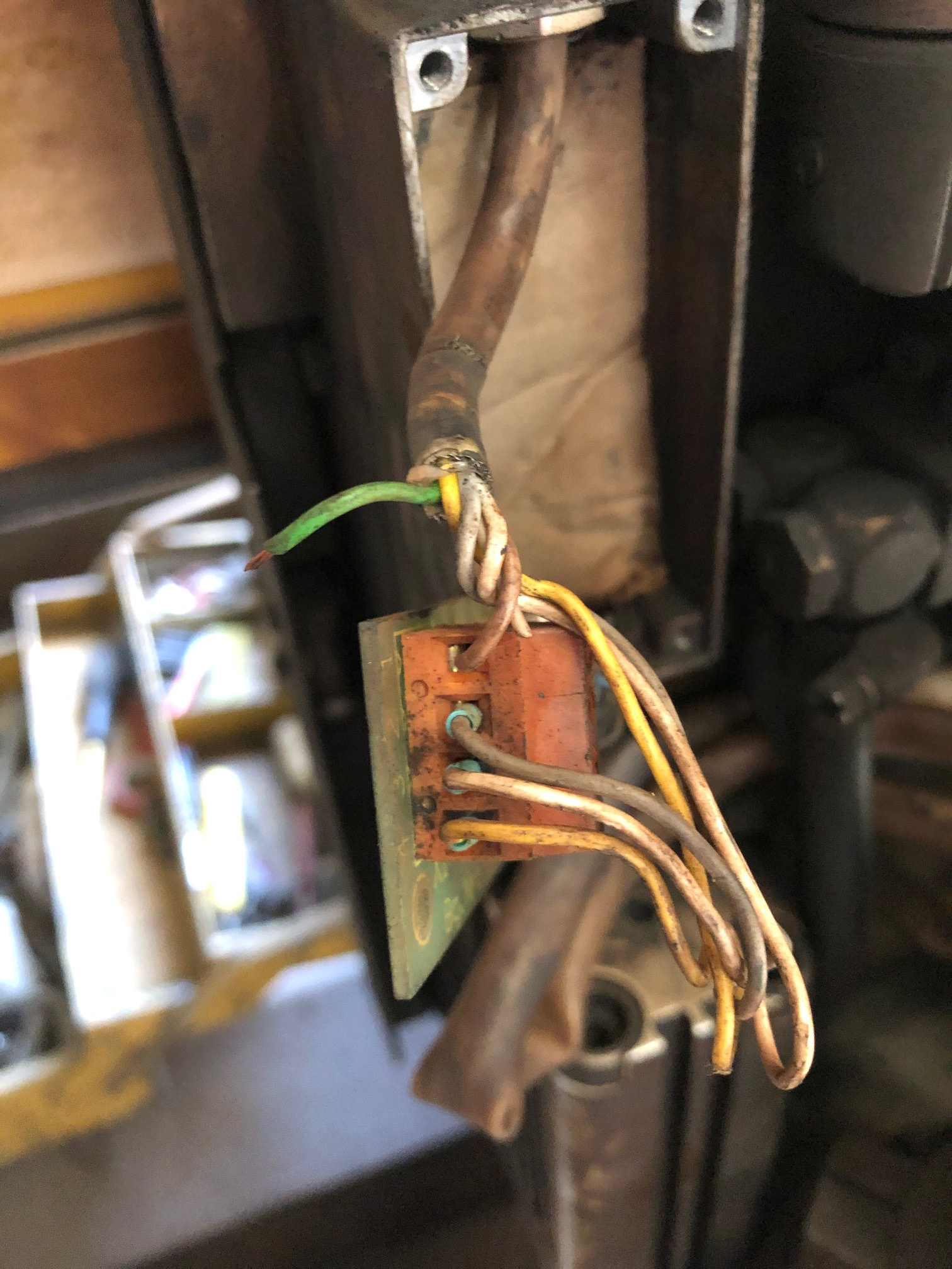

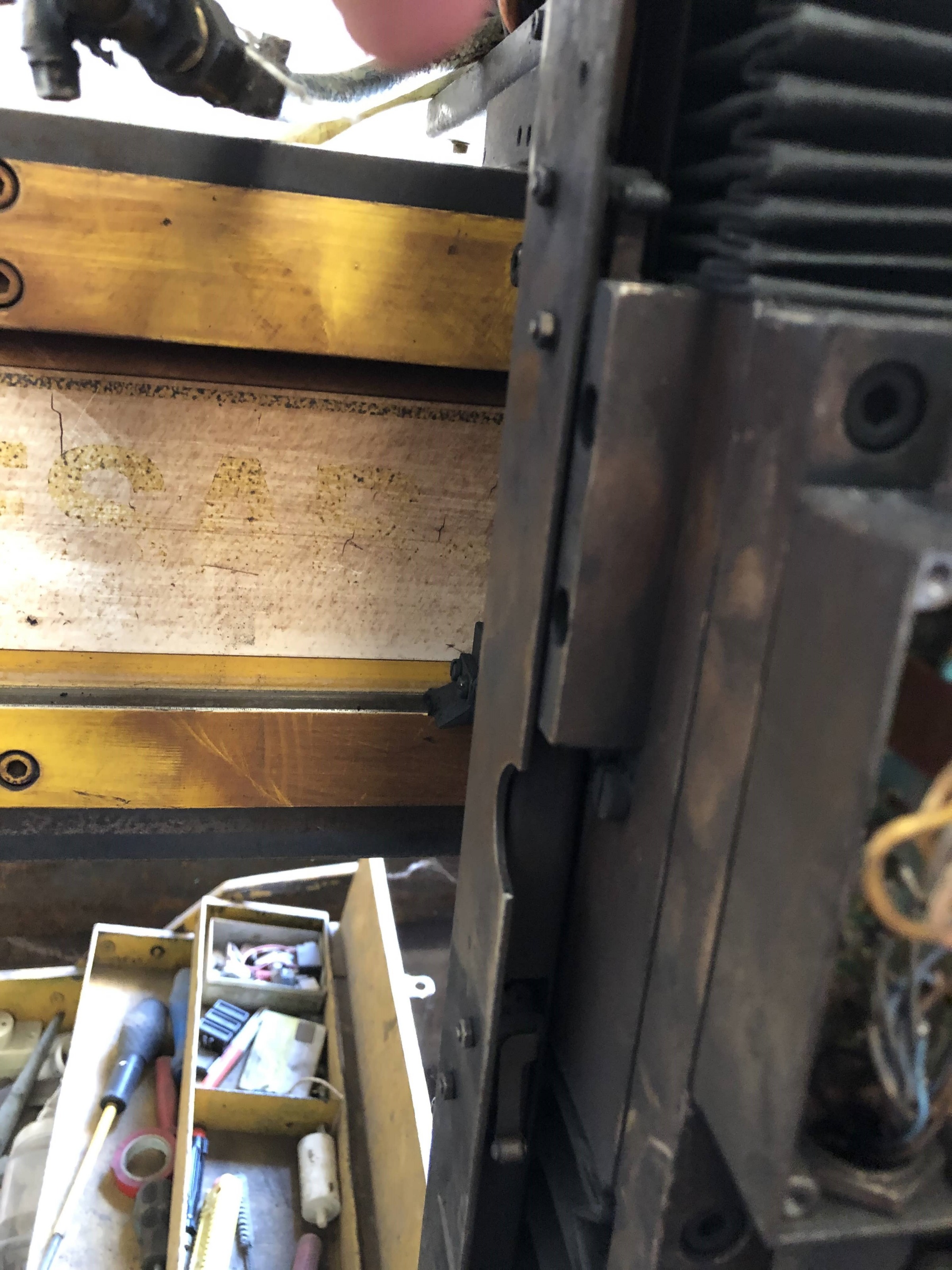

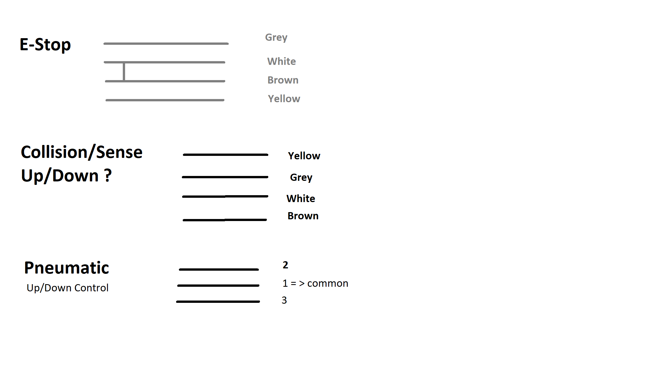

Back on track guys ! How are you doing?
So we checked the Z motor side.
Z motor => 2 wires (blue/brown)
Up/Down control => 3 wires (yellow/brown/bleu)
End Stop Up/Down => 4 wires
Collision detection => 4 wires
All these guys go to the box behind the z motor.
Where do these guys go on the mesa board or on the computer side?
I will add some pics.
We will remove the z motor tomorrow.
- Posts: 20232
- Thank you received: 6880
17 Jul 2020 18:19 #174952
Replied by tommylight on topic Esab Ultrarex UXD-P2000 Upgrade Project
Need to see pictures of the sensors and wiring, most probably there would be only one or two wires for the up/down and one or two for the collision sensor/probe/floating switch.Z motor => 2 wires (blue/brown) <<<<<Nowhere, new wires to the new motor
Up/Down control => 3 wires (yellow/brown/bleu) <<<<<<< Not used
End Stop Up/Down => 4 wires <<<<<<<<<<< new shielded wires between them and the Mesa board
Collision detection => 4 wires <<<<<<<<<<< new shielded wires between them and the Mesa board
