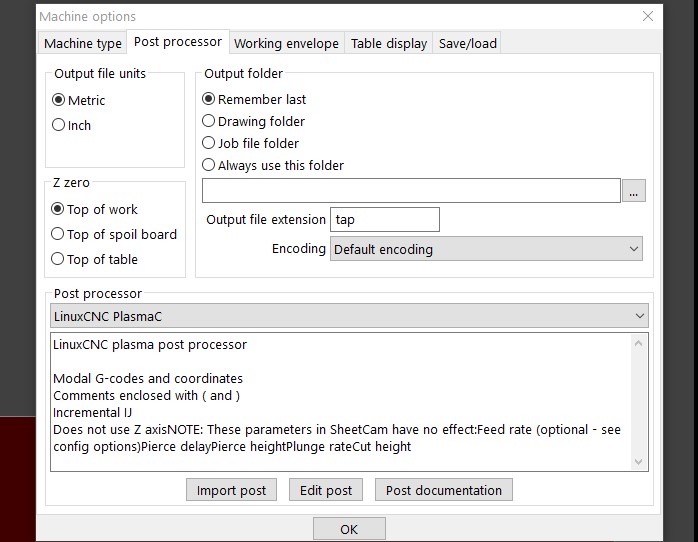

Can somebody post the working sheetcam post processor file the ones I see on the other threads are for other programs and don’t see any for sheetcam

The latest win version of SHEETCAM has the PP built in
Replied by Clive S on topic New Project with Mesa 7I96 and THCAD-05

So the one already in sheetcam program should work with plasmaC?
Replied by TexasCNC on topic New Project with Mesa 7I96 and THCAD-05

27 May 2021 17:15 #210453
by Clive S
