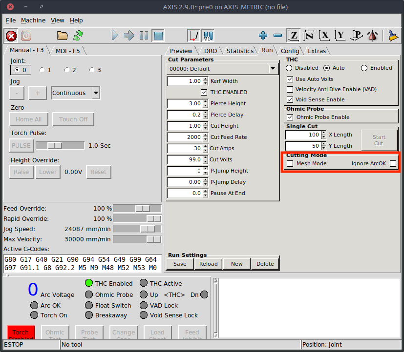

Is the THC Enabled LED on while cutting?
Does the THC Active LED turn on while cutting?
Do the Up/Down LEDs turn on while cutting?
Do you have Mesh Mode or Ignore Arc OK enabled?
Could you post the backup of the config.

Is the THC Enabled LED on while cutting? Yes
Does the THC Active LED turn on while cutting? Yes
Do the Up/Down LEDs turn on while cutting? No
Do you have Mesh Mode or Ignore Arc OK enabled? I am not sure where do I check that? When running that job the z motor burnt out cause it won’t go up anymore I hear the motor whining when trying to go up but won’t move. It moves down I even swapped out driver and still does the same so I think it might of messed up stepper motor or it just gave out. Ordered another one don’t come until Friday. I have a spare on my other running machine but right now that one is working.
