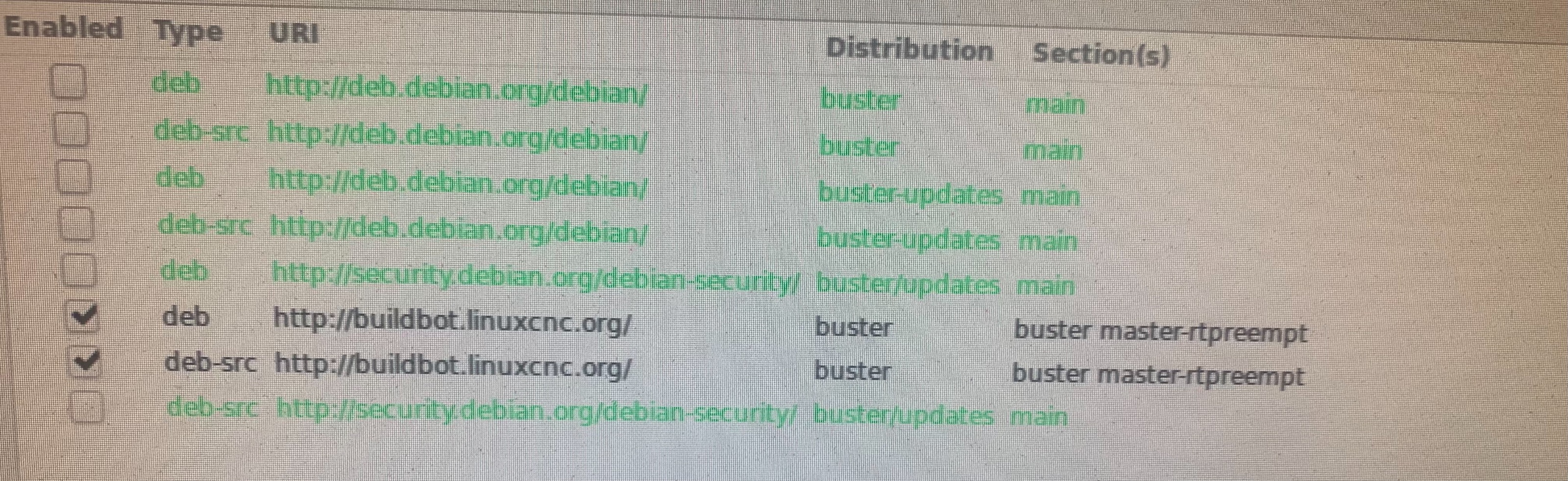

/usr/bin/linuxcnc ‘/home/card/linuxcnc/configs/last cnc/last cnc.ini
- phillc54
- Posts: 5711
- Thank you received: 2100
02 Jun 2021 05:01 #210950
by phillc54
Replied by phillc54 on topic New Project with Mesa 7I96 and THCAD-05
OK, so it is a package installation.
do you update by going to a terminal and entering:
sudo apt update
sudo apt dist-upgradePlease Log in or Create an account to join the conversation.

It may be worthwhile going to the following page and follow the procedure shown, it should get you to V0.191
buildbot.linuxcnc.org/
Assuming you are using Debian Buster or equivalent, use these stanzas:
deb http://buildbot.linuxcnc.org/ buster master-rtpreempt
deb-src http://buildbot.linuxcnc.org/ buster master-rtpreemptPlease Log in or Create an account to join the conversation.

Trying again
Gave me this when entering
Sudo apt update
All packages are up to date
Failed to fetch deb.Debian.org/debian/dists/buster/inrelease
Some index files failed to download they have been ignored or old ones used instead
Sudo apt update
- TexasCNC
- Posts: 373
- Thank you received: 10
02 Jun 2021 05:19 #210954
by TexasCNC
Replied by TexasCNC on topic New Project with Mesa 7I96 and THCAD-05
So what do I need to do again I am not following?

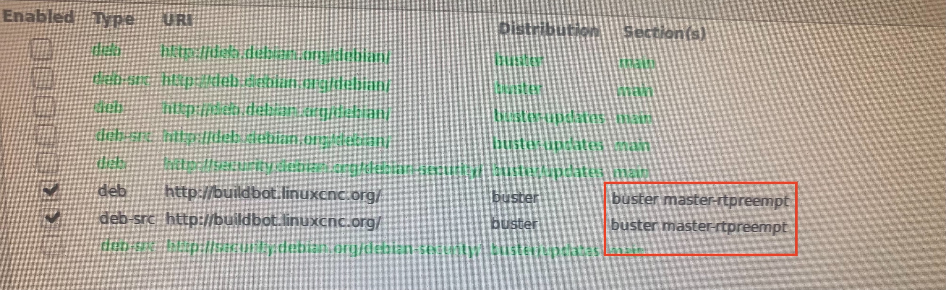

- phillc54
- Posts: 5711
02 Jun 2021 05:24 #210955
by phillc54
- TexasCNC
- Posts: 373
02 Jun 2021 05:43 #210957
by TexasCNC
Not giving the files on the repository

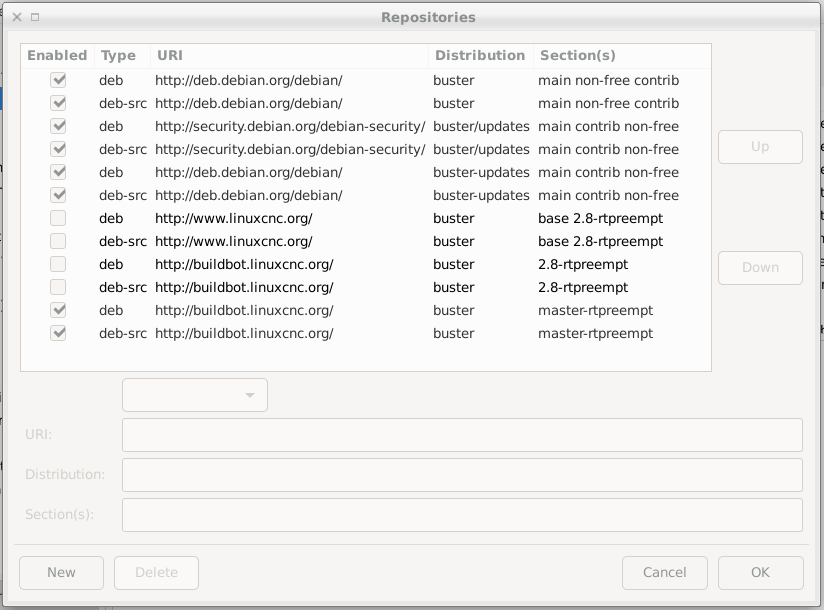

- TexasCNC
- Posts: 373
02 Jun 2021 05:45 #210958
by TexasCNC
