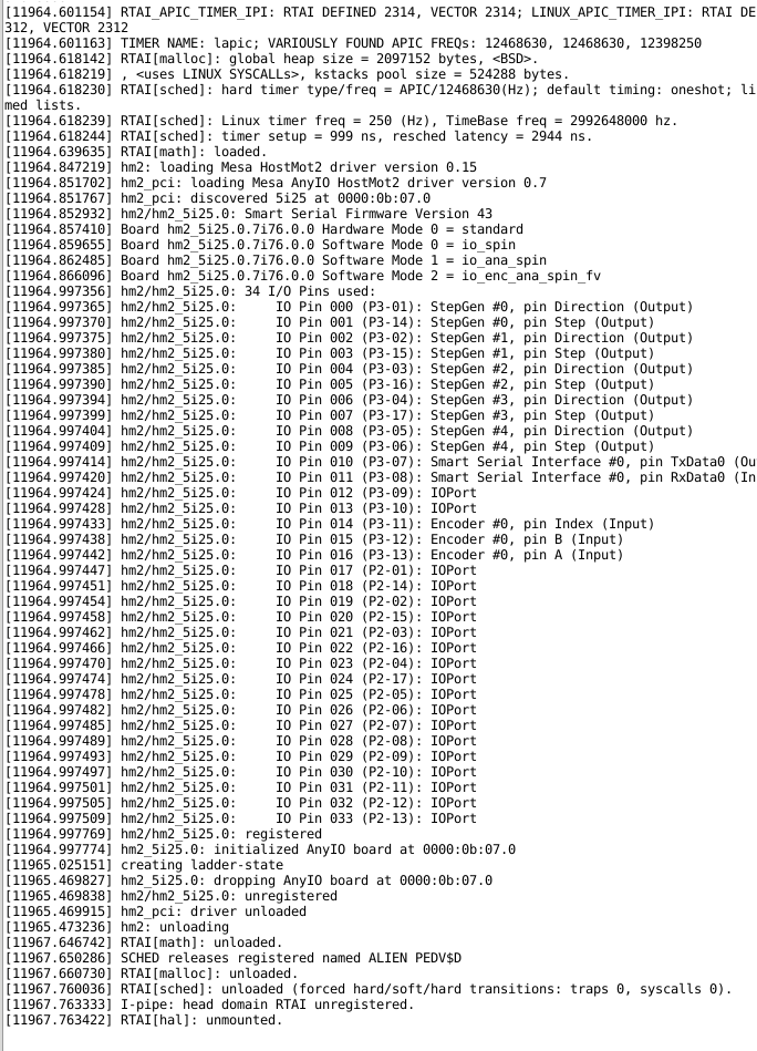

hello friends, I have made good progress in the retrofit of my fanuc o mate t milling machine, now I must make the orientation of the spindle and the tool change with the carousel, I have tried the orientation but I have always the same error, can you help me?
i tried with talla 83 program
spindel hal :17 parameter or pin 'hm2-5i25.0.pwmgen.pwm_frequency' not foud

My guess is the 5i25 doesn't make that pin
add;
show pin hm2_5i25.0
just before that line and then run linuxcnc from the terminal it will show the available pins.
add;
show pin hm2_5i25.0

Possibly because this line is telling the hosmot2 driver not to set up any pwmgens?
loadrt hm2_pci config=" num_encoders=1 num_pwmgens=0 num_stepgens=5 sserial_port_0=00xxxx"Please Log in or Create an account to join the conversation.

Set the
Num_pwmgens=0
To 1.
Num_pwmgens=0
To 1.

Can you do a
mesaflash --device 5i25 --readhmid
in a terminal and post the result?

jef@debian:~$ sudo mesaflash --device 5i25 --readhmid
[sudo] password for jef:
Configuration Name: HOSTMOT2
BoardName : MESA5I25
FPGA Size: 9 KGates
FPGA Pins: 144
Number of IO Ports: 2
Width of one I/O port: 17
Clock Low frequency: 33.3333 MHz
Clock High frequency: 200.0000 MHz
IDROM Type: 3
Instance Stride 0: 4
Instance Stride 1: 64
Register Stride 0: 256
Register Stride 1: 256
Modules in configuration:
