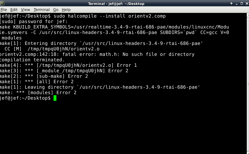

08 Jan 2021 15:47 #194507
by jefsaro
Replied by jefsaro on topic spindle orient
hello , i put files from alkbal , i find this error
- Posts: 19896
- Thank you received: 4648
08 Jan 2021 15:55 #194508
Which files? And Why?
Replied by andypugh on topic spindle orient
