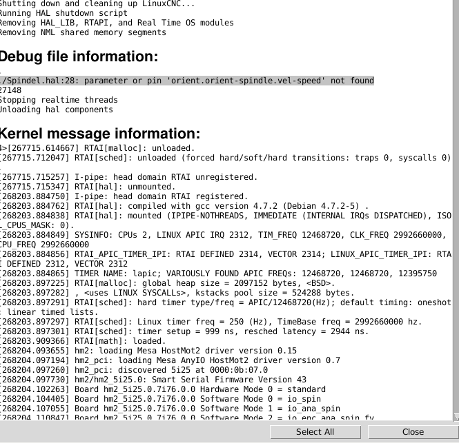

hi , now i 'am this error , where is my fault?

in your ini sectiondifferent Hal file seleced as you posted. So don't know what is wrong. Basically in line 28.
It seems you copy and paste lot of snippet somewere and pray that it works. I must disapoint you this will not work without any background.
Start with a new config.
maybe split in 4 hal files to get smaller files.
ini.hal -> put all basic config, setp, addf in
io.hal -> all I/O lines, limit, home, emg switches...
axis.hal -> all axis staff
spindle.hal -> all spindle staff
add this files in the [HAL] section of your ini
In this way you can try some snippets and modify to your environment.
And don't forget the comment. At some point you will despair

First you need to do a working spindle config with separated entry in the ink file
[ORIENT] section is only for orient
I suspect you load original orient in place of orientv2 in your loadrt
I can try to help you creating your spindle config close as possible for orient but I will need to know more about your hw

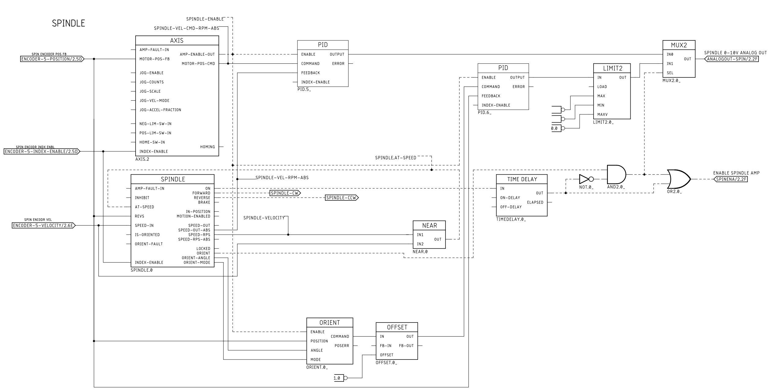

A smart young man going by the name of Talla83 configured his Milling machine with orient. He published his full configuration on his web site it's in German, use Google to translate to English if you don't speak German. talla83.de/linuxcnc/config.htm
Awhile back I made diagram of talla83's halconfiguration. It might help you tweak the parameters to work with your machine.
Edit:
I took the dogs for walk when I realize I was too brief in may previous email.
The Hal files with the orient configuration on tallas83’s web site is named 2020_09_06.zip . By tweaking parameters, I mean the parameters of the following components: spindle-pid, orient-pid, near, timedelay, offset and limit2. So, start with talla83’s settings and play with the parameters until success.
Good luck
Ben
