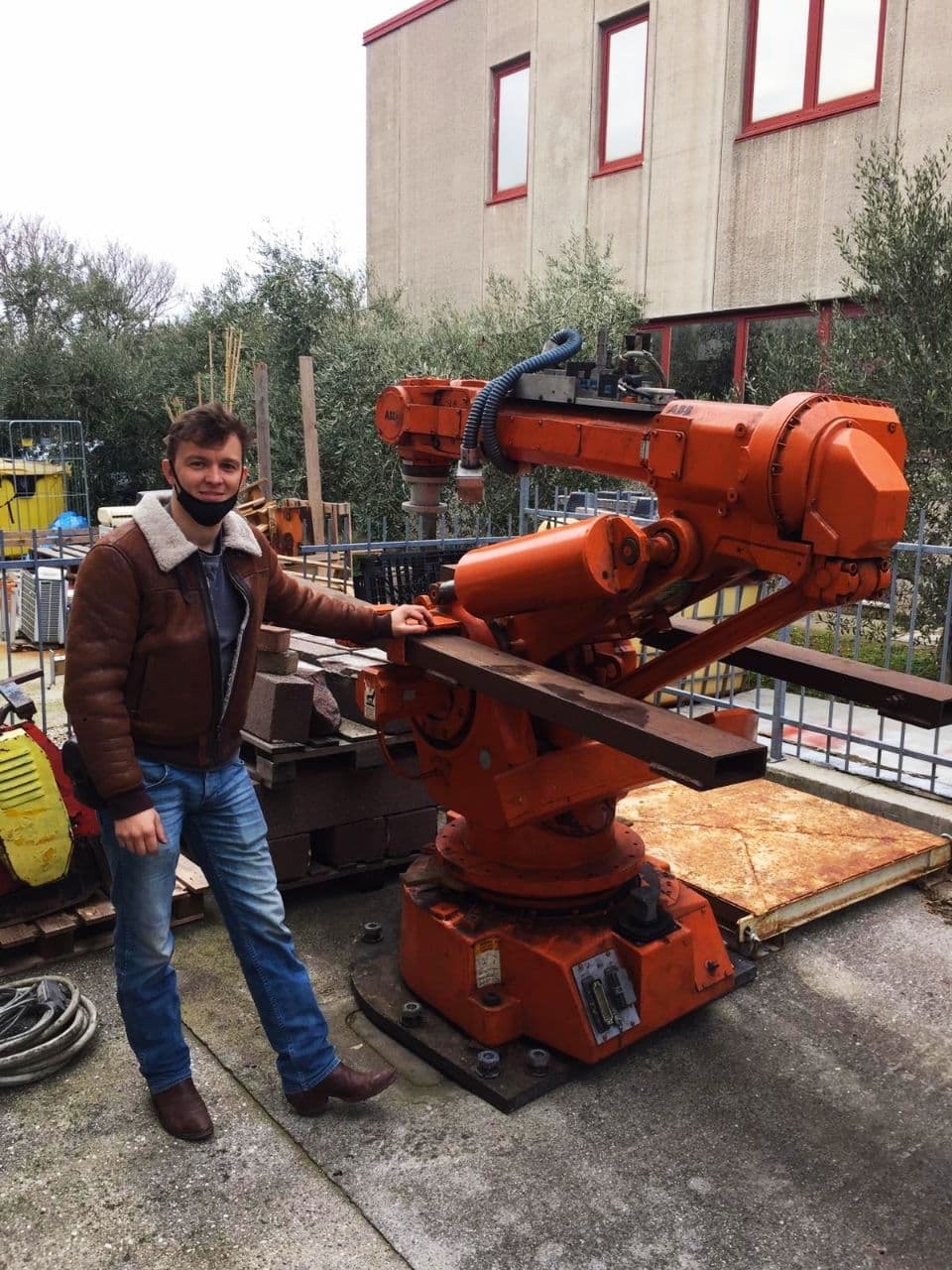

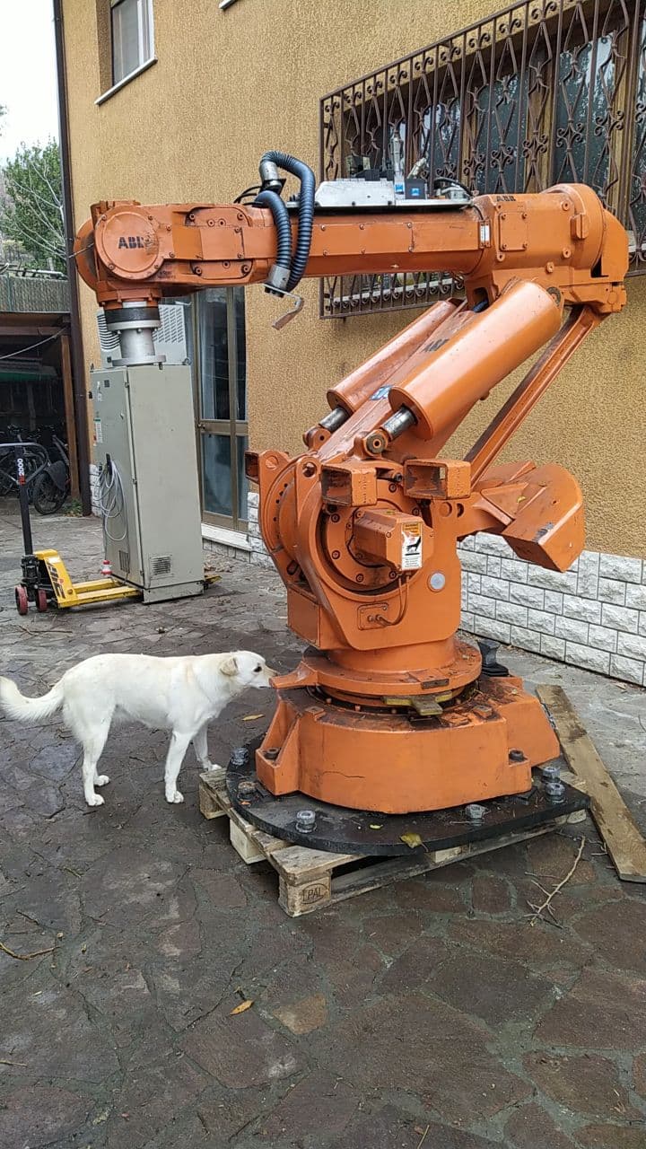

Hi everybody!
First of all I love Linuxcnc, such a good open source project!
So I'm planning to retrofit an ABB IRB 6400 robotic arm, It's not my first time when comes to retrofitting, but never done with a robotic arm.
I have the old control, but it relies on corrupted recovery floppies and it's pretty old ('96)...
Two main things are different from what I'm used to:
As I mentioned I think i will keep the measure board since I have no idea where to find a replacement and i don't want to mess with analog stuff.
The first choice i whether or not keep the 6 3phases Hbridges, but i have to figured out their interface (i think they need 2 pwm each representing the sinusoidal control loop output of two phases, the third is calculated on the Hbridge driver, also the board send back the measured current but i don't know how).
I don't know if a pc can handle 6 current loops and I don't know how safe it is, it's a 2.5 ton robot... So my plan B is to replace also the drivers. I find interesting the mesa 8i20 and the odrive.
The mesa board is still a bit expensive if u consider i'll need at least 6 of them, and i don't know how much open source is the firmware.
The odrive seems not so much mature in terms of stability in an industrial environment, but looks promising!
I guess I'll try to fit an hall effect current sensor with an integrated HV igbt bridge on the odrive (also some galvanic isolation) and then I'll choose one of the many way to connect it to the pc.
What do u think? Any suggestion?
Thank u for the attention!
- The robot has 6 revolvers read by a measurement board inside the robot self. Then it sends the position every half millisecond to the robot computer inside the cabinet. I have still to reverse engineer the protocol, I would like to reuse that board.
- The six axis servo pack is centralized i guess, there's an axis computer that compute the all 3 loops for every servo and moreover it should update the feed forward parameters dynamically based on the position of the robot (first time i hear about it and seems smart!)
