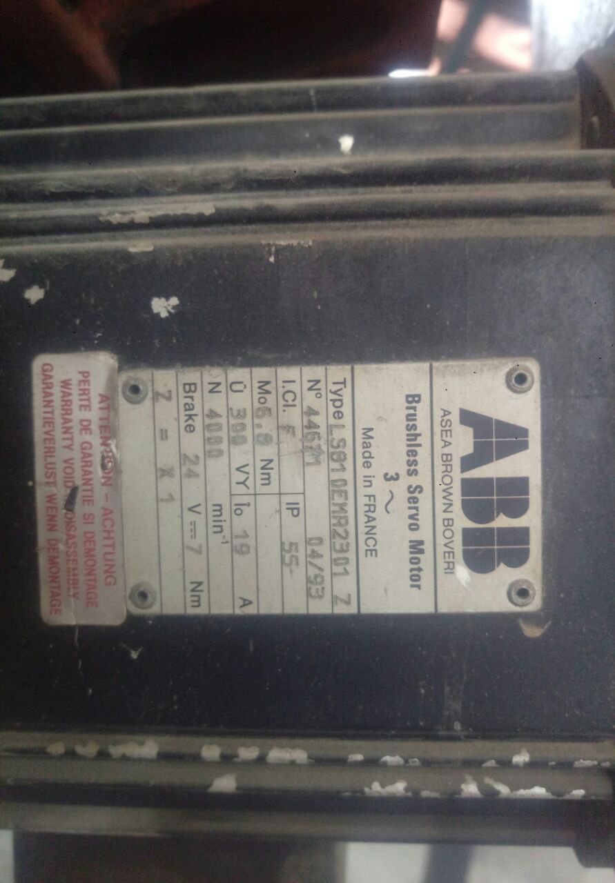

I am currently doing something similar to yours
I have an old robot with only servo motors left from its control system
I was looking for a way to drive servo motors until I came across this.
I have attached a photo of the servo motor specifications
Can I start these servos using stmbl?
Your experience and guidance will be very useful for me, so if possible, tell me what stage you are at
