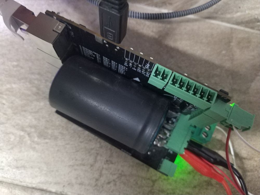

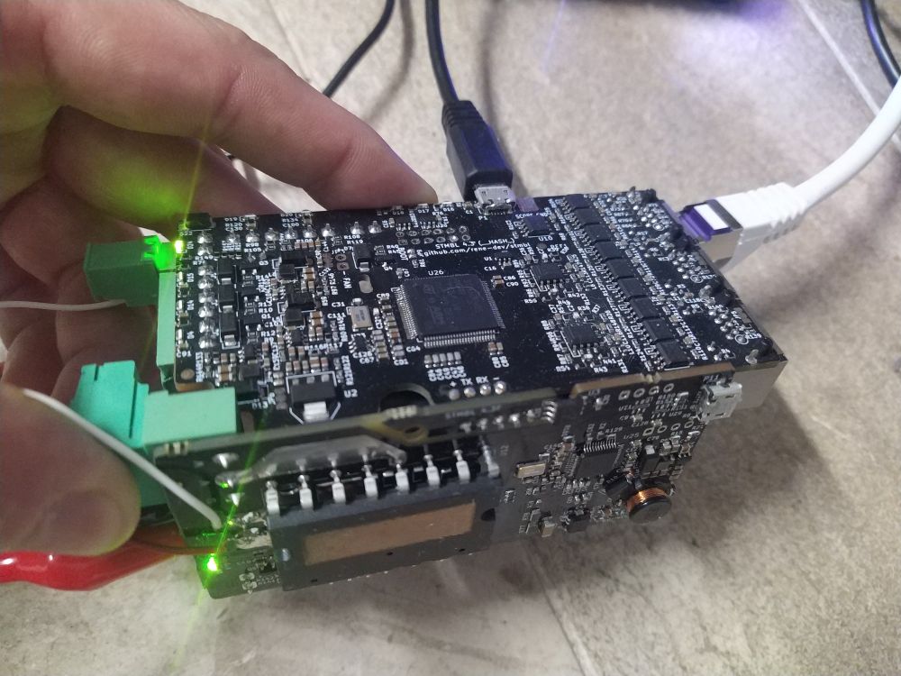

Hi, It's been a while since I couldn't continue the project. Right now I'm trying to debug the old intel nuc + 7i94 + custom stmbl.
I installed debian bullseye and linuxcnc from testing and also the rt kernel. The latency is very good.
I can connect to the 7i94 but I don't know how the smart serial works. There aren't any "sserial" entry inside the "show Hal configuration", am I missing something?
(I've loaded the 7i94ssd firmware, and the hal conf is:
In the meanwhile I post some pics about the first assembled stmbl

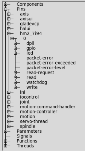

02 Sep 2022 09:25 #251008
Replied by tommylight on topic ABB IRB 6400 retrofitting
hm2_eth board_ip="10.10.10.10 sserial_port_0=0120xxxx"
should become
hm2_eth board_ip="10.10.10.10 sserial_port_0=01202222"
And you need to check the pins, not mesaflash, to see the actual pins.
Can you start LinuxCNC?
If yes, use the "show hal configuration", on the left choose "pins" then the card name then the rest of the boards that were found.
should become

02 Sep 2022 09:39 #251011
by Freak
Replied by Freak on topic ABB IRB 6400 retrofitting
yes the output is in the attachment, is it normal to not see the sserial entry?
- Posts: 22043
- Thank you received: 7506
02 Sep 2022 12:09 #251032
No.
All Mesa sserial cards i use have a green flashing led when LinuxCNC is up and running and their pins show.
