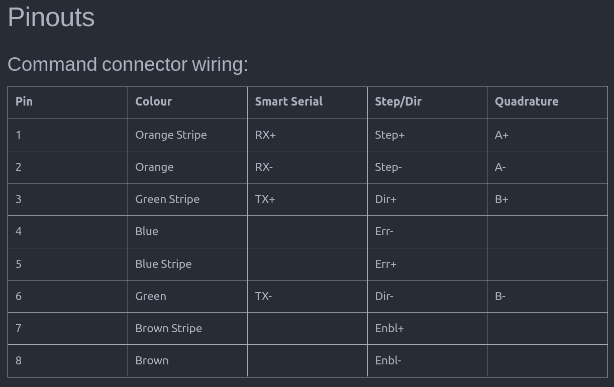

Thankyou for the info! So now I've been able to connect the stmbl to one motor resolver with success!
Still I can't connect the stmbl to the 7i94 with the sserial. I added to the end of the stmbl config the "link sserial", the leds on the cmd port of the stmbl lights up, but still any "stmbl" or "sserial" entry in the "hal config".
I also checked the ethernet cable for the sserial and has all cables without cable crossing... is it right?

Yes, a Straight through cable is used (at least for all Mesa SSerial remote cards)

Ok but looking to the pinouts in the documentations seems that the polarities are swapped. If that's the case I need to make a custom cable.
Could be the case?
Could be the case?

I doubt it, Probably just a different interpretation of + and -.
Mesa uses the EIA RS-422/423/232 interoperability spec
which means XX+ is the inverted signal

There are 2 wiring standards for ethernet. 568a and 568b. The example Mesa provide is for 568b
Sounds like your cable (like mine) is 568a. Check your wiring standard and modify the example to suit your card.
It really would be nice if Mesa added wiring diagrams for 568a as well.
