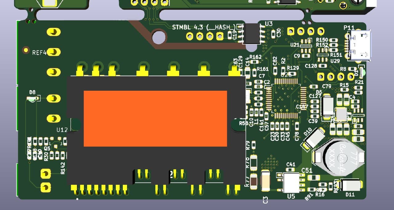

08 Feb 2021 22:48 - 08 Feb 2021 22:50 #198090
by Freak
Replied by Freak on topic ABB IRB 6400 retrofitting
Just a brief update: I'm editing the stmbl schem-pcb-firmware to accomodate a much efficient and powerful on-semi integrated bridge (FNB34060T) and bigger caps.
So i had to modify the temperature reading, shunt resistors and other minor changes, but this bridge can delivery 4kW of power, with the same pcb form factor!
As soon I'll have the first prototype ready I'll post some news!
Last edit: 08 Feb 2021 22:50 by Freak.

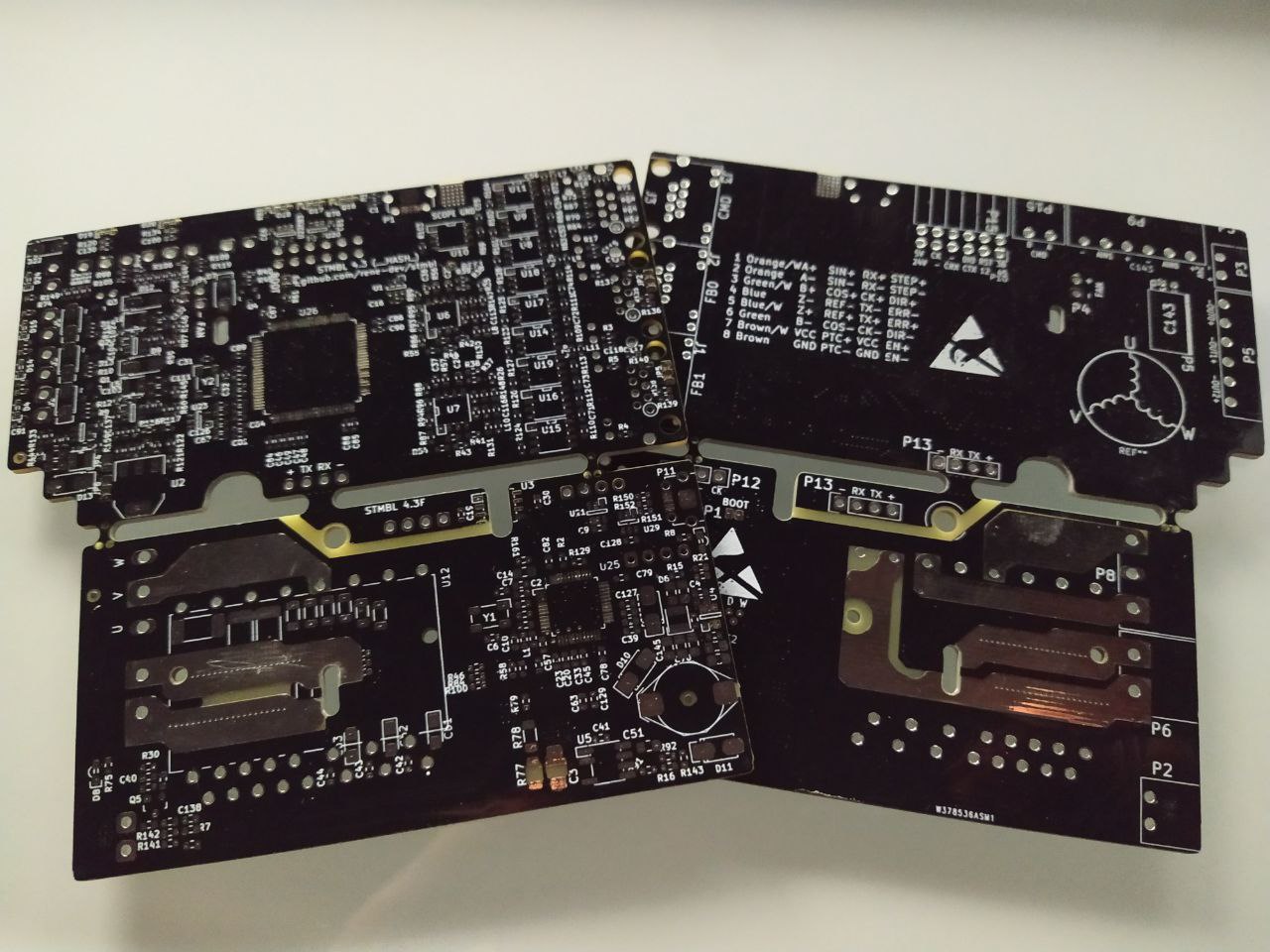

14 Mar 2021 00:27 #202175
by Freak
Another quick update, I have the new pcbs, I plan to assemble this or next weekend.
The following user(s) said Thank You: arvidb, tommylight
- Posts: 21901
- Thank you received: 7465
14 Mar 2021 01:32 #202181
Replied by tommylight on topic ABB IRB 6400 retrofitting
After assembling, i will gladly test them for you, just mail them my way !
