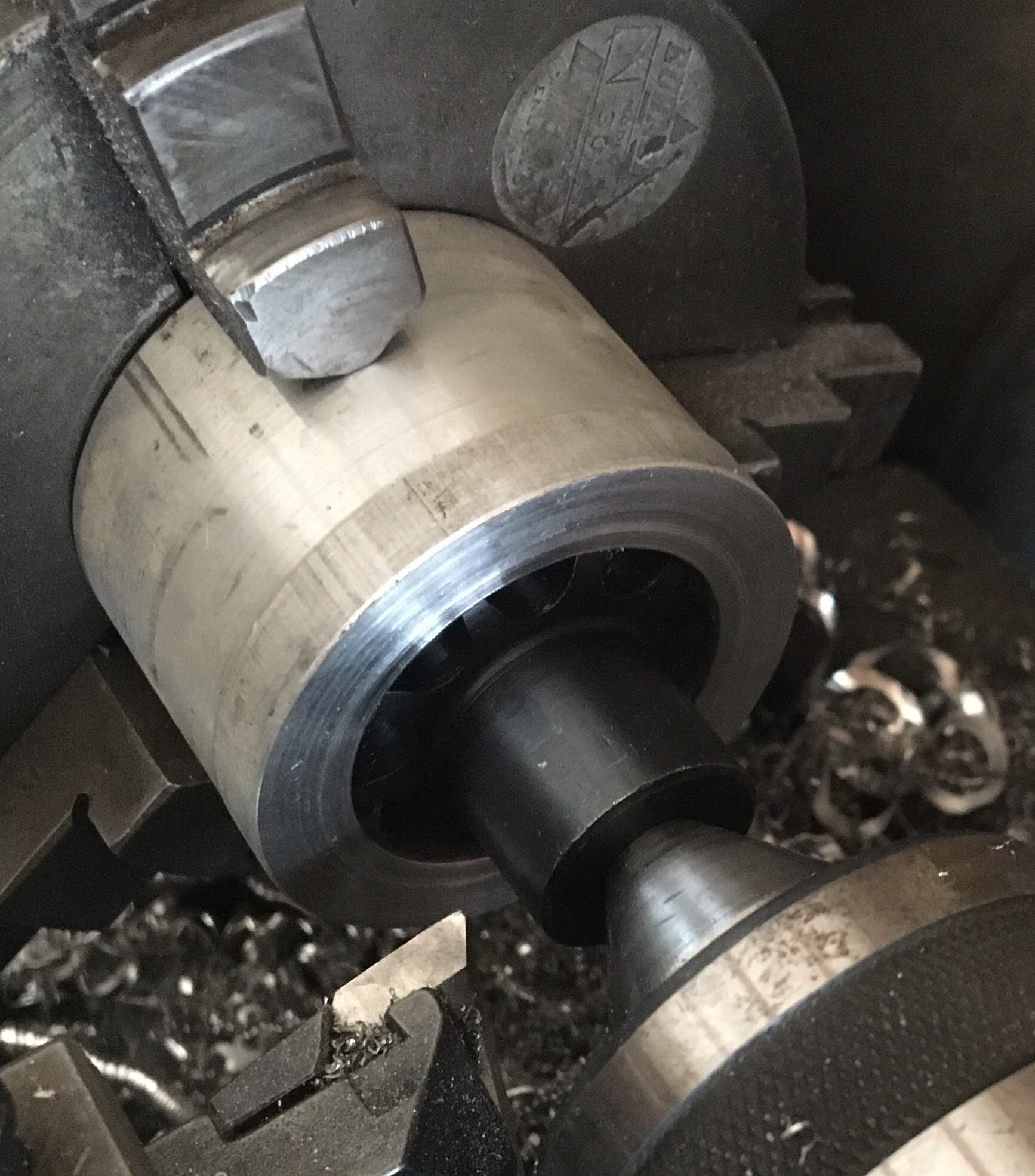

I just had a rude surprise. The sprockets non precision surprises me. Both the shoulder and pilot hole of the sprocket are at least 1mm off center, compared to the teeth.
Question is that normal? What tolerances would you expect on sprockets?

Generally the words "chain" and "precision" don't belong in the same sentence.

So from what I learn sprockets are not precise. So I made a plan. On the Lathe I drilled a hole that is slightly smaller than the diameter of the gear into a peace of aluminum. Turned the shoulder down till it was centered. After that I put the sprockets into the chuck and made the pilot hole bigger. Now they are within 0.1 mm I think that is acceptable.

I think that you should expect better than that. In fact you should send the parts back for a refund.
Sprockets should be perfectly concentric, they can't work properly otherwise.
