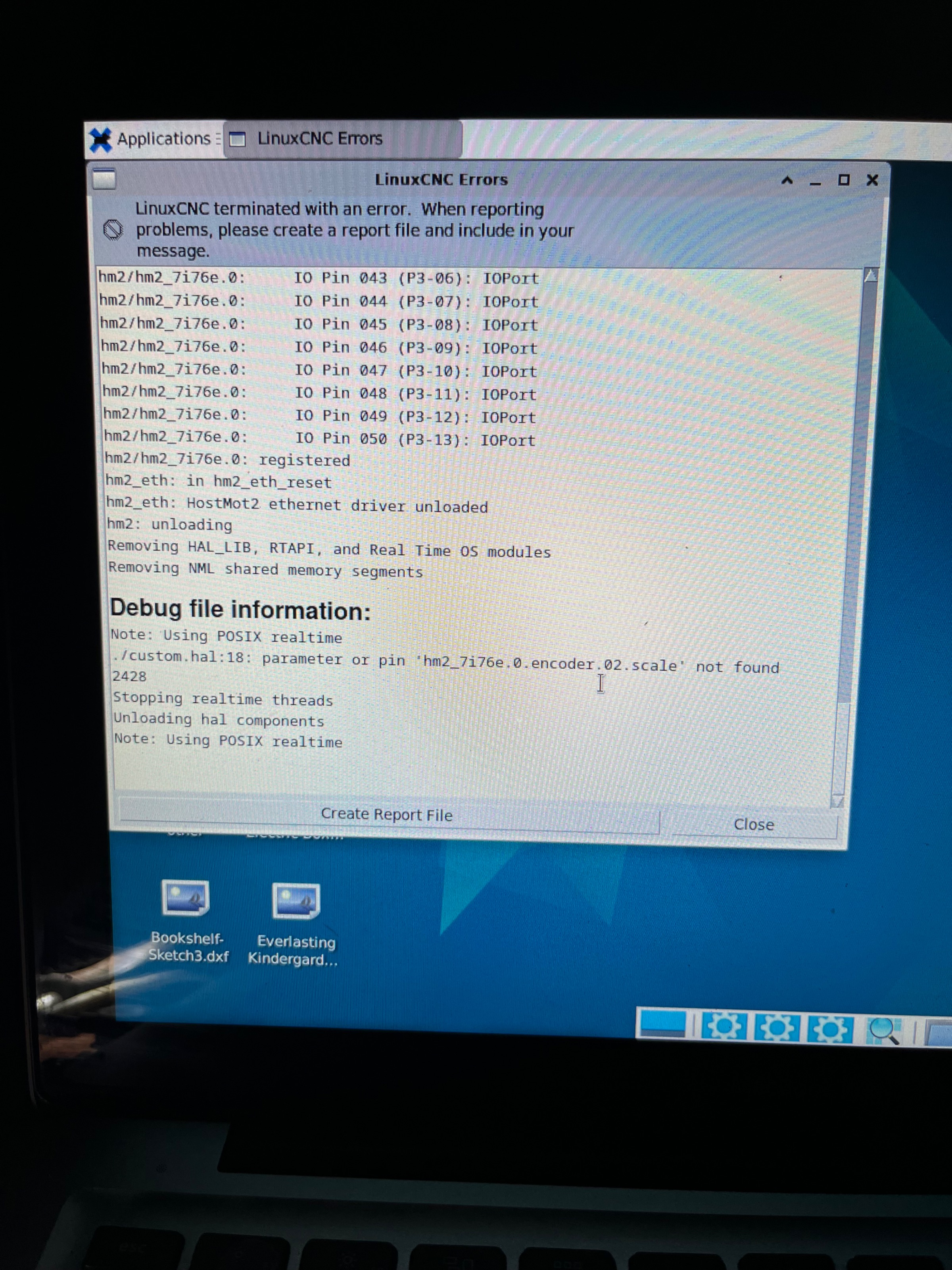

I just installed ethtool.
Now there is no error message on startup.

I have downloaded the Firmware files from mesa. There are many files in the hostmot2 folder but have no idea which file I need to flash unto the 7i76E mesa board. What is the file name?
other question is about the serial resistor between positive and Thcad recommended is 390k but in one of the threads 25k is recommended can I freely experiment with resistors? Or does it need a high value to protect the Thcad?

7i76e_7i76x1_Dpl.bit is the firmware needed for a 7I76E and multiple THCADs
The load resistor for Ohmic sensing determines the sense current
I would not use higher than 25K
Note the if you use a lower value you need to make sure that you do not exceed
the resistors power rating with the open circuit plasma voltage.
