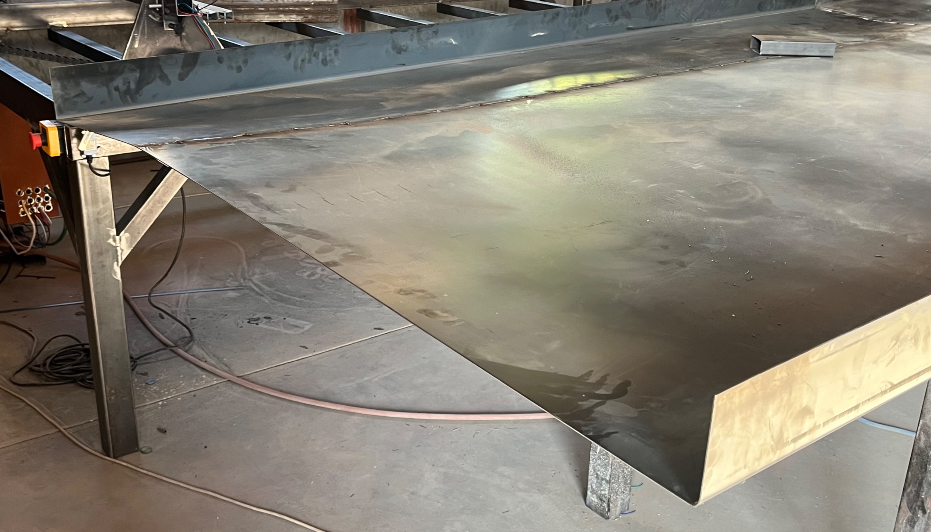

So far the building of the machine was all much easier than I expected.
But welding the water table is a big challenge.
Since I could not find a peace of sheet metal l large enough it is all warping up. And as it is now it is not usable. I would appreciate any advice on how to get those sheets straight again.

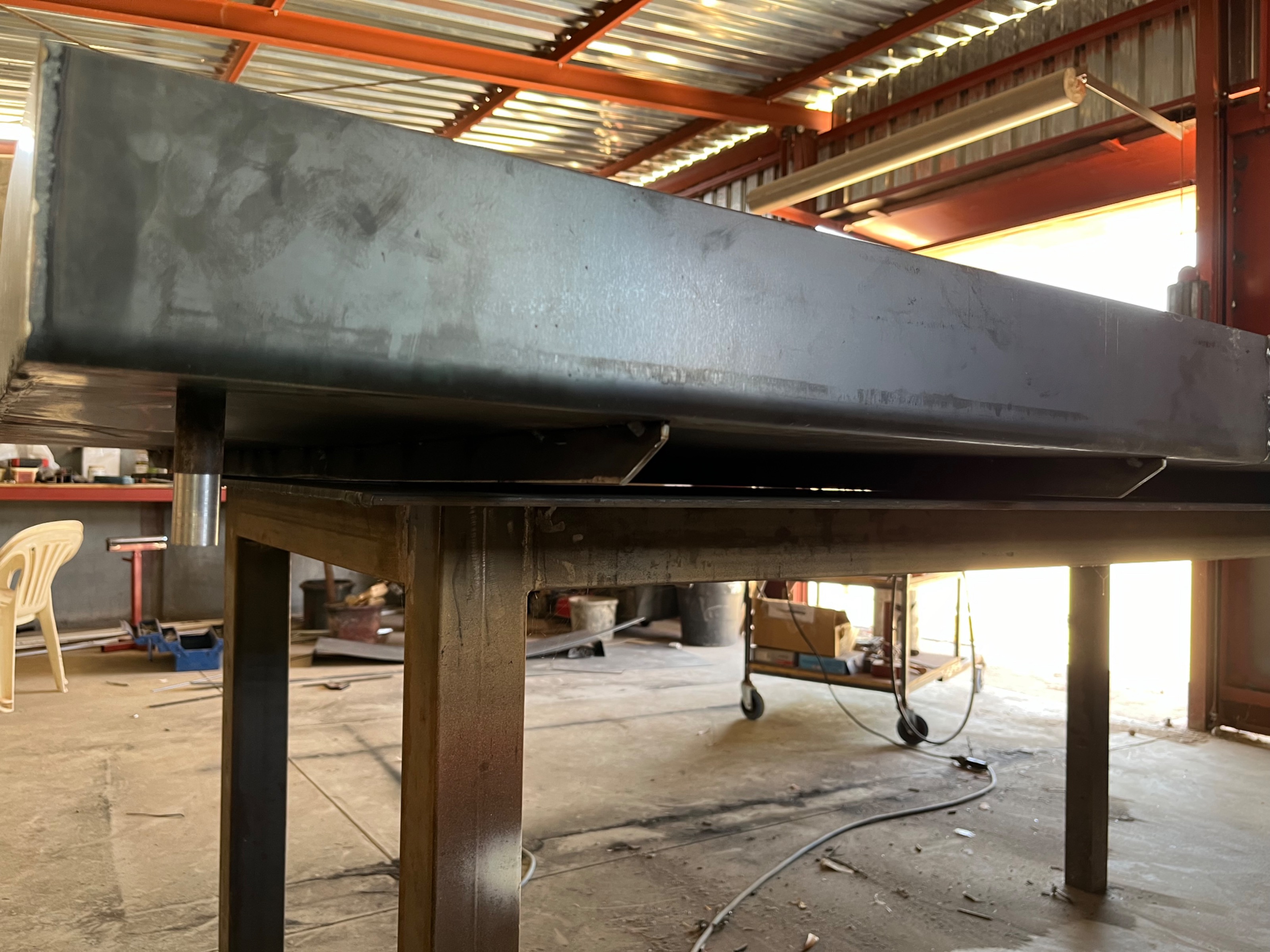

I got the water tray into an acceptable condition.
I removed the problem welds and
welded some slats underneath to straighten things out. (The sheets had a radius when they came back from bending)
Then I re welded them..
Next time I would cut them in such a way that seems will be shorter and all in the same direction. I hope this post will help some others hobby welders avoid the same problems.

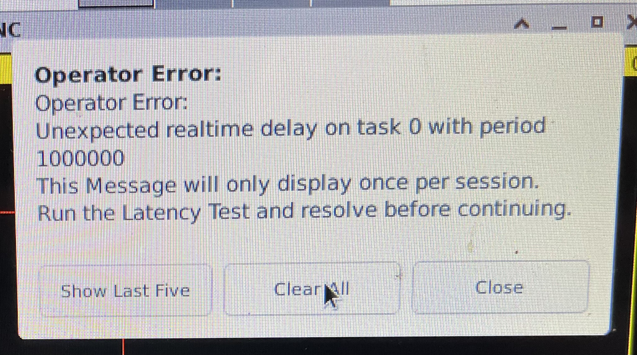

26 Sep 2024 14:15 - 26 Sep 2024 14:19 #310849
by Creative25
Replied by Creative25 on topic Building a chain driven Plasma table.
Last edit: 26 Sep 2024 14:19 by Creative25.
- Posts: 18122
- Thank you received: 5337
26 Sep 2024 15:57 #310855
Replied by PCW on topic Building a chain driven Plasma table.
That means the host computer has a latency issue of some kind
Common causes:
Power management/speed-step/Turbo modes/C states >C1 enabled in BIOS
Network hardware issues with Ethernet connected cards
With Intel MACs you need to disable IRQ coalescing (man hm2_eth)
With Realtek MACs and the LinuxCNC buster release you may need to install
the DKMS RTK8168 driver as the driver included with the shipped kernel is broken
Common causes:

27 Sep 2024 00:35 #310877
by Creative25
Thanks for the info.
Mine is an Intel MacBook 2012
Could you point me to some info on how to disable IRQ?
