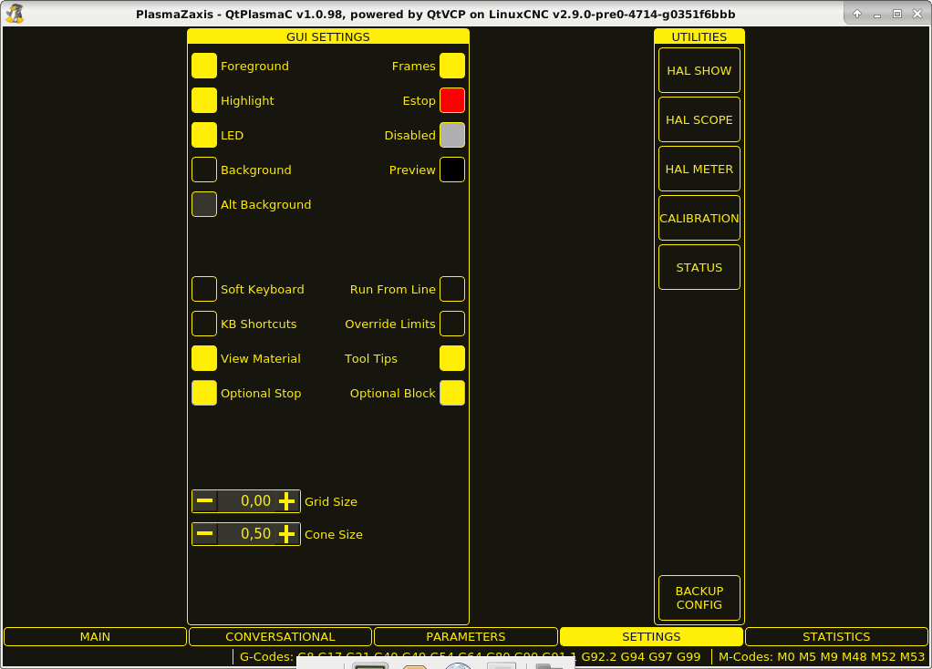

Replied by Creative25 on topic Building a chain driven Plasma table.
Which Preferences?
On Qtplasmac I only find settings etc.
Or am I missing something?

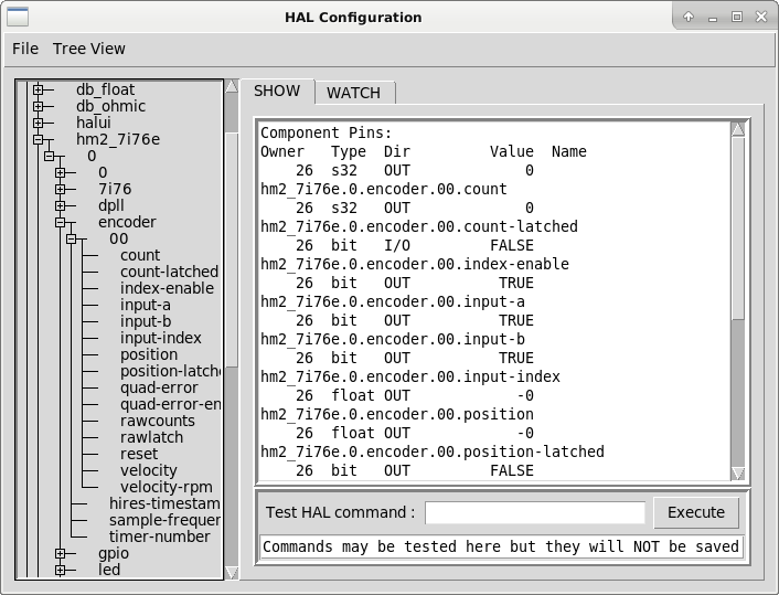

09 Oct 2021 19:42 #222705
Replied by rodw on topic Building a chain driven Plasma table.
Upload your ini file please.
If the light is blinking faster, the THCAD is working. I would say you have not properly configured your encoder.
FInd the encoder velocity pin for your mesa card in halshow and if it is 0, thats the issue

10 Oct 2021 16:30 #222799
by Creative25
I just did an experiment
I changed the jumpers to F/32
And also the settings in pncconf
Now it just shows random numbers.
Just seems to be counting until it starts from zero again.
If I check it in hal meter the numbers jump between negative and positive numbers.
Is the counter supposed to reset so you get a frequency?
- Posts: 12178
- Thank you received: 4155
11 Oct 2021 06:40 #222847
I suspect you are probably missing this from your hal file
Your are in the right place but its encoder.00.velocity you need to be watching on the watch tab.
# --- 7i76e ENCODER SETUP ---
setp hm2_7i76e.0.encoder.00.scale -1
setp hm2_7i76e.0.encoder.00.counter-mode 1Your are in the right place but its encoder.00.velocity you need to be watching on the watch tab.
