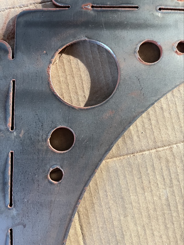

05 Oct 2024 11:21 - 05 Oct 2024 12:11 #311356 by Creative25
Replied by Creative25 on topic Building a chain driven Plasma table.
  So I thought I will share a bit about my chain driven machine. I learned it is possible to make a good machine that is chain driven. it has its own advantages and disadvantages. I found after dealing with all the plays of gears on shafts. Dealing with gears that don’t run true. I have a machine with zero backlash. it runs quiet hardly any chain noise except when moving long distances on maximum speeds.  Also the bearings running on a rectangular tube has no issues. Only issue I have is that the X axis flexes a bit when the machine stops suddenly that’s why I reduced the acceleration to 750 mm. The shaking originates from the flexing of the two side plates of the Gantry during hard acceleration. So I will redesign them to make them lighter and more rigid. Hole cutting has improved a lot. But there is still more I can do.

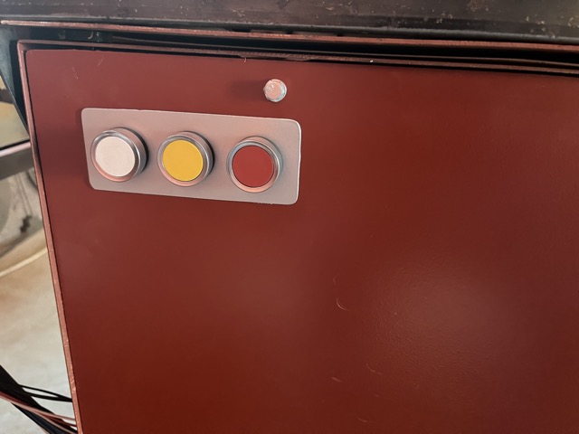

05 Oct 2024 12:24 - 05 Oct 2024 12:27 #311361 by Creative25
I have added some buttons to the control box.  But it seems Qtplasmac just ignores them. I have configured them with pncconf.
In halshow I can see that the machine reads them. But that’s all if I press the white button that is configured to start a cycle nothing happens. Are there more things that I need to configure so that the button will work?
Is there any tutorial about adding physical buttons?

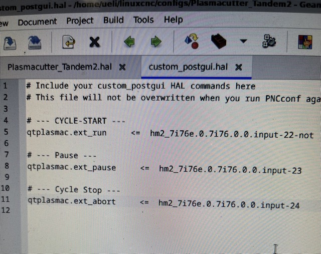

05 Oct 2024 23:59 #311388 by Creative25
So basically pncconfig does not do configurations that are specific to qtplasmac.
Could I move the appropriate lines for these buttons from my Hal file to the postguy halfile. And just replace the pins that pncconfig created with the appropriate Qtplasmac external Hal pins?
06 Oct 2024 00:22 #311389 by phillc54
Replied by phillc54 on topic Building a chain driven Plasma table.
PNCconf has not been taught anything about the external HAL pins.
Yes, that should work fine.
The following user(s) said Thank You: Creative25
06 Oct 2024 11:52 #311418 by Creative25
  Is this the way my postgui Hal should look like?
