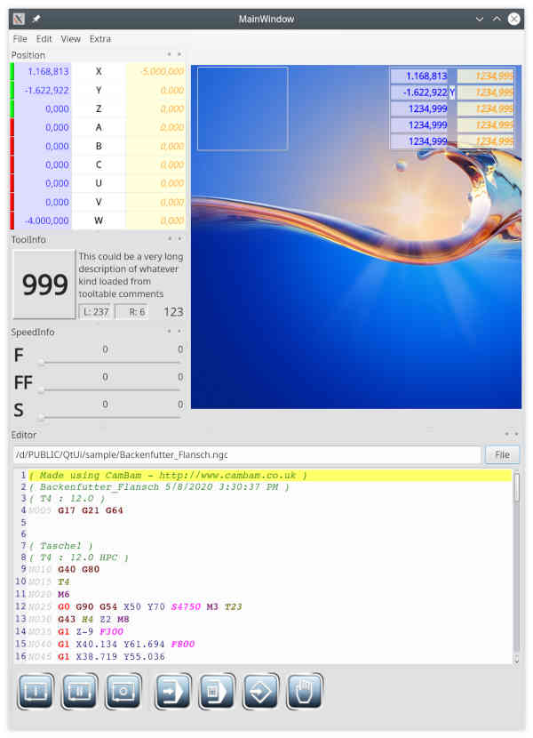

I very estimate your work, but I'm no friend of collapsed strings to paint over whatever.
I'm a friend of strict decoupling model from view.
I just published my wip so you can look what I mean.
DxfView is derived from your simple_cam and extended to show 3D dxf files as written by freecad.
QtUi is the source of above screenshots. A combined widget to handle all tasks around dro
Recently I have started to work out a gcode viewer/editor ...
I added some of your grafic widget properties to DxfView. When you load a 3D dxf file, you can play with menu entries to see live changes.
I did quite a lot of changes to the dxf layers and to your opencascade widget.
Hope you find it useful.

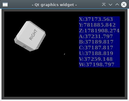

* but I'm no friend of collapsed strings to paint over whatever.
Yes, that's something to discuss.
For today i will let the dro text as it is. The basic code (proof of concept) for showing dro's works.
The widget overlay is done outside of qt. Qt cannot do the transparant overlay properly on a opencascade widget.
There was a discussion somewhere that also mentioned that. It can be done by a complex solution, but i stay away from that.
The dro text is now done by opencascade itself trough a simple "textlabel" way and showing it's position as the trihedron cubic does.
Now i will try to include a nml header file to get the dro values from lcnc.
But for a universal widget, we not alway's read the values this way. Hal-core will read the dro's trough hal.

But instead of collapsing all dros into a single string, it could probably be possible, to simulate different labels. If you look at axis, there are plenty of dros and I'm sure, not every user wants all that dros.
So to get it configurable, the best way *imho* is to treat each value as different element. Such element will have a position, a font and a forground and background color.
Painting could stil be performed by opencascade. Just have some elements, that listen to update events.

Hi Reinhard,
Yes we will do it that way you suggested.
Currenty implemented as QProperty:
OpencascadeWidget->setProperty("property_background_color", 0);
OpencascadeWidget->setProperty("property_show_orthographic_or_perspective", 1);
OpencascadeWidget->setProperty("property_view_front", 1);
OpencascadeWidget->setProperty("property_view_back", 1);
OpencascadeWidget->setProperty("property_view_top", 1);
OpencascadeWidget->setProperty("property_view_bottom", 1);
OpencascadeWidget->setProperty("property_view_left", 1);
OpencascadeWidget->setProperty("property_view_right", 1);
OpencascadeWidget->setProperty("property_view_wireframe_or_shaded", 1);
OpencascadeWidget->setProperty("property_zoom_all", 1);
OpencascadeWidget->setProperty("property_erase_all", 0);
OpencascadeWidget->setProperty("property_hide_or_show_triedron", 0);
OpencascadeWidget->setProperty("property_show_interactive_3d_box", 1);
To be reviewed:
OpencascadeWidget->setProperty("property_show_dro", dro_result);

What you think: if you spend more time in opencascade research, I could do the nml task for you.

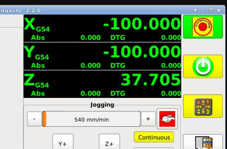

That looks very good. DROs Numbers are usually right side justified with fixed length fractional part.

* I wonder if it is possible to overlay a separate DRO widget on top of the graphics display? That would be very flexible but I'm * * not sure if getting it to work with resizing would be difficult.
Just created a second opencascade interactive context. Each context can show it's own stuff on the screen. Tested ok.
For example, the m_context_dro holds all the dro info. This context is not hightlighted anymore by mouse hover.
- Handle(AIS_InteractiveContext) m_context, m_context_dro;

Just got the label background color working. Now steaming up to "limit switch tripped" and "home" icons for each axis.

I played a bit with Qt and I just succeeded in creating working Qt-overlays:
That app is designed for dockables around a center widget (where graphic widget would be added). Currently the center widget acts like a stack of displays, which can be switched by applications main menu.
The dockable dro already can change number of shown axis by axismask and left dro column can switch between absolute and relative.
The overlay is just a simple test, but the features from dockable could be implemented for overlay too.
If you like to play with the sources: github.com/DjangoReinhard/QtUi

Hi Reinhard,
Nice work !
Yust checked your app. It run's nice !
Have a look at the dxf viewer, pull request.
You gcode textbox looks very nice with this colors.
The widget overlay will indeed work nice between qt widgets.

I will try to create a type dro like this :
To this dro we can apply the properties :
- icon limit switch triggered
- icon homed
- transparancy level (0 to 1)
- background color (enum color) or background picture (file.png)
- textcolor (enum color)
- text font ("arial" etc)
- screen position (x,y).
- 7 or more configurable input fields ( as shown in picture )
- Create a vector (=user defined ammount) of dro's[x] when opencascade widget is loading.
To the main widget we add :
- set background image (file.png) or set background color (enum)
I will give it a go. Maybe the result is cool !
