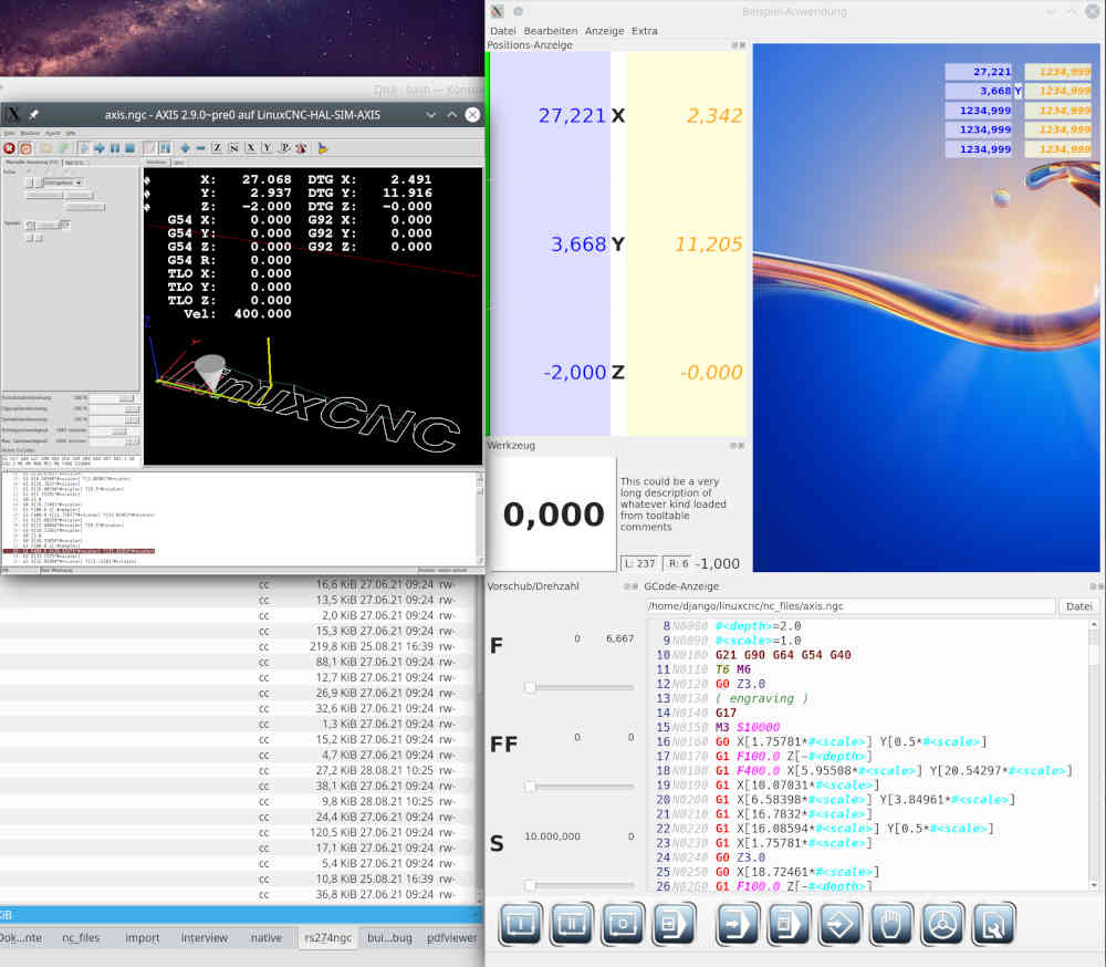

I just publish my work around nml abstraction. StatusReader is currently disabled - until I figure out, how to add the dependencies to qmake/qtcreator definitions ...
Anyway - mocking positions run through the same path of abstraction and you can see, that StatusReader does not know anything about the visual client. Visual clients don't know anything about StatusReader or about another widget, which uses the same variables ...
... and for those that don't know: dockables are widgets, that can be placed side by side. But they can be arranged on top of each other too, so its already a working notebook widget ...

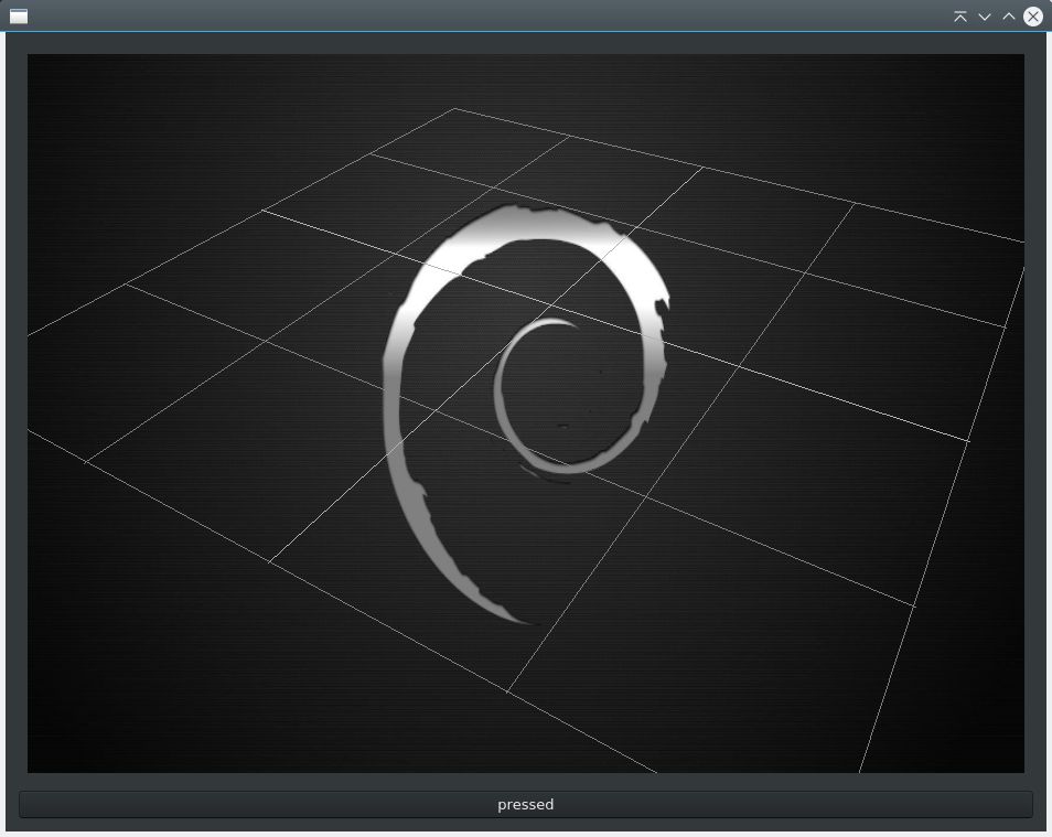

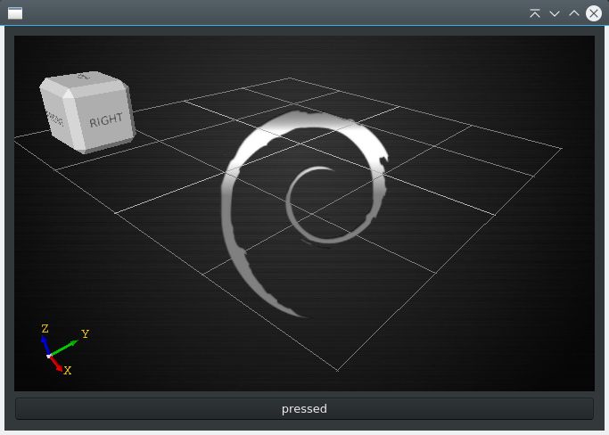

Hi Chris,
Attached my latest example, inluding python modules.
I think this example will run directly if a user has the opencascade.deb is installed.
I cleaned up some more code. And added the "current available" property list to the ./runtest.py file.
This is for me a nice starting point to go on with.
About things todo.
About the dro's. How are you thinking about updating dro values from hal?
I could let the c++ side setup a component with the halpins to connect.
Or will you be more satisfied if dro values are updated trough nml?
I think doing it trough hal is the most powerfull one. Users can also display totally different hal values instead of a dro value.
If i make the textlabels universal, they can in fact display any text users want to.
Please let me know how you think about this. For hal-core it's the best solution, and it's the solution without any spagetti code and
has a lower memory load related to nml.

#!/usr/bin/env python3
# -*- coding:utf-8 -*-
import os
import platform
import sys
import ctypes
from PyQt5 import QtCore
from PyQt5.QtCore import *
from PyQt5.QtWidgets import *
from PyQt5.QtGui import *
from PyOpencascade import Opencascade
class Runtest(QWidget):
def __init__(self):
QWidget.__init__(self)
self.layout = QVBoxLayout(self)
self.occ = Opencascade()
self.layout.addWidget(self.occ)
self.button=QPushButton('Python is working!')
self.layout.addWidget(self.button)
self.button.clicked.connect(self.my_push)
# Extern "C"
# self.test=ctypes.CDLL('/yourpath/aLib.so')
# self.test.load() # Where load() is a function name of the loaded .so lib
def my_push(self):
property_id_0 = "property_background_picture"
property_value_0 = "/home/user/Qt_graphics_universal_widget/libpython/Qt_Occ_Python/Debian_Wallpaper.jpg"
self.occ.setProperty(property_id_0, property_value_0)
property_id_1 = "property_show_interactive_3d_box"
property_value_1 = 1
self.occ.setProperty(property_id_1, property_value_1)
property_id_2 = "property_hide_or_show_triedron"
property_value_2 = 1
self.occ.setProperty(property_id_2, property_value_2)
property_id_3 = "property_show_orthographic_or_perspective"
property_value_3 = 1
self.occ.setProperty(property_id_3, property_value_3)
property_id_4 = "property_view_wireframe_or_shaded"
property_value_4 = 1
self.occ.setProperty(property_id_4, property_value_4)
self.button.setText("pressed");
if __name__ == "__main__":
app = QApplication([])
main = Runtest()
main.show()
sys.exit(app.exec_())
