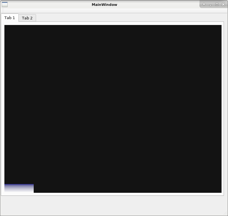

Have you seen this effect with the qt_occ screen ?
The little image in the lower left corner.
I don't know why you are asking this. Gradient and shades can be drawn with opencascade. It could also be
showing a failure.

sorry- more accurat.
I think that background window is showing up with that little image in the lower left corner.
That little image expands as soon as I resize the window. ( occQt-sample ).
The error is " Window Visual is incomplete: no depth buffer, no stencil buffer."
I was trying to build a absolut minimum occ window into that tab. No luck so far.
One more question: for how long did you have the graphics-Widget running at any given time.
As soon as I start to update the values, it's eating up memory and then eventually crashes. HTOP.

In the c++ examples you can see how the occ window is initialized only once it's loaded. This is done to set the screensize etc.
github.com/grotius-cnc/universal_graphic...t/releases/tag/1.0.0
Hi, i suspect you are creating multiple nml instances ("nml=new nml" ) over a period of time until it crashes.
In the above archive there is a nml example.

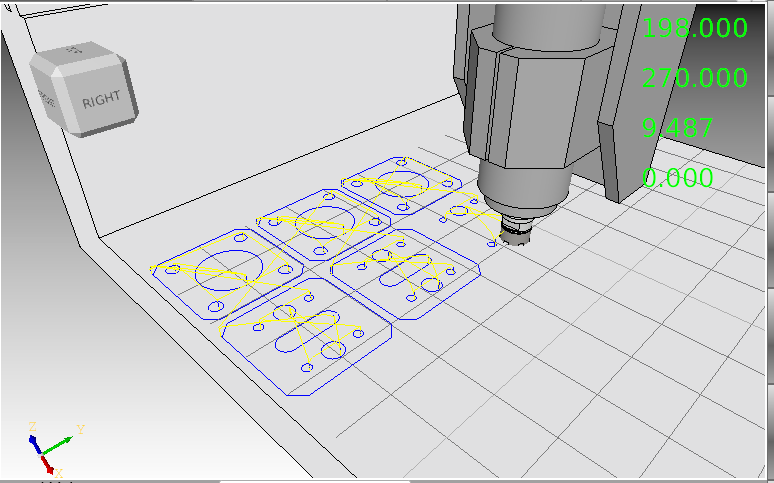

At present I try to implement a path-view.
The problem I have is that I get a real big amount of edges/wires to display.
If I use your g-code sample with a update rate of 50msec that piles up to some 20.000 chunks.
Here is the Code;

Is the problem to display 20.000 lines of gcode with opencascade ?
Running out of memory?
