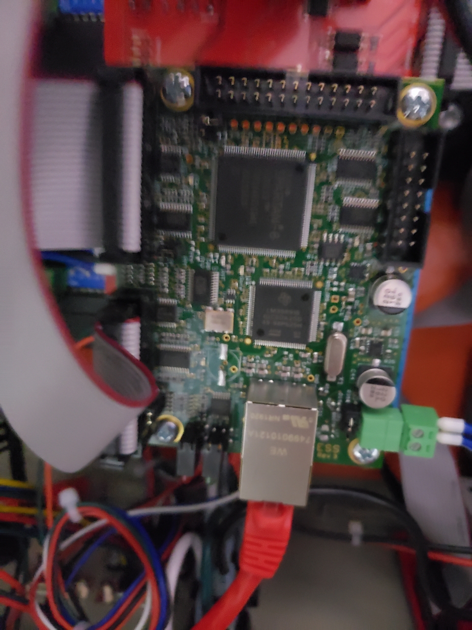

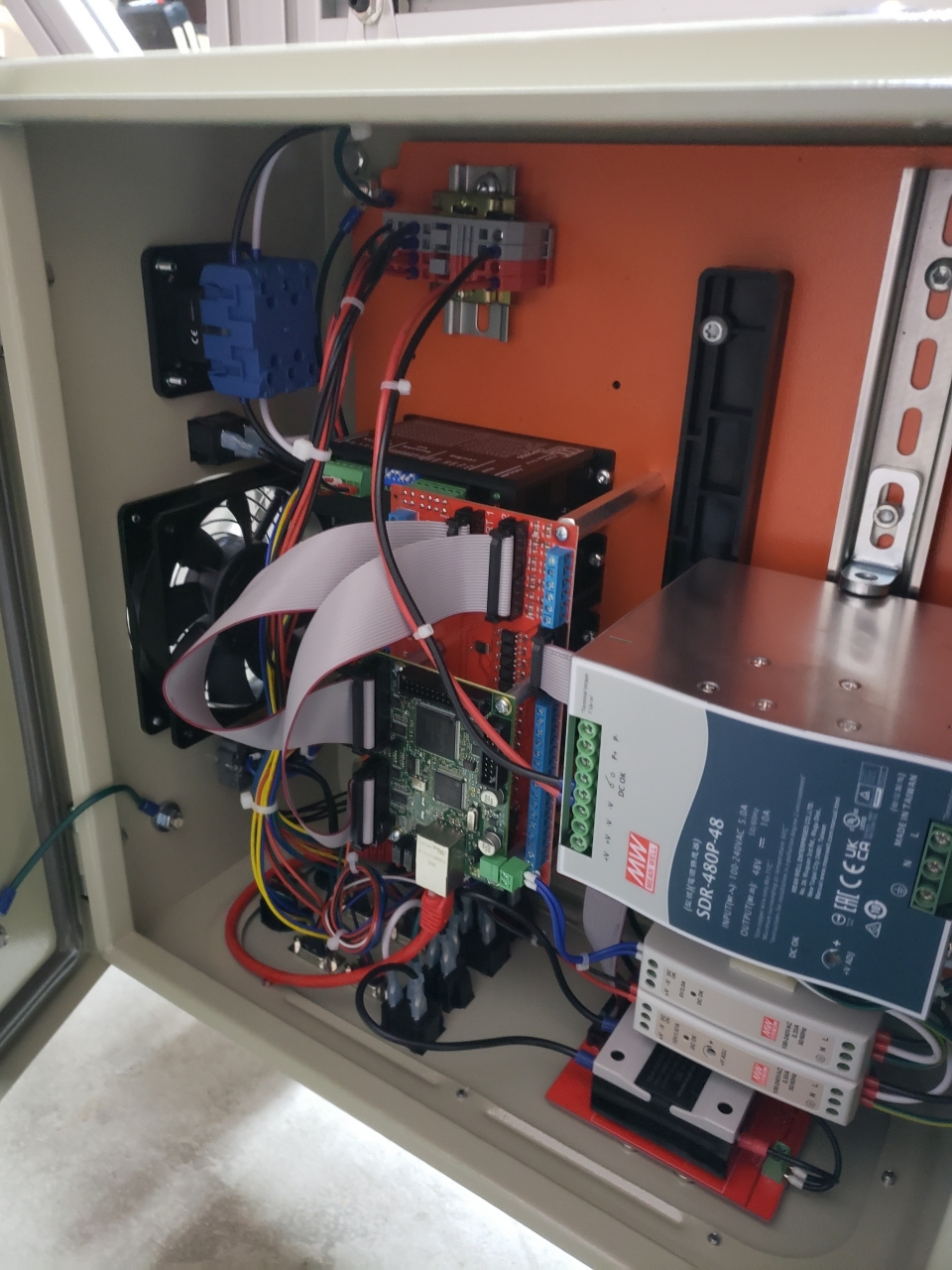

Hi need advice just purchased my first cnc (avidcnc) and with the plug and play eletronics at the moment its setup up for Mach4 but havent purchaesed it .Was interested in switching over to linuxcnc , I contacted Mesa through email but not getting any detail info but was told to use the 7192H so I can keep the BOB thats included without doing any rewiring .Any help advice would be really appreciated on how and what info I need ?
Thanks Fred
Thanks Fred
- Online
- Posts: 21757
- Thank you received: 7433
07 Jan 2022 21:29 #231059
Replied by tommylight on topic Avidcnc retrofit Mesa 7192H
Pictures of connectors ???

Purchased the 7192H Peter at Mesa sent me bitfile to work with the Bob, but unfortunately trying to find information how to load it to linuxcnc.
- Online
- Posts: 21757
09 Jan 2022 09:25 #231226
Read the 7i92 manual and replace the .bit file name to the name of the bit file PCW sent you:
forum.linuxcnc.org/30-cnc-machines/44700...ofit?start=10#231041
