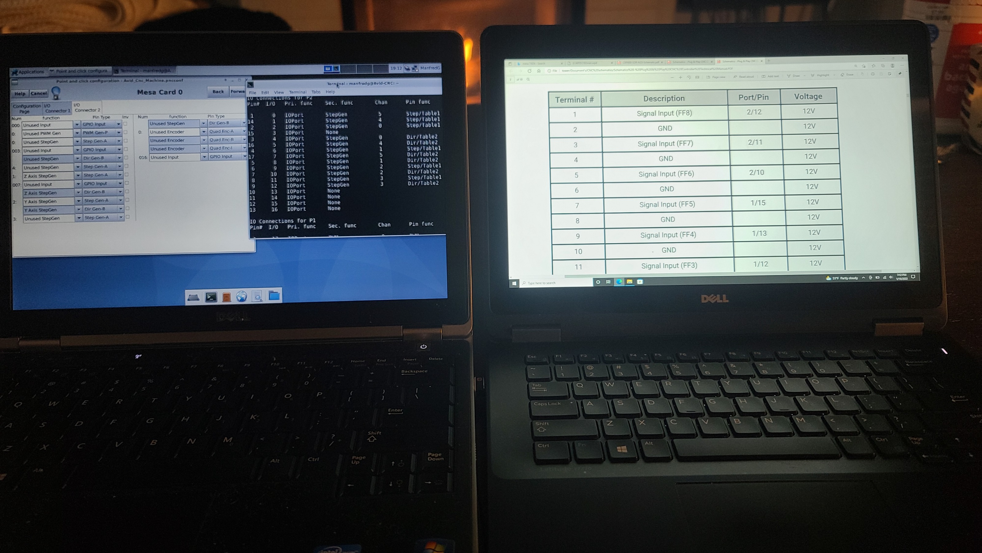

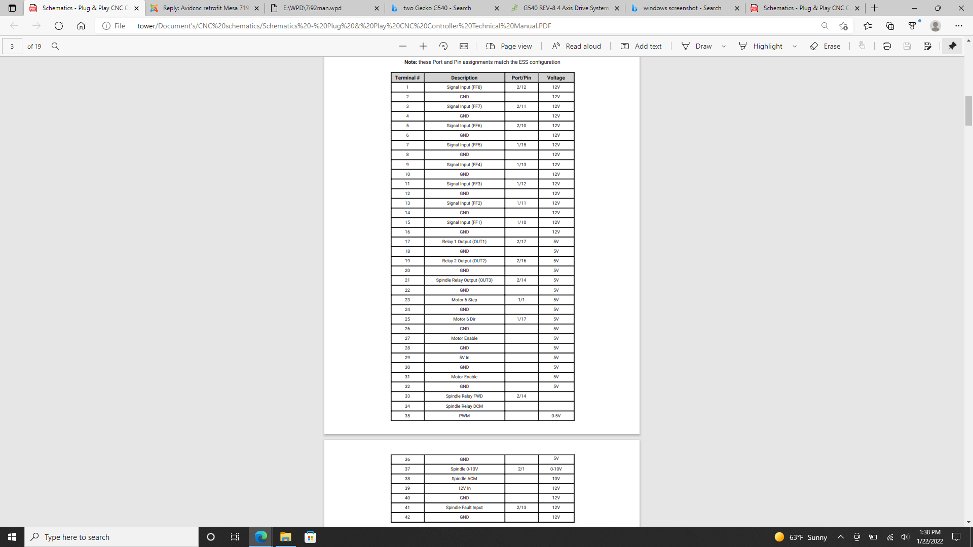

22 Jan 2022 21:07 #232823
by Fastfred
Replied by Fastfred on topic Avidcnc retrofit Mesa 7192H
I thought I had it figured out , there is a second pinout from avidcnc that says its not part of the ess config.Still dont have a understanding of whats going on .
- Posts: 18080
- Thank you received: 5316
22 Jan 2022 21:16 #232825
Replied by PCW on topic Avidcnc retrofit Mesa 7192H
Those are the external BOB connections to the machine, not the ESS <--> BOB connections

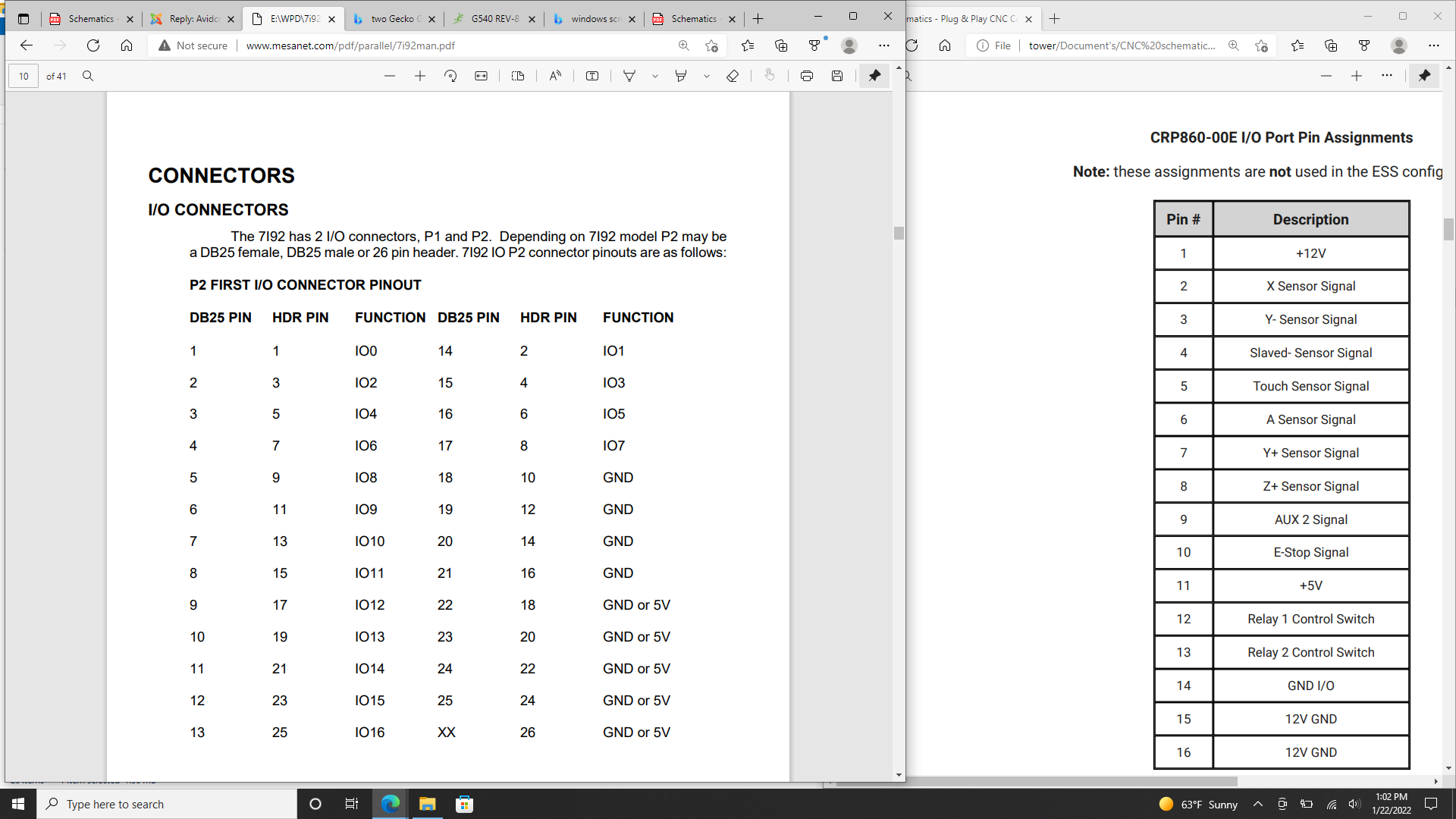

22 Jan 2022 21:43 #232834
by Fastfred
Ok I have a lot to learn. On this screen shot looks like 1 through 16 are nothing to worry about according to avid it for future use. and the rest is terminal # to DB pin I/O of the mesa board?
- Fastfred
- Posts: 61
23 Jan 2022 00:03 #232843
by Fastfred
I also wanted to ask the firmware using is setup for two G540 with 4 drives each how does that work for my setup ?
- Posts: 18080
23 Jan 2022 00:15 #232845
The "Port/Pin" column is the Mesa DB25 pin number
(7I92 P1 = Port2, 7I92 P2 = Port1)
