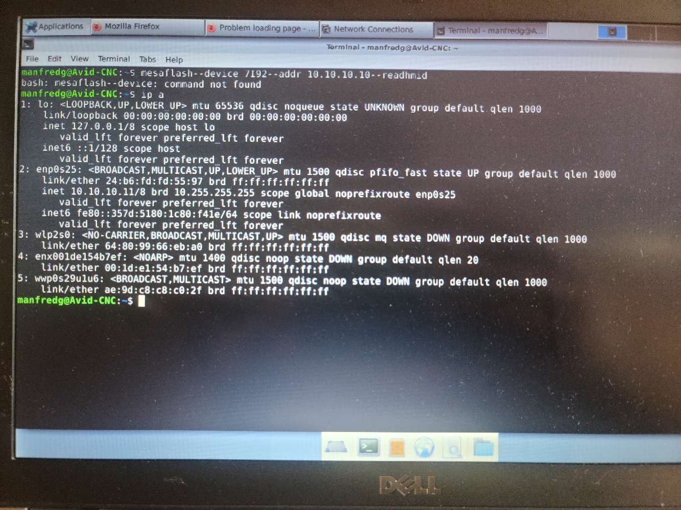

Yeah maybe it is installed by default and it's the lack of space in "mesaflash--device" that's the problem.

Ip a

Ok back to were I was before I can connect to the mesa card , ping it but when I try to use msaflash no luck .I was able to confirm mesaflash is installed.

Replied by PCW on topic Avidcnc retrofit Mesa 7192H
What does the command:
ip a
report?
ip a
report?

You have the command mesaflash--device, not mesaflash
The command should be:
mesaflash --device 7i92 --addr 10.10.10.10 --readhmid

I was able to read the card now (Thank You )
Now have to write bitfile can the file be on desktop or a specific location.?
