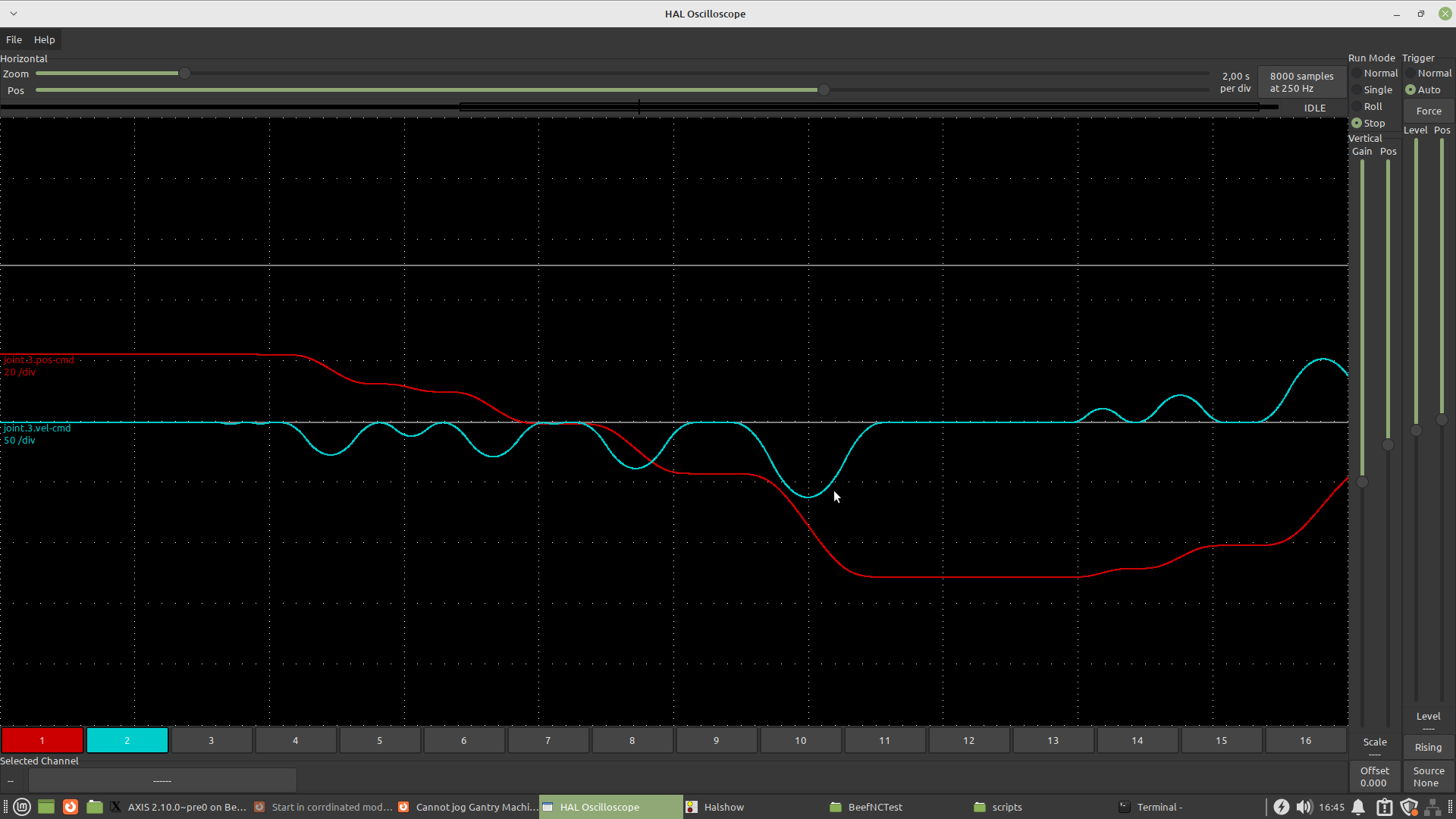

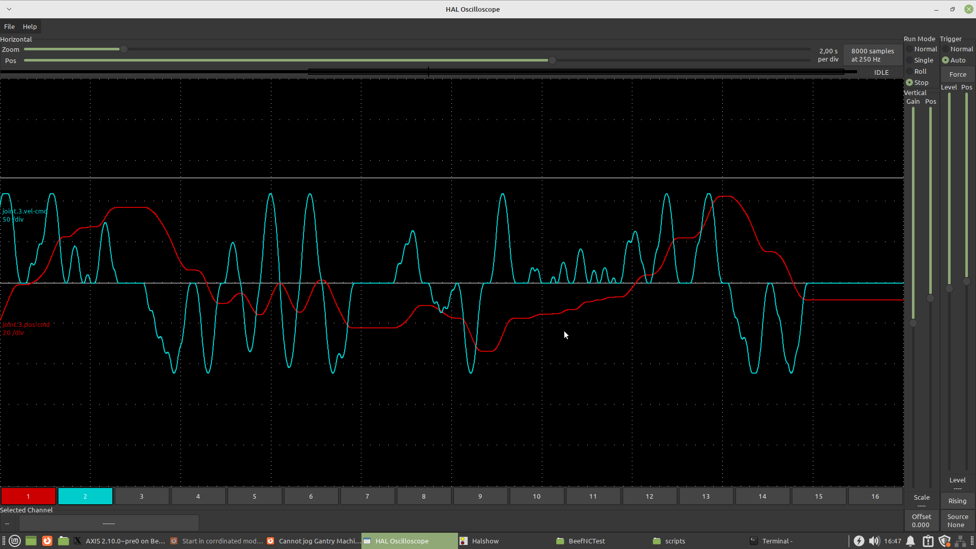

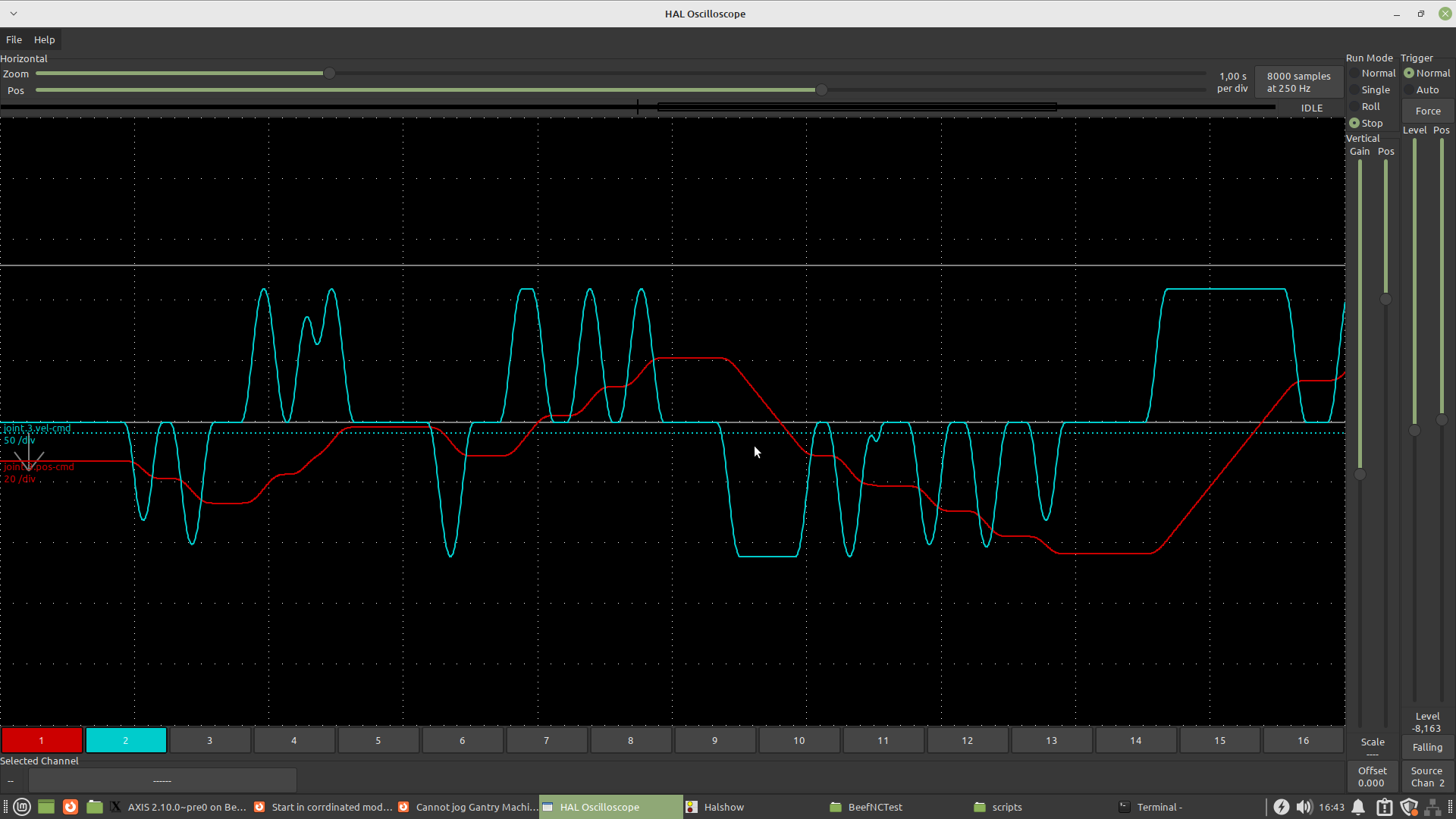

17 Oct 2023 15:48 - 17 Oct 2023 15:51 #283187 by Beef
Replied by Beef on topic Trajectory Planner using Ruckig Lib
Took me an extra couple of days than I hoped fighting joint vs coordinated mode and some other issues since I've got an XYYZ machine on a mesa card, so unfortunately I only have Z to show at the moment, but it runs!
I will have some more videos available soon as we continue to resolve some of the outlying issues, but you can see the results of some various jerk values that (as Grotius said) initialized through .ini but are HAL pins so can be changed on the fly.
HALscope outputs are attached (also in the same Testing_TEMP on github ... i'll remove this down the road)
github.com/TheRealBeef/LinuxCNC-CMake/bl...Testing_TEMP/low.mp4
github.com/TheRealBeef/LinuxCNC-CMake/bl...Testing_TEMP/med.mp4
github.com/TheRealBeef/LinuxCNC-CMake/bl...esting_TEMP/high.mp4
Hopefully we have more to show soon, and of course once I sort out teleop (or am brave enough to home this thing) I will come back with a better video demonstrating the trapezoidal vs s-curve and some more documentation.
