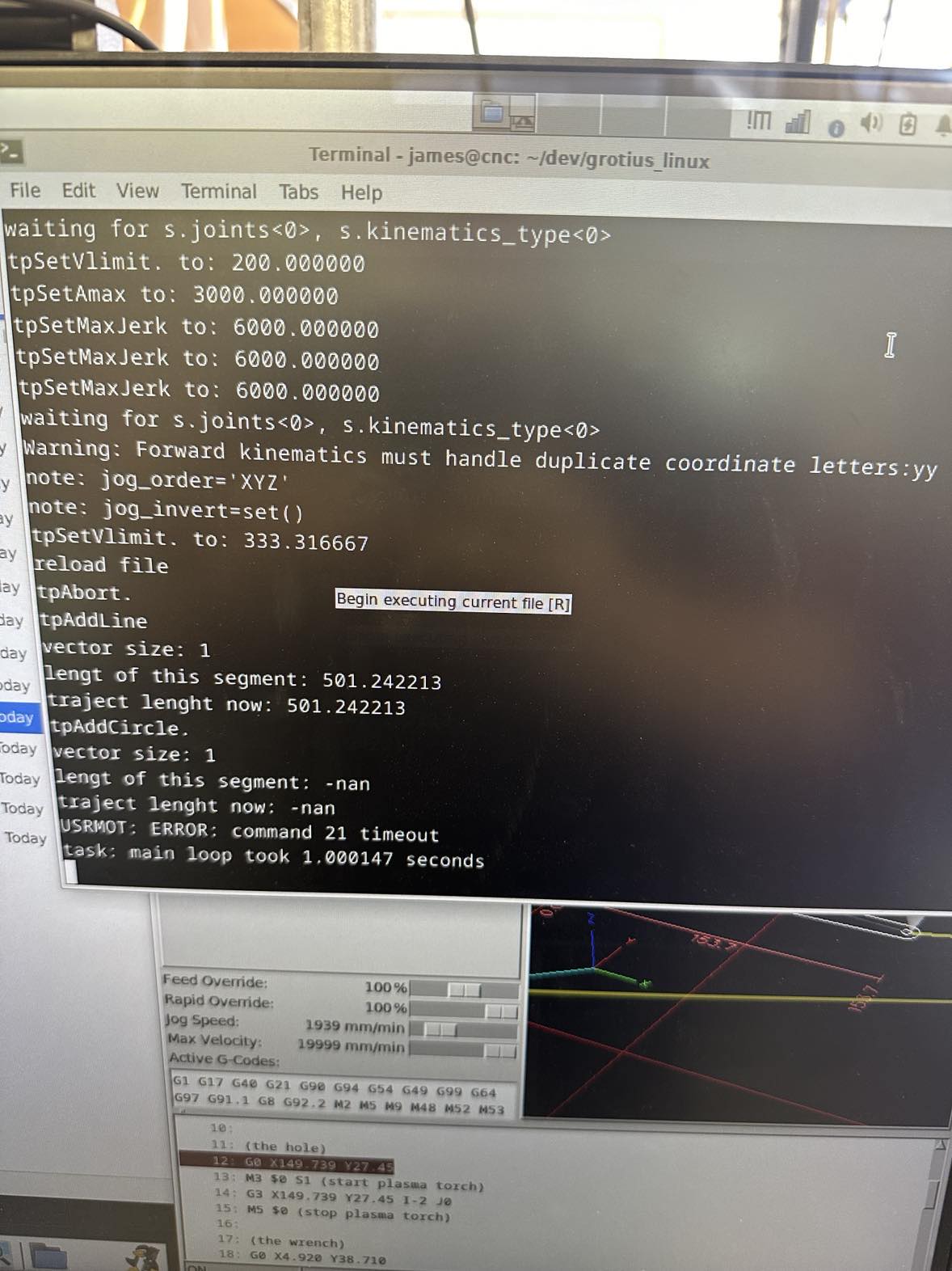

Hi Joco,
Sooo impressed with what is being done here!
Thank you very much !
It's not easy.
I am trying to get a test machine set up to actually try this on real hardware.
Ok that would be nice !
I hope you can see the scurve magic on real hardware soon.
Did another test with a plasma file. Not 100% ok, but good for now.
It's not easy.

08 Nov 2023 21:36 - 08 Nov 2023 21:52 #284914
by Joco
Replied by Joco on topic Trajectory Planner using Ruckig Lib
Some testing done.
Linucnc plasma test file, Metric Spanner. Acceleration 3000mm/s/s, Feed rate 7000mm/min. max_jerk=6000
Standard Planner
Notice the vibration in the torch head from the sharp changes at high acceleration.
S-Curve
Notice the pauses at various points. These are very bad for plasma and on spinning tooling (mills) will cause rubbing and will dull tools.
S-Curve freezing - requiring power cycle of mesa card and PC to get working again:
please let me know what else I can look at or if you need some kind of logs captured
cheers - J
Standard Planner
S-Curve
cheers - J
Last edit: 08 Nov 2023 21:52 by Joco.

09 Nov 2023 04:06 - 09 Nov 2023 04:06 #284926
Replied by rodw on topic Trajectory Planner using Ruckig Lib
In your screen dump I noticed nan = not a number so perhaps a null pointer has been passed.
I was a bit disappointed with the pauses when cutting. I suspect that they may be due to our implementation. The Plasmac spanner is a very simple file.
