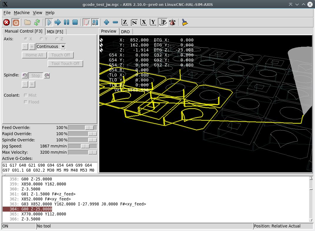

This might well have been solved. But he issue happened immediately after the completion of the first G0 in the wrench test file in my last post. It did a rapid to the Hole locaiton in the file then stalled.@Joco,

More testing. I managed to come up with a way to get the standard gcode file @Grotius was using and it into a dxf that I could manipulate in sheetcam to fill out a larger area. Then generate back into gcode.
Test file in use:
I have run this file under standard tp in 2.9 and 2.10pre. Works fine.
Under scurve it throws an error pretty much immediately. Attached log has all the deails.
But here is the snippet for the relvant issue (I believe):
Cheers - J.
Test file in use:
tpSetVlimit. to: 333.316667
line startpoint x: 625.000000, y: 300.000000, z: -25.000000
line endpoint x: 625.000000, y: 300.000000, z: -25.000000
line startpoint x: 190.000000, y: 162.000000, z: -25.000000
line endpoint x: 190.000000, y: 162.000000, z: -25.000000
line startpoint USRMOT: ERROR: invalid command
can't add circular move at line 21, error code -1
waiting for s.joints<0>, s.kinematics_type<0>Cheers - J.

Hi Joco,
Thanks for your detailled error report.
The gcode file is from cam repository : github.com/grotius-cnc/cam/blob/main/gcode.ngc
I added your modified gcode_test_jw.ngc to the source. And opened the file in axis. Then press run after home,
and error reproduced indeed.
tpAddCircle.
vector size: 6
lengt of this segment: -nan
traject lenght now: -nan
arc startpoint x: 192.000000, y: 162.000000, z: -1.500000
arc endpoint x: 192.000000, y: 162.000000, z: -1.500000
arc center x: 164.000200, y: 162.000000, z: -1.500000
It's obvious, the arc has the same start- & endpoint, wich results in a isnan output for arc lenght in this case.
So i can do 2 things here.
tpAddCircle.
vector size: 6
- Change it into a line when start & end are the same.
- Filter out this segment, trow it away
The following user(s) said Thank You: akb1212

So line 21 is: G03 X192.0000 Y162.0000 I-27.9998 J0.0000 F#<xy_feed>
This essentially a circle. Use ncviewer.com/ to step through the code file. Really useful to visualise what is happening where.
Are you factoring the fact the fact that the arc at this line is in fact a circle or is something happening under the hood which is causing this to happen as a result of what is being produced by the ruckig library?

The isnan is fixed by changing isnan to 0 output. So segment's are just there, segment lenght is set to zero.
To inform you where in the source this is done :
github.com/grotius-cnc/linuxcnc/blob/884.../tp/tp_lines.cpp#L89
github.com/grotius-cnc/linuxcnc/blob/884.../tp/tp_arcs.cpp#L233
Github is updated.
Joco, it seems the rapids are below the workpiece. But the file run's oke now.

Thanks - yeah its a hack as I can't set WCS to be able to have positive upward Z moves.
Normally Z would be removed on my plasma as that is all under plasmac control. Once WCS can be set then will change. OR is it ok to kill off Z moves entirley? For the purposes of this test file.
