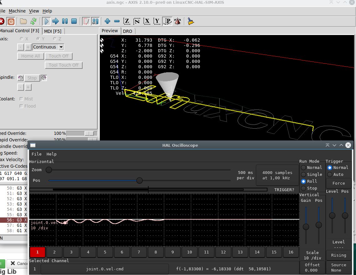

26 Oct 2023 15:12 #283876
by Grotius
Replied by Grotius on topic Trajectory Planner using Ruckig Lib
A little update.
The scurve trajectory planner works for each segment (gcode arc or line).
It start's and stops each segment, doing a scurve motion profile.
Pause and resume works, stop doesn't work for now. No blending for now.
github is updated: link to code
A little update.
The following user(s) said Thank You: akb1212, tommylight, Clive S, tivoi, pommen, rodw, Joco, DHeineck, Beef, nwallace
- Grotius
- Posts: 2419
- Thank you received: 2349
28 Oct 2023 09:19 - 28 Oct 2023 09:20 #283962
by Grotius
I had to do some research to find out how the trajectory planner must behave, and how to avoid lcnc freezing during
switching auto, mdi, manual. This all is because i did'nt know or see the correct program flow.
When things are unclear, strange error's occur etc.
All of this is related how the pre-defined trajectory planner function's are used or must be used.
There is not really a explanation for it. So you are on your own.
To overcome this know-how problem i made a minimal coded trajectory template component : tp_template.c
Now this file compiles to the component : tp_template.so wich can be loaded in the ini file under the [TRAJ] section.
Now we have a working trajectory template component, that rules out wrong usage i had done before.
Most of the problems where related to tpIsDone . And how to use it.
Ok, now i can go finish the scurve component, add the stop sequence.
Test some mdi moves etc. Hopely now it will go good !

29 Oct 2023 09:57 #284027
by Grotius
Hi Guys,
The trajectory planner is more or less working without issue's now.
Different mode's mdi, manual, auto and switching between them goes ok.
In auto mode the program does a scurve motion start & stop for each gcode line or arc.
It would be nice if a few can test the code offline & online.
Made a release for this status : github.com/grotius-cnc/linuxcnc/releases/tag/1.1
What to code next?
What to code next?
