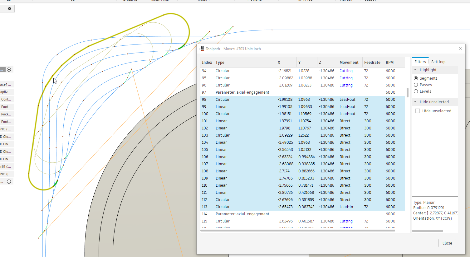

The fillets are working.
Options during program run :
- use fillets or chamfers.
- Set a G0 fillet size. The rapids can also do fillets.
- Set a G1_G2_G3 fillet size.
So what i learned so far is :
When lcnc loads the gcode line by line at runtime, i add one emtpy line after each loaded segment.
During the program run, buffer is also emptied and new lines are added when using bigger programs.
Then when loading is finished and program run's, it just run's over the empty lines.
Then at runtime the fillets are calculated by the 3d cavalier algo.
It only creates a fillet for your current line & next line.
So it does not fillet the whole path in the same plane, as this would be very nice.
This is too compute expensive to fit in the cycletime and a lcnc signal eleven will occur.
So to minimize the computations, i only did one fillet at a time.
The 3d cavalier algo creates a plane from the current 2 gcode lines. Then it projects the 2 lines to a top view plane,
called the zero plane.
Then in top view the 2d cavalier algo is performed. When this is done, the 3 lines (including fillet) are transformed back
to original position. I think this is a clever method, also for future curves like clothiods etc.
Have fun to watch the fillets at work. Also switching to chamfers & using different fillet values at runtime.

Regarding toolpath smothing using clothoids in CNC application. I've posted this before in another thread but the link there seems broken so here it is again:
www.researchgate.net/publication/3318941...cf4408a7c0c/download

Found a nice lib, github.com/ebertolazzi/G1fitting.
This is from university.G1 fitting with clothoidsby Enrico Bertolazzi and Marco FregoWe are now a few commits ahead of the master.
I walk up to the morning sky first. With all my favorite colors. Right on. My sisters and my brothers.
Ok we made a function test in c++ to verify if we can use the bi-clothoid's into the linuxcnc toolpath planner.
The function peaks to : 0.094579000 milliseconds
I will test the ngc file i the planner coming day's.
Hi All,
