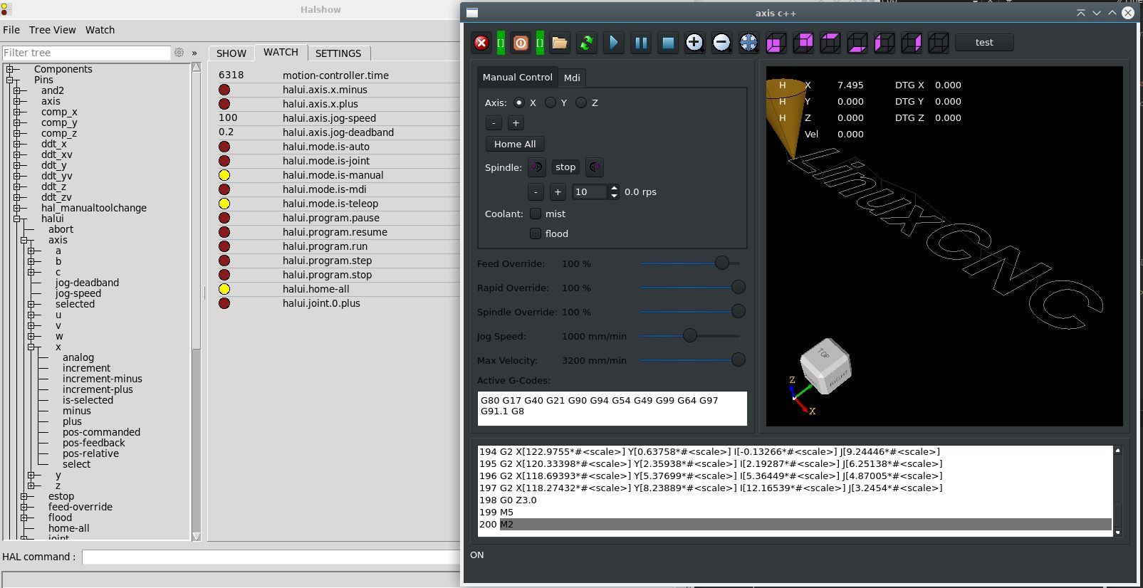

by Grotius
Replied by Grotius on topic Trajectory Planner using Ruckig Lib
Finally the c++ axis gui is running as stand alone app.
I did a few things to get it running as stand alone.
1.
Added a nml error channel :We already had the command & status channel, i thought maybe it need a error channel too?
2.
Added a hal component to the gui. I thought maybe it needs this to run?
This idea was inspired by a historic tryout : github.com/grotius-cnc/qt_c_linuxcnc_interface_gui
3.
Added the linuxcnc startup gcode to the gui.
Then it still didn't move. So i started ~/bin/./halshow and then used halui to home the machine.
And it worked. Then i could set the jog speed and it jogged x+.
So tommorow i will create some nice presettings for the c++ gui.
Now we can show the path optimalisation in opencascade.
This gui has the opencascade c++ gremlin gcode preview. This can show us everything we want.
So far so good ! Let's begin the real work now.
1.
NML *err = new NML(emcFormat, "emcError", "xemc", EMC2_DEFAULT_NMLFILE);2.
void hal_connection(){
int comp_id = hal_init("QT_C++_Interface");
hal_comp_name(comp_id);
hal_malloc(200);
hal_ready(comp_id);
}3.
std::string file;
file += EMC2_IMAGE_DIR;
file+="/share/axis/images/axis.ngc";
nml->load(file);Then it still didn't move. So i started ~/bin/./halshow and then used halui to home the machine.

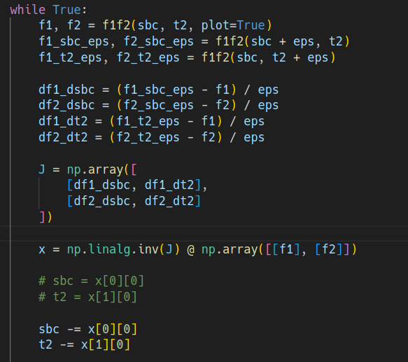

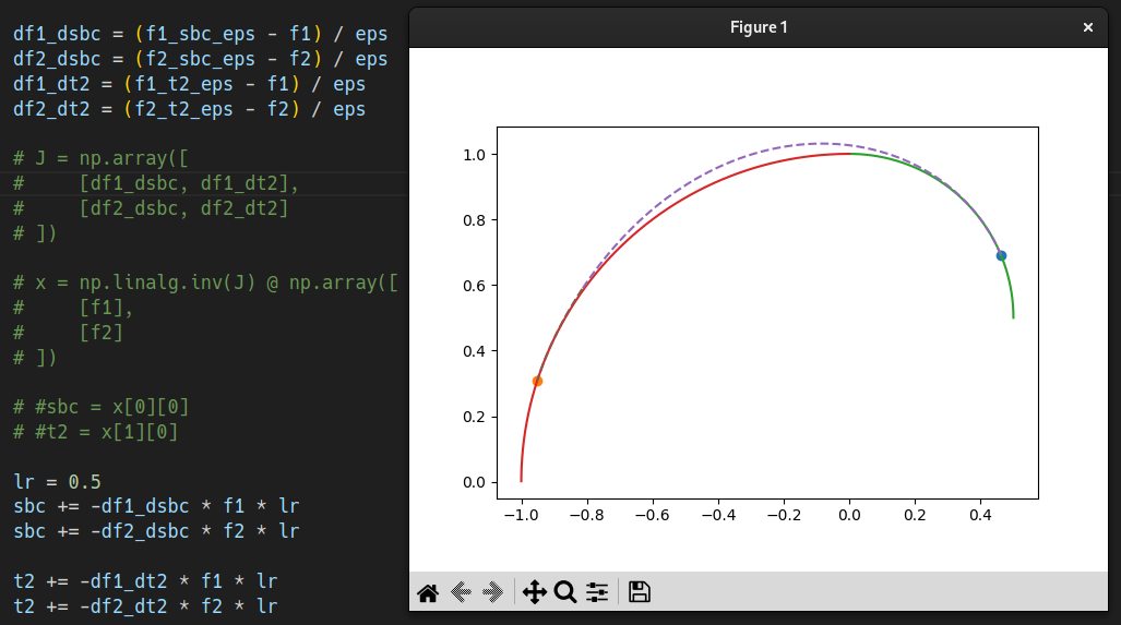

- andrew2085
- Posts: 28
- Thank you received: 42
29 May 2024 15:02 #301771
by andrew2085
Replied by andrew2085 on topic Trajectory Planner using Ruckig Lib

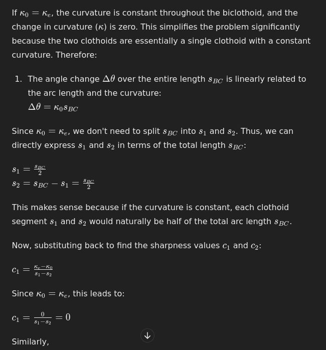

I've been trying to test the first algorithm in that bi-clothoid paper but have had problems. Equation 11 has k0 - ke as the denominator, so when the curvature of the shapes you're trying to join are equal, the equation breaks down. I was able to use sagemath to just find the limits of the equations that break down and use those instead in those situations. The equation also just seems to give bogus values for certain inputs, negative s1 or s2 which don't make sense. It seems like only one of the possible solutions to equations 7, 8, 9, and 10 for s1, s2, c1, c2 are given in the paper, but I was able to figure out what was missing with sagemath. It almost seems like it's working, the second and third iteration close in on the solution, but the fourth overshoots and generates negative inputs. I'm not sure if I'm just missing something about the implementation of the algorithm in the paper, or if you are expected to do more than what is shown.
maybe a fresh set of eyes can help see what's wrong.
Here's the test program:
colab.research.google.com/drive/1Gh6oU7h...YF4zEgFD?usp=sharing
PDF:
www.researchgate.net/publication/3246504...h_speed_CNC_machines
PDF:

- Grotius
- Posts: 2419

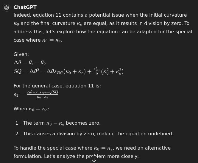

@Andrew,
if Ke-Ko=0 then result s1=0. But you know that yourself too.
I really have to dive in that to say something usefull.
Deep respect you are doing and have achieved so far.

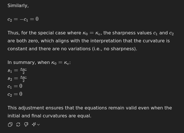

Here is some chatgpt info about your issue, i just copy paste a piece of the science paper into chatgpt.

Well I figured it out. It now converges in about 6 iterations. Maybe I just don't understand the notation from the paper, but that sure as hell doesn't look like its decrementing sBC and t2, it looks like its assigning. It was just a wild ass guess, but it was correct.
Changing from assignment to decrement:
From the paper:
Edit:
I asked ChatGPT: mathb.in/78746
I guess subtracting from the existing values is implied because that's whats normally done when doing this kind of operation with an inverse Jacobian.
