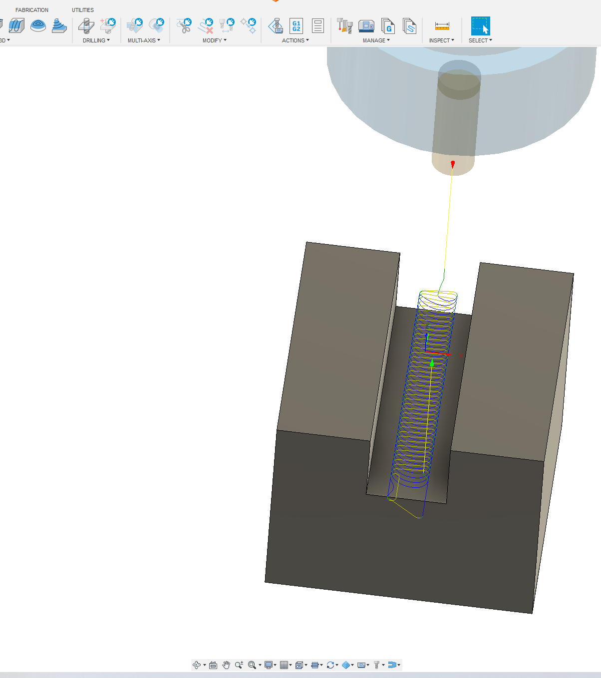

grate progress here.
adaptive tends to have a lot of feed changes and micro lifting going on, very common code type to be ran now days too. where feed reposition moves are much highter than cutting feeds and into the m/min like 5 or 10m/min repositions , while cutting might only be 1or 2 m/min
slotting operation would be a good test too makes a lot of machine issues in the current tp due to all direction changes with in a small area.
see attached exsample i just threw together , see what you get from results

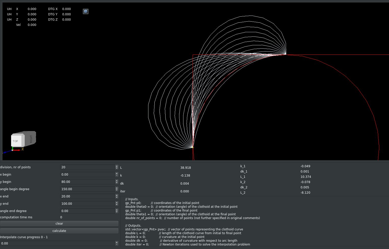

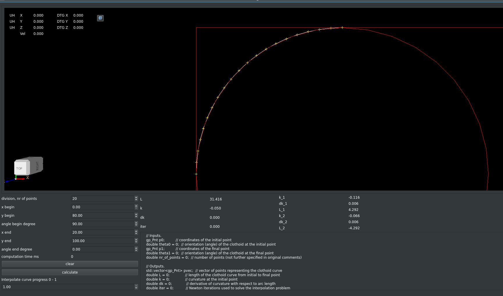

@All,
I just made a c++ interface for the clothoid's. To easely use in c++.
It can build the clodhoid curve, it can interpolate the point on the curve given a progress or current displacment.
I had to figur out that, but it all was quite easy to solve.
So now technically it's ready to use in the trajectory planner. As we can calculate & interpolate the clothoid's.
The performance :
When you create a clothoid given startpoint, endpoint, angle_begin, angle_end it calculates curve params:
- Build duration: 0.006814000 milliseconds
Then this is a result of evaluate the curve using a input of retrieving 20 waypoints.
- Evaluate duration: 0.027010000 milliseconds
Then in the trajectory planner during runtime we need to interpolate the xyz position every cycle.
- Interpolate duration: 0.000772000 milliseconds
Showing interpolation results:
I think this is understandable code to use:
interface.h
interface.cpp
Now the question remains. How to use the curve on the traject. How should we fit the curve between the gcode segments.
Possible solutions :
- Should we give it a max path deviation as input? This could sample the curve up to max deviation value.
Any suggestions?

I don't typically see issues with adaptive slotting as they tend to use tangent arcs to straight lines. It seems to be curve created by the cam software that are made up of straight line segments that trip up the tp.grate progress here.

Here is a biclothoid overlay with a circle. I think there is only g1 continuity. I think problem to solve.
How to get the biclothoid drawn with g2 continuity as there are no other inputs to do that.
You only have entry angle and leaving angle. What do we miss here?

Adaptive clearing is a high speed type of roughing tool path that uses constant engagement with the work piece. I don't tend to have issues with the cutting so much as the repositioning moves between cuts as it uses the short line segments and this cannot be altered through settings, at least none that I have found. Because roughing is one of the longest most time consuming operations on most parts this really hurts efficiency when you must slow things down to keep machine shake in check.
