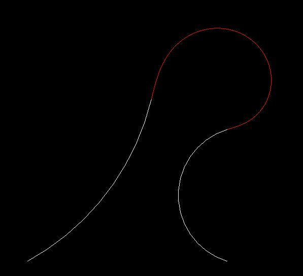

Arc to arc tri-clothoid g2 solving works. Tested line to arc, works ok.
This is more difficult to code. As we need the arc angle at the tip of the arc circumfence.
For the first arc endpoint:
1. We first find the angle of the line pc to p1. (pc = center, p1=arc endpoint). This is atan angle to x-axis.
2. We calculate if arc is cw or ccw. (cw=clockwise, ccw=counterclockwise).
3. We add +90 or -90 degrees to the angle calculated by 1, depends on cw or ccw direction. This is then the tip angle of the arc.
For the second arc startpoint:
1. angle pc to p0.
2. calculate direction cw or ccw.
3. We add +90 or -90 degrees to angle found at 1. But then this is opposite input of first arc, i found out.
Sample picture of the fillet :

We now have opencascade ready to draw the clothoid fillets. opencascade functions
It automaticly knows if the first & second item is a line or arc.
Then it does some logic and connects them with tri-clothoid.
Now tommorow i will make a clothoid list. This are interconnected clothoids that can be a gcode overlay path.
This result is then a gcode path with G2 continuity. The G2 problem is then solved.
We will see what the result may be. I am quite qurious. The code now does not involve path deviation value, as
this can be done when gcode path overlay works.
Also i can look at the gcode compressor to filter out tiny segments.
The clothoid can be a line, an arc or a spline. Its like a thing that can change.
Ok have a nice day !

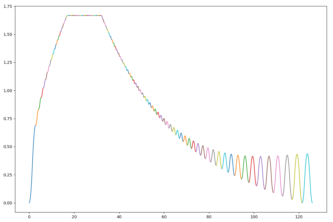

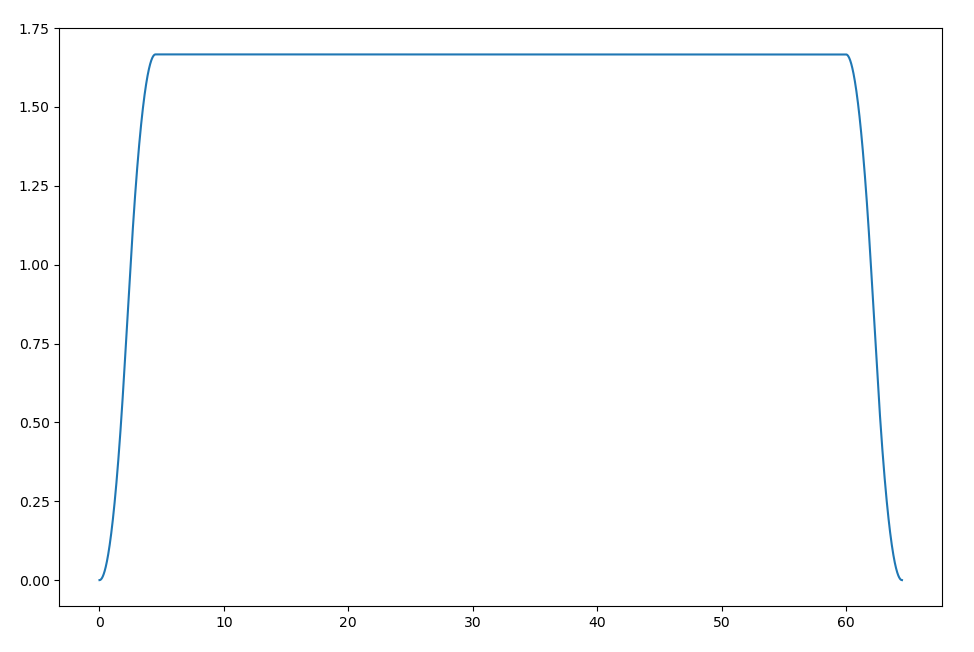

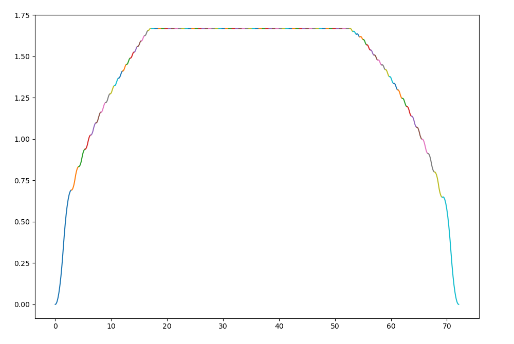

The s-curve multi-segment solver is working efficiently now. This is 100 1.0in segments with a v_max of 100in/min, a_max of 40in/min, and j_max of 20in/min. The oscillations on the second half of the path are because I'm using a very crude method of solving velocity overshoot from the end of one segment to the start of the next segment. I need to figure out another set of equations to get the second half to look nice like the first half.
You can see how this contrasts with a single 100in segment with the same constraints. This is because each s-curve has to begin and end with zero acceleration.
Edit: This is better, but not super efficient.

There is a maximum acceleration and maximum deceleration, but the start and end acceleration of each s-curve is zero. It would be nice if the initial and final acceleration could be chosen, but I think that would be computationally infeasible to do in near real-time. Of all of the papers I've looked at, none had a solution where you could have an initial and final acceleration constraint.
I got it working. All the algorithms needed to solve the problem efficiently have been figured out. At this point it's just about cleaning up code and dealing with any bugs that pop up. This takes about 500us to solve 100 s-curve segments with velocity and acceleration continuity and no work has been done to try to optimize anything yet.

Yes, I'm also super curious how yours works in planning mode. If you give yours the same problem to solve, what does the graph look like compared to mine? The problem in my graph is 100 segments of:
// units of inches and seconds, so 100in/min etc
V = 100.0/60; // max velocity
A = 40.0/60; // max acceleration
D = 40.0/60; // max deceleration
J = 20.0/60; // max jerk
L = 1.0; // distance
The initial velocity of the first segment is constrained to 0, and the final velocity of the last segment is constrained to 0. Since there are one-hundred 1in segments, the total distance traveled should be 100in.
