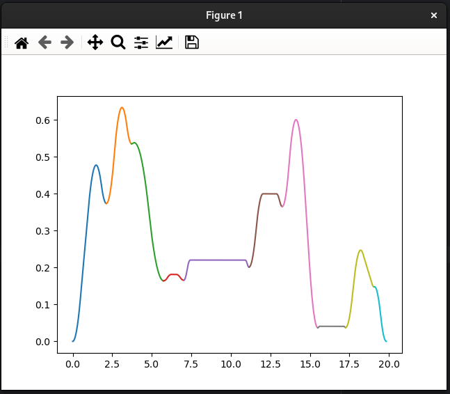

The stress test runs ok.
Now i would like to print the current velocity over the total periods.
I am able to get the periods from the *sol.
Can you tell me how to get curvel given a time 0 < ttot ?
Thanks for your efforts so far.
const scurvy::solution_t s=*sol;
double t1=s.periods.T1;

31 May 2024 12:10 - 31 May 2024 12:20 #301977
by andrew2085
Replied by andrew2085 on topic Trajectory Planner using Ruckig Lib
I hadn't had a need for that yet. I just added it, but I haven't had a chance to test it.
github.com/a-downing/scurvy/commit/938b7...a75392ee1d14c722bf5f
Edit: Oops it's definitely wrong, let me fix it quick.
Edit: Should be good now: github.com/a-downing/scurvy/commit/f271a...40af0f51734534134e3f

31 May 2024 15:01 #301996
by Grotius
Replied by Grotius on topic Trajectory Planner using Ruckig Lib
Hi Andrew,
Everything is ok now. Both libs compile as a charm!
The scurvy runs. Also a python graph is plotting after the matplotlib install.
I get the curvel at time printed. Nice !.
