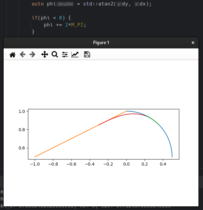

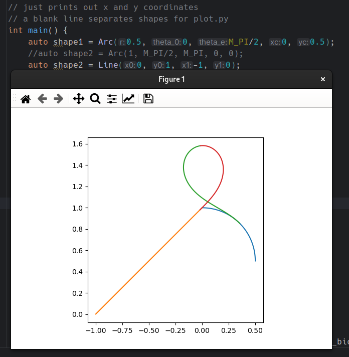

30 May 2024 16:00 #301887
by andrew2085
Replied by andrew2085 on topic Trajectory Planner using Ruckig Lib
I think the only c++23 feature I used besides std::println is std::expected, you should only need to change a couple lines to just return the value directly. It's in scurvy::solve in scurvy.h. I don't really need them, they're just convinient to use to do fast work. On systems with old gcc versions I usually just compile the latest version of gcc and install to /opt.
I just added a Line class to the clothoid project and pushed to github. This is technically right, but its also wrong. Hopefully I just overlooked something.

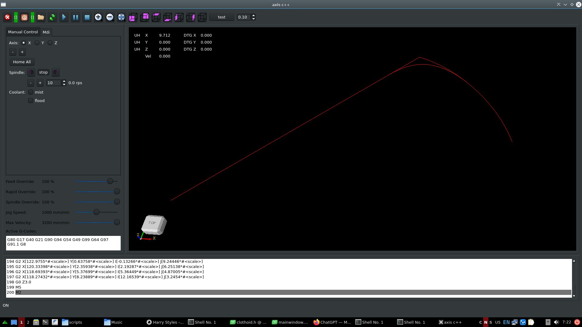

31 May 2024 07:00 #301943
by Grotius
Replied by Grotius on topic Trajectory Planner using Ruckig Lib
Hi Andrew,
I have seen this behaviour before using a spline lib in opencascade a few year ago.
When corners become tight, the spline used that solution.
Nice you found the solution to normalize it to be a max of 2*M_PI.
The clothoid library now works along the linuxcnc program.
The clothoid source code is now in the linuxcnc vendor dir:
clothoid_andrew
To make it myself easy i have brought all your code into a source file.
If you make any modifications, i just have to copy, paste code.
Then your code is in class clothoid_intf, This interface will be used to make your arc & line shapes
compatible with the linuxcnc arc & line primitives. A little bit of shape conversion code will appear there.
This is your test example using a line and arc, creating a clothoid fillet. It works perfect !
So far so good ! Now let's try to get the scurvy going.
clothoid_andrew
