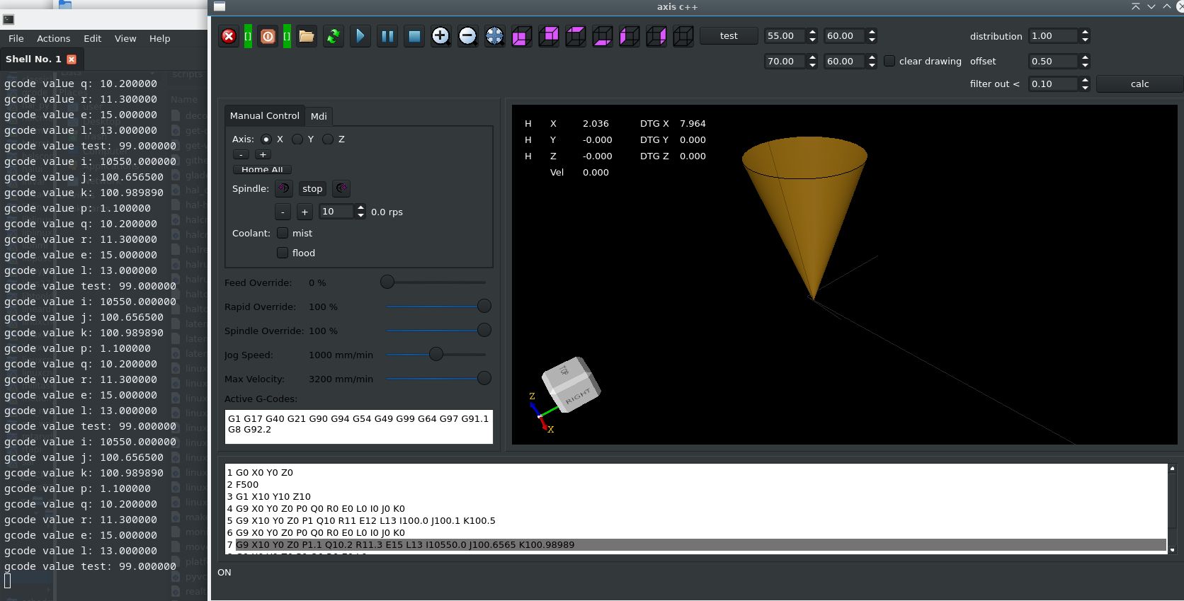

The G9 is working. It is now running in the TPMOD from Rob Ellenberg.
It's showing a line, as i told the python part in lcnc to draw a line if it see's a G9.
Now the framework for a general motion is working!
Coding this, was not easy. But afterwards you can search for : GENERAL_MOTION and almost everything that
i coded into the source will appear.
To finalize it, i will also include I, J, K letters to pass into the G9. Extra variable letters already included are P,Q,R,L

Up to date with lcnc master :
lcnc repo
Then we now we can think about how to use this GENERAL MOTION. G9. stuff.
It has a lot off values we can use : x,y,z,a,b,c,u,v,w,i,j,k,p,q,r,e,l.
Normally the L is of type integer.
They idea is to create gcode like :
E= is proposed to be a identifyer for line, arc, etc.
L= is proposed to be a indicator for startpoint, waypoint, endpoint.
P = tollerance for G64
Q = naive cam value for G64
E100.1 or E100.2 is also valid identifyer. Really no limits over here now !!

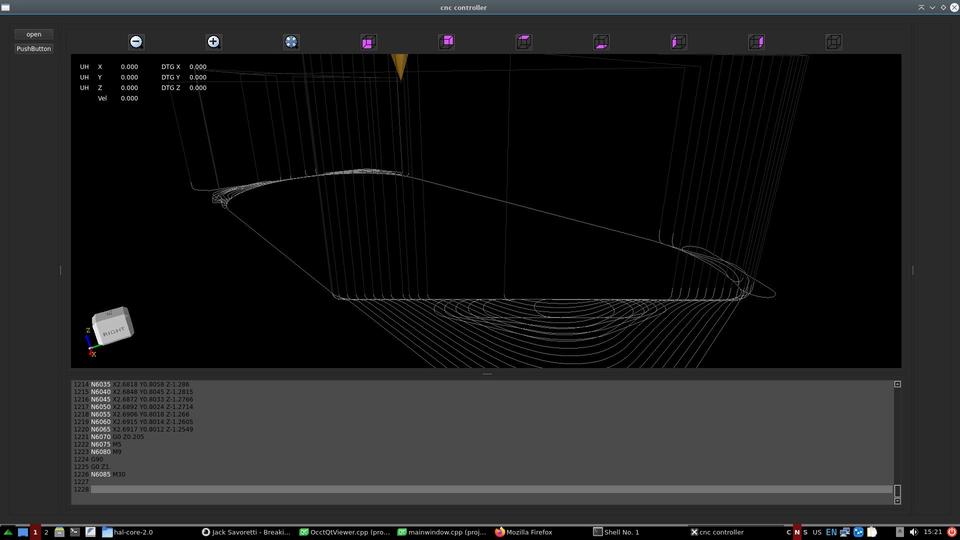

I see Probe Basic is a python hmi for linuxcnc.
Today i was working on hal-core , This is a hal environment.
It has a c++ hmi that now runs the nist rs274ngc interpreter.
The interpreter misses a few gcode commands like G64. Will add them with the G9.
The idea is to code both projects together to the finish line : linuxcnc & halcore
Halcore has less code overload, uses no python, has no code forest, is compact & fast.
Halcore now reads the gcode file trough the rs274 interpreter and shows the results in opencascade :
Halcore has no Milltask component. So i will create one for it, But will name it different.

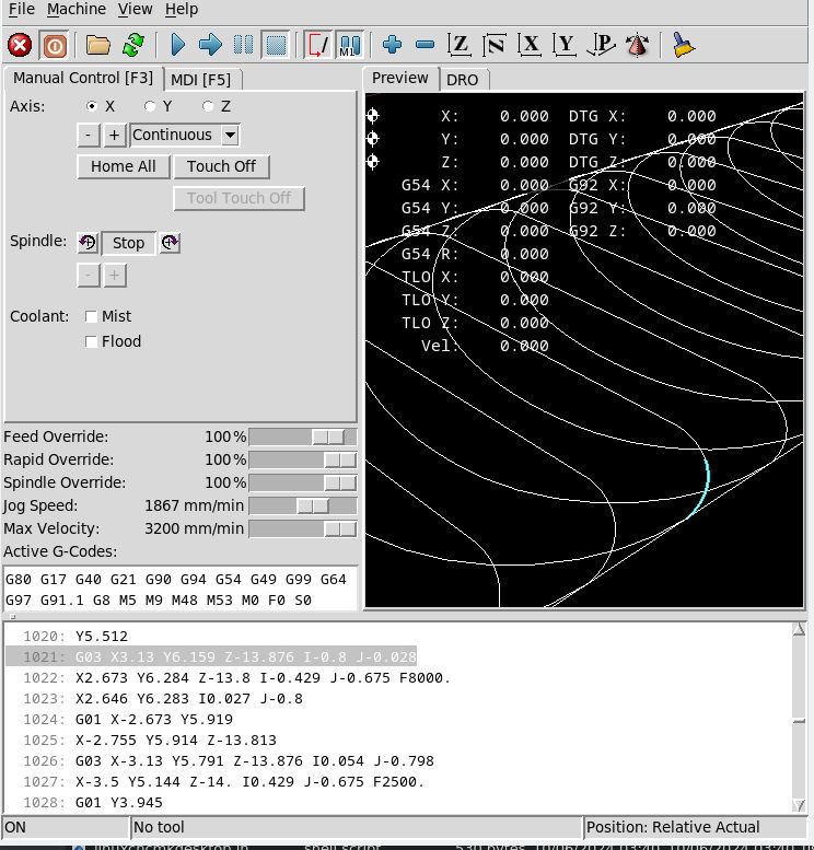

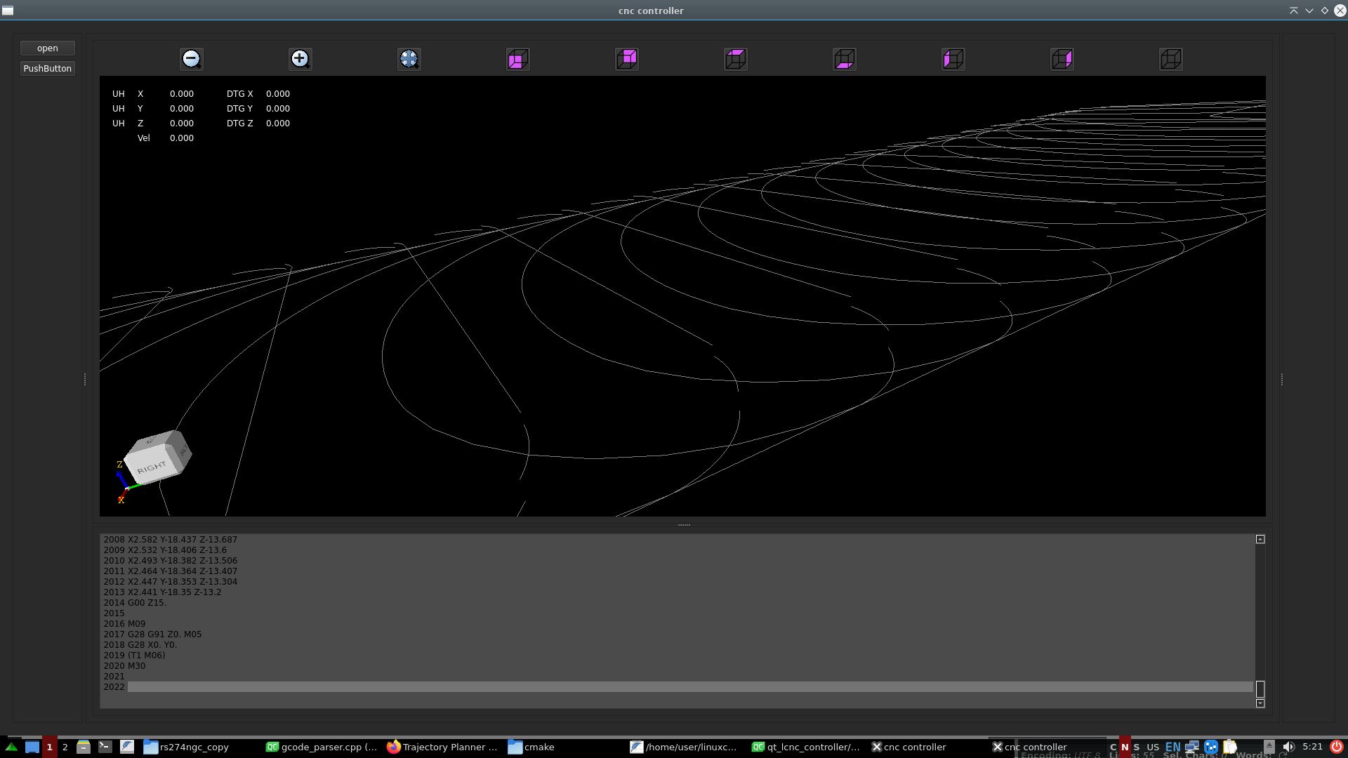

I have a question about gcode file from robh:
In the gcode there are arc's that start with z value, then the arc uses a different end z value.
Plane is xy. This arc is a spiral? I never used a spiral before, but in this case opencascade has to draw a spiral i suppose?
Also trajectory interpolation model for a arc spiral has to be made then.

@Grotius do you mean similar to a boring operation where it's interpolation of xyz like a thread?
- ihavenofish
- Posts: 1031
- Thank you received: 287
17 Jun 2024 23:16 #303223
by ihavenofish
Replied by ihavenofish on topic Trajectory Planner using Ruckig Lib
helical motion. g2/3 circle with a z component. normally you tell the post processor to turn that into lines cause not all controls handle helical motion.
- Grotius
- Posts: 2419
- Thank you received: 2349
18 Jun 2024 04:34 #303238
by Grotius
Replied by Grotius on topic Trajectory Planner using Ruckig Lib
Yes.
In the linuxcnc axis gui it draws a spiral (i think). So normally you would not mention, he this is a spiral.
You see in the gcode line, there is a little z difference in the upfollowing arc move.
In my gui it draws a pure arc on xy plane. I did not expect to draw a spiral.
So this is a spiral?
If so, i have to check if the g2, g3 moves have a z difference.
This is not difficult, but i have to create a spiral in opencascade, and a interpolation model for a spiral.
Yes.
