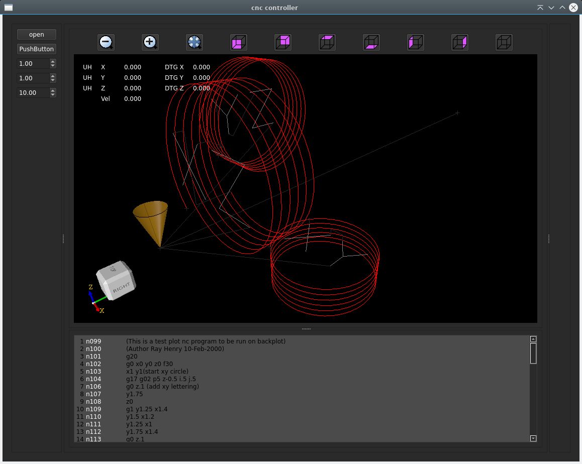

And as Hmnijp mentioned in his post, it can use the P word for nr of turns.
This nr of turns is tested in the lcnc 3d example ngc file:
And then the gcode file of robh, the helix is also color red:

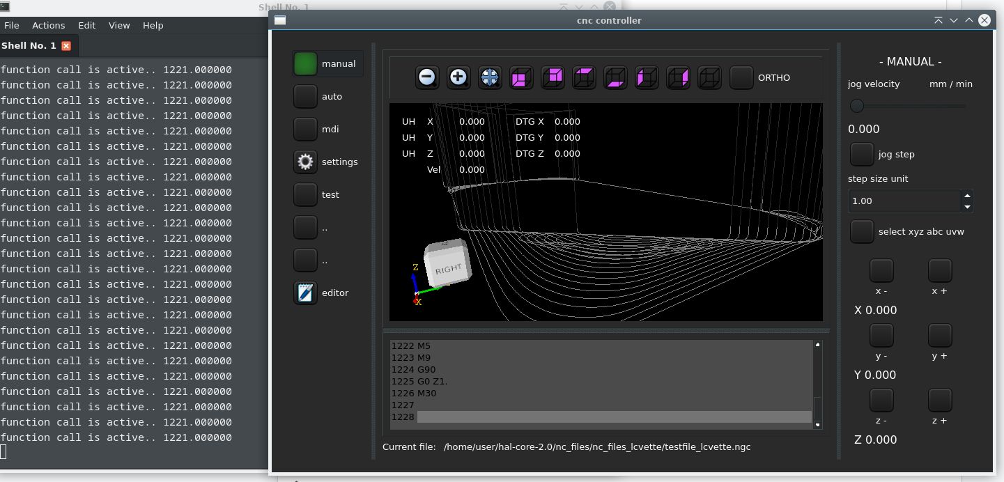

Ok, this looks ok for now.

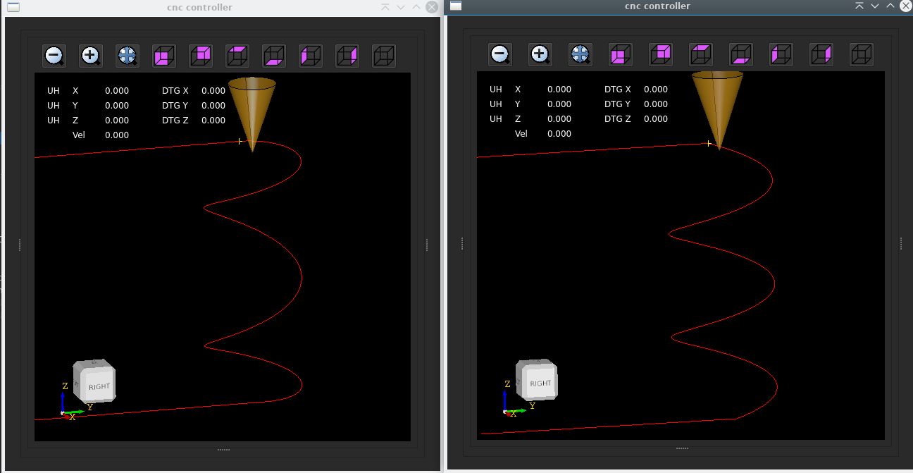

Now i added a helix G2 continuity test function.
Instead of drawing a helix in a plane, we add something special.
It's a G2 helix (clockwise arc), 2 gcode lines are attached. You can see what happens in both situations.
So it starts the helix with zero curvature (k value) in the spring axis, in this case top view xy plane G17.
Then along the path it uses a cos function to increase the curvature along the path.
Then at the end it comes down to zero curvature.
So now this spiral, or helix has G2 continuity and can be used to create fillets with a tri-clothoid.
I think for spiral we can use the gcode L word to enable G2 continuity mode like :
G2 P2 I0.5 J0.5 Z1 L1
P= turns
L= enable G2 continuity for spirals

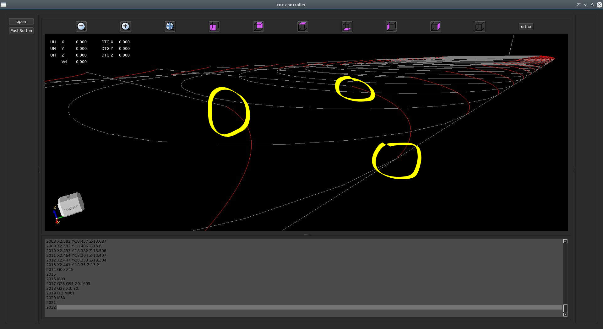

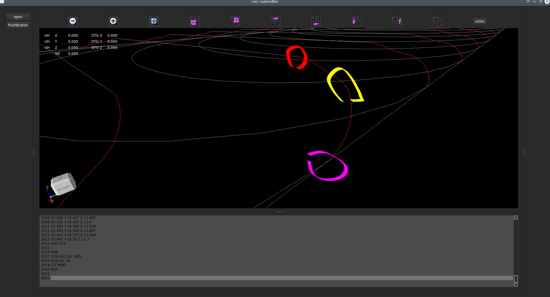

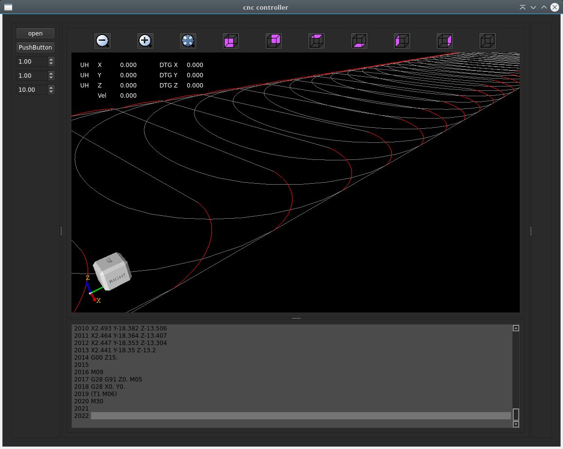

Here are the results of a helix not doing a G2 continuity, G2 ... L0
Clearly you see sharp transition corner in yellow, this is bad for machine :
And a helix doing G2 continuity in the testfile of Robh, G2 ... L1:
Yellow is transition from helix to helix. Red and purple, no transition corners visible.
Path is better for machine.
