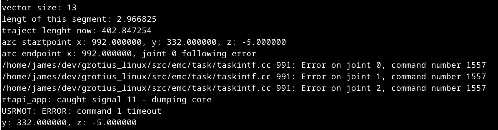

@Joco,
You suggest a full circle is the problem for scurve?
Indeed. Stupid..
This is ok, outputs ~157mm.
struct sc_pnt start={0,0,0};
struct sc_pnt way={50,50,0};
struct sc_pnt end={100,0,0};
double l= arc_lenght_c(start,way,end);
printf("arc lenght : %f \n",l);
Then this is fault : It outputs nan, but is a circle.
struct sc_pnt way={100,0,0};
struct sc_pnt end={0,0,0};
Ok will fix this.

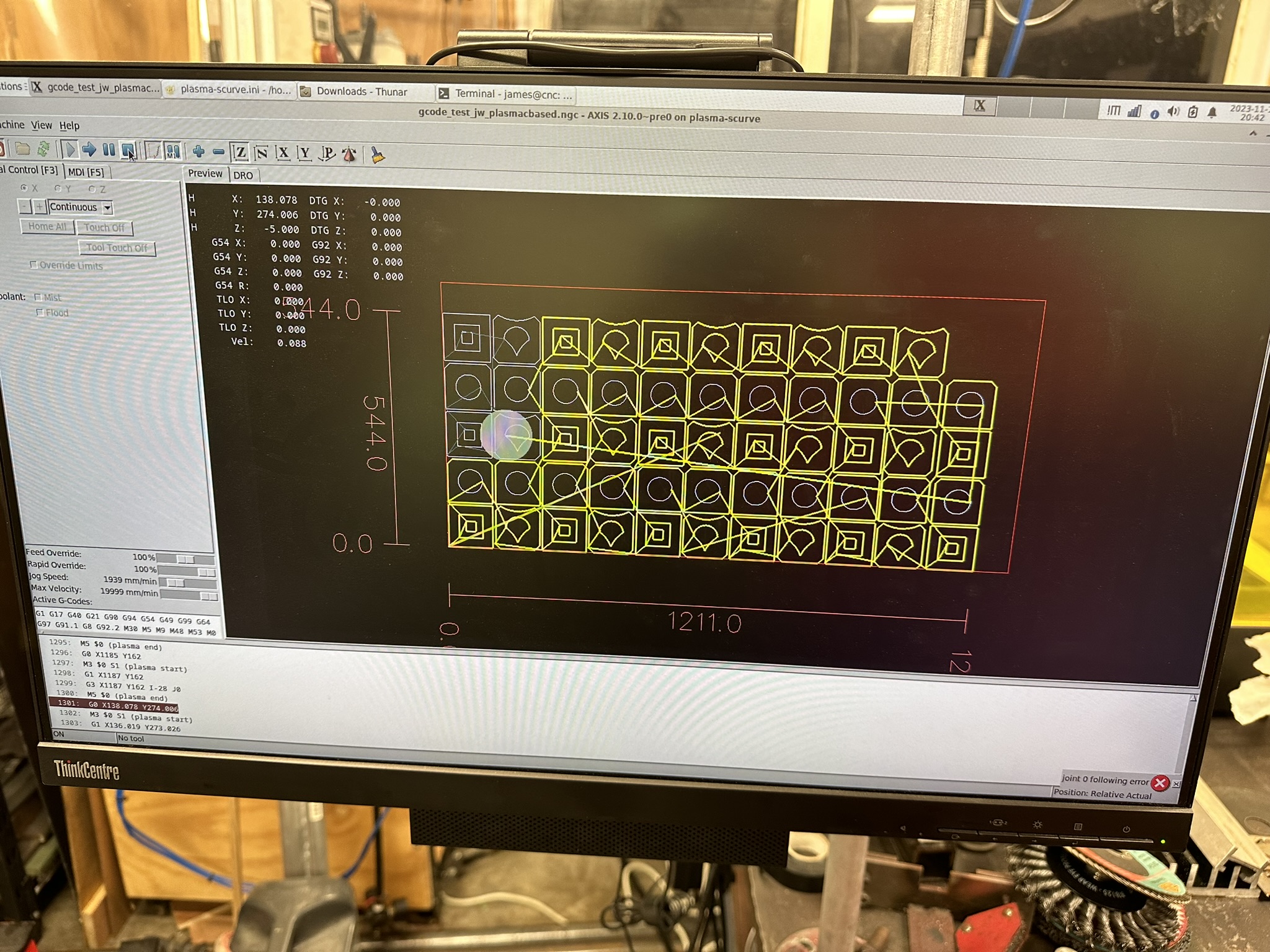

Okay this test run ran for circa 7mins before stopping early. Attached is video of the run. It shows the interesting mix of motion. Sharp corners can still ber quite hard while the transitions between arcs can have a relatively long pause.
The program stalls before completion. See log details on
Log file trapped for this run.
New test file based off the sheetcam plasmac PP. This has circles made of two arcs. Where as the previous test file would have single arc circles. This was still handled by the standard tp
Cheers - J

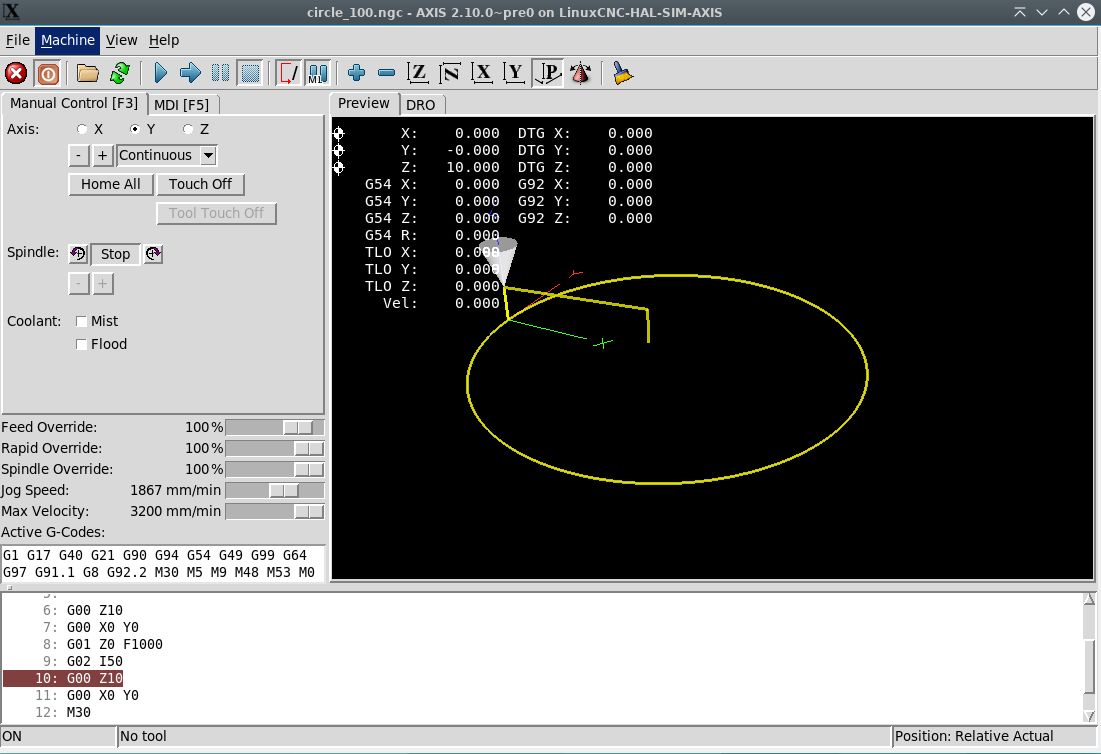

10 Nov 2023 02:24 #285013
by Joco
Cheers - J.
Replied by Joco on topic Trajectory Planner using Ruckig Lib
That was why I gave the link to the gcode viewer for stepping through the gcode file and being able to see the shape rendered and the movemments. But not problem to provide the pics. I am pretty sure I quoted the gcode line in question in an earlier post. But no matter. Happy to add whatever info makes things easier.Note : If you see a gcode mismatch, please provide the gcode line and or a picture. Then i can figur it out.
Cheers - J.

Replied by Grotius on topic Trajectory Planner using Ruckig Lib
@Joco,
Now it can cut a circle... Hahaha.
Quite stupid mistake from my side. But ok, we can repair it.
The downsides of this in a nutshell.
If a circle has a centerpoint and the start & end point are the same, the circle is 2d defined, not 3d defined.
The scurve planner uses 3d defined arc's and 3d defined lines for future gcode generation.
So now using a 2d circle is kind of a gcode language paradox problemf for me.
Circle test ok, did just one test and added a circle testfile :
Git is now updated. Will be back monday.

Hello. Have been running some tests as was particulary interested in the "pause" behaviour being observed in certain situations. I wanted to zero in on that while also doing proof runs.
The pauses seem to be on hard direction changes suach at the edge of a square with a hard 90 degree corner. There are a few examples of this in the sample gcode file being used for testing. Isolated down here is the oncentric "squares".
However when you look closely at this (loading in either lcnc or in an external gcoder viewer you can see the inner and outter sqaures have "fillets" blending the corners where as the middle square has hard 90 degree corners. These cause the pauses.
@Grotius - I am guessing that the TP is not doing any kind of blending on these corners and using G64 to generate any intermediate points to soften the change in direction. The ruckig lib does not seem to do that blending for us. We ask for postion x,y,z and it gives us the jerk constrained set of points and accerl/vel to get there. If we want some smoothing to happen I presume the TP needs to do that before feeding target states to ruckig. A bit of a laymans description but hopefully makes some sense.
For anyone interested here is there vido recording the test file being run on real h/w with the plot and halscope up together. So you can see what is being processed and the halscope values for acceleration and velocoty from the TP. I would suggest sound off and you might end up skipping through bits. The key is to see the motion/accleration/velocity behaviour on the different shapes.
This is the log file linked to this video run. Currently I can not run the file more than once. Tryimg again gets tinker error messages in Axis. I have to stop and restart Axis to get another run to work.
Cheers - J.
