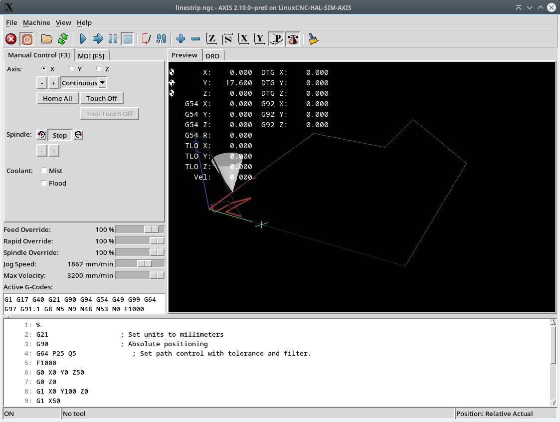

We are now at the stage that the trajectory is filletized with 3d bspline's.
For the 3d bspline's i used a lib called tinyspline , instead of linking to the huge opencascade lib.
Ok next step should ideally be visualizing the trajectory including the fillet result. But how?
We didn't coded the plannet yet. And the original planner can not run the fillets.
1. For this i could create a tiny tpmod_viewer.so component (helper component) wich draws the yellow toolpath line over the gcode path.
2. Modify the original planner, to also run spline fillets. This includes logic to reload the lcnc gcode queue at runtime. More difficult.
3. Create a text file output with trajectory points every mm to load into a external online viewer.
What should we do? Any thoughts about validating the filletized trajectory path?

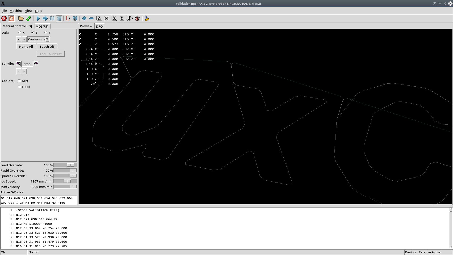

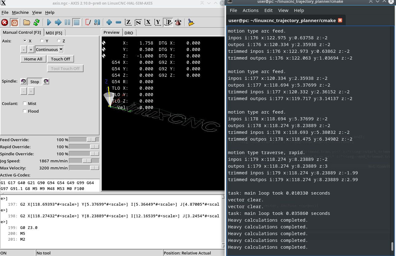

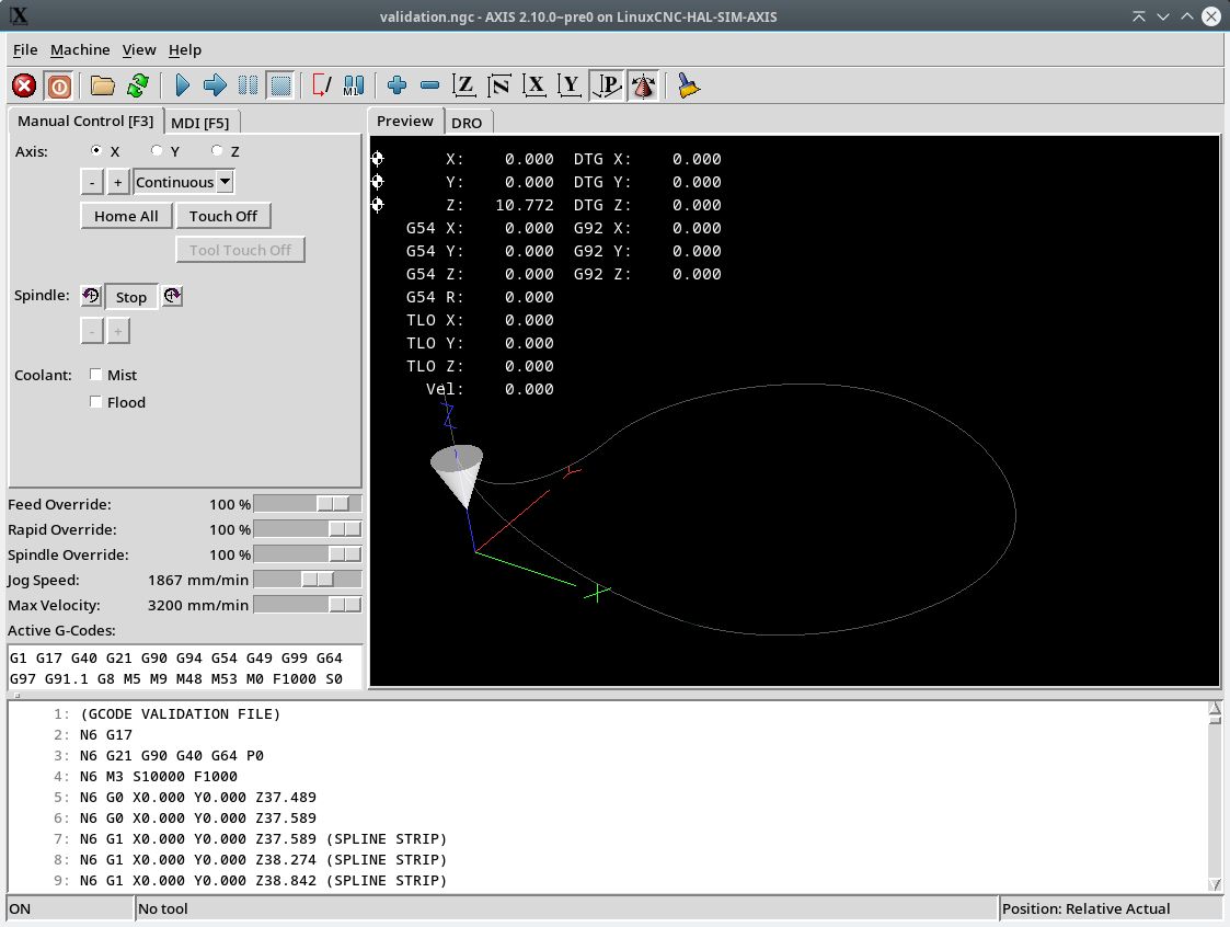

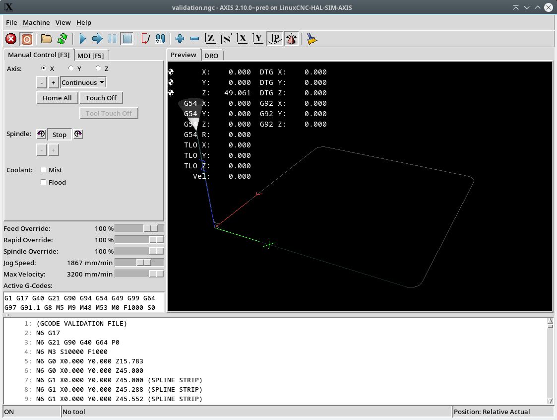

Hi Guys,
Thanks for your responce's.
@Automata, when time is ready, will check you back for the servo's. I think that's nice to have around here.
We have some results today.
When the buffer is loaded and path is optimized, it writes a gcode file named "validation.ngc" into the ~/cmake dir.
Then you can load this file into lcnc and check results.
Some times the path optimalisation fails. So have to look what's going on.
I have to dive deeper into the original lcnc circle math. As this gives sometimes error's at lcnc runtime.
The message is like "arc radius differs ..." Most of time around 1.4%.
It's now late. Will check some things tommorow.
Attached some test pictures. I used also chamfer fillets for test. And bsplines.

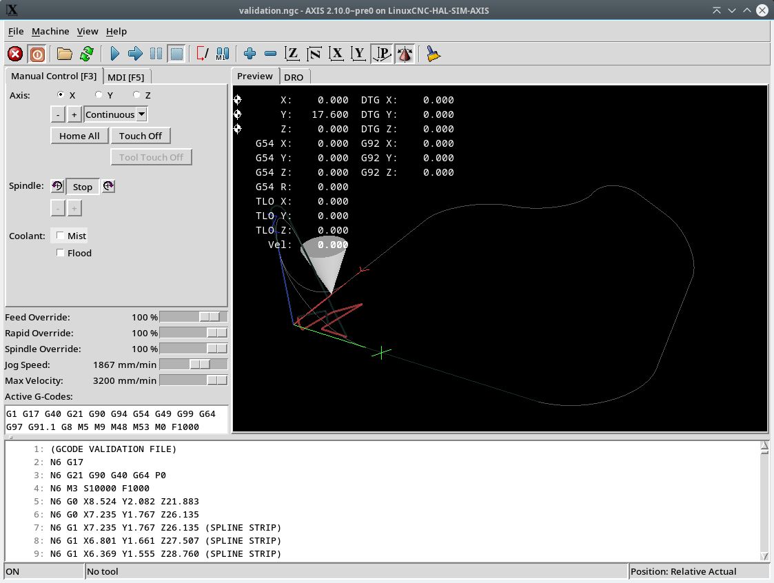

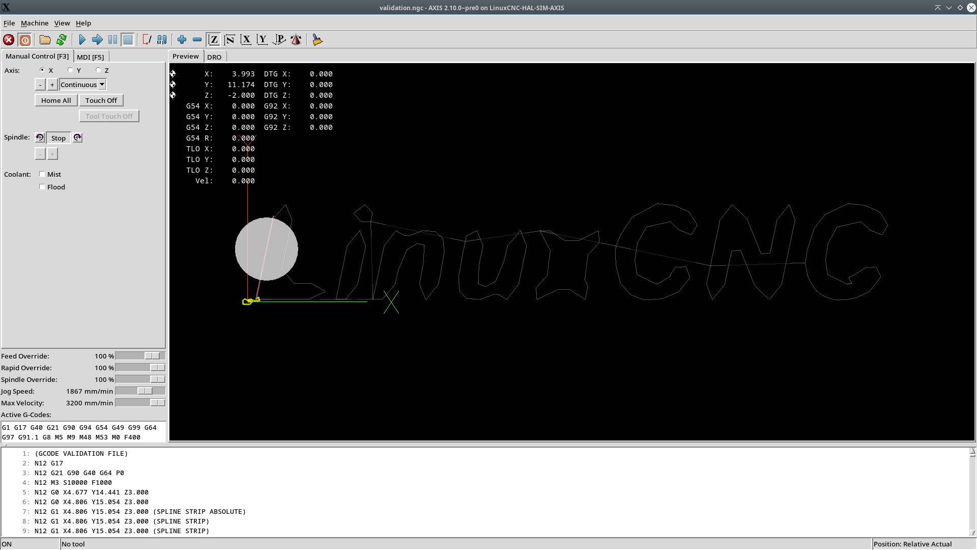

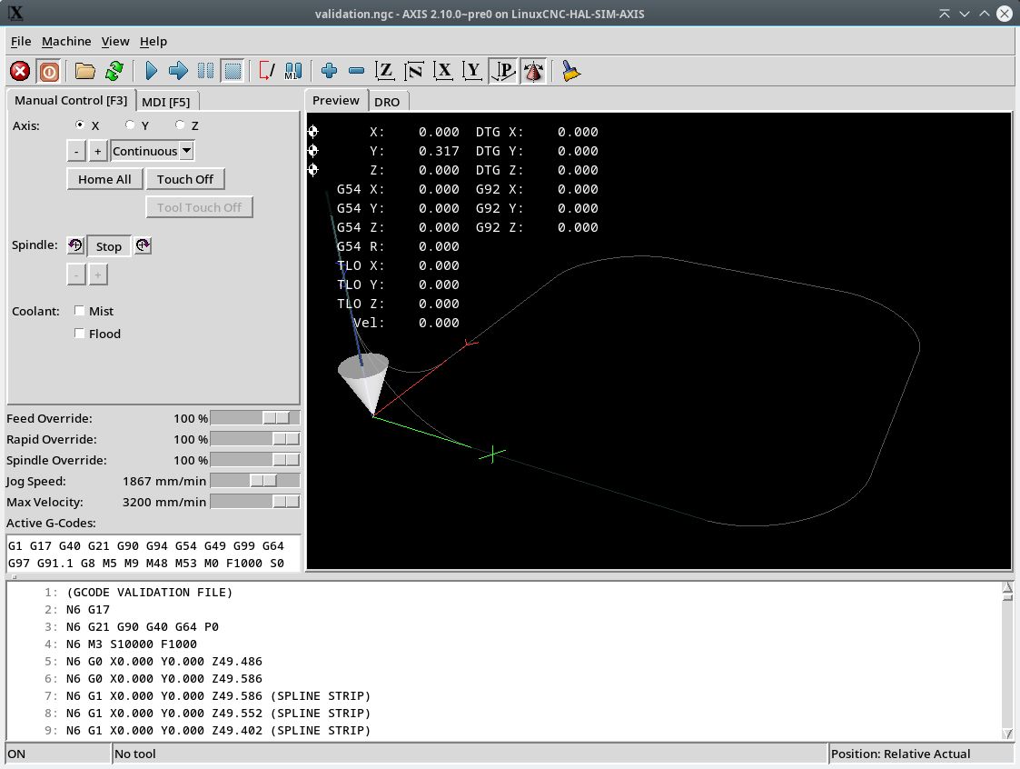

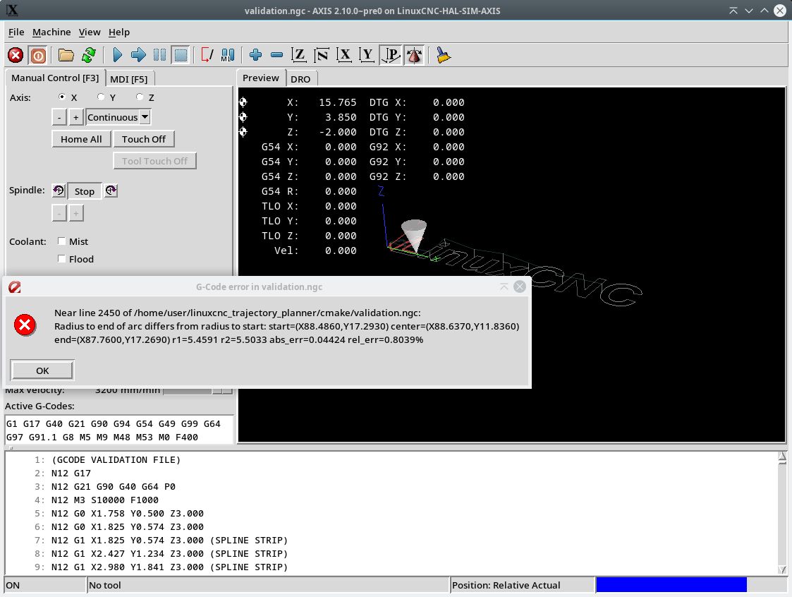

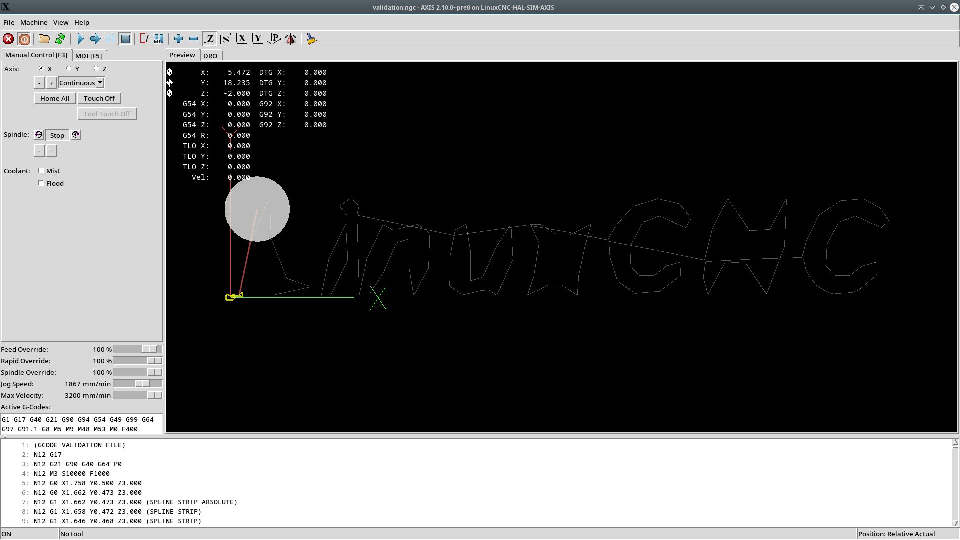

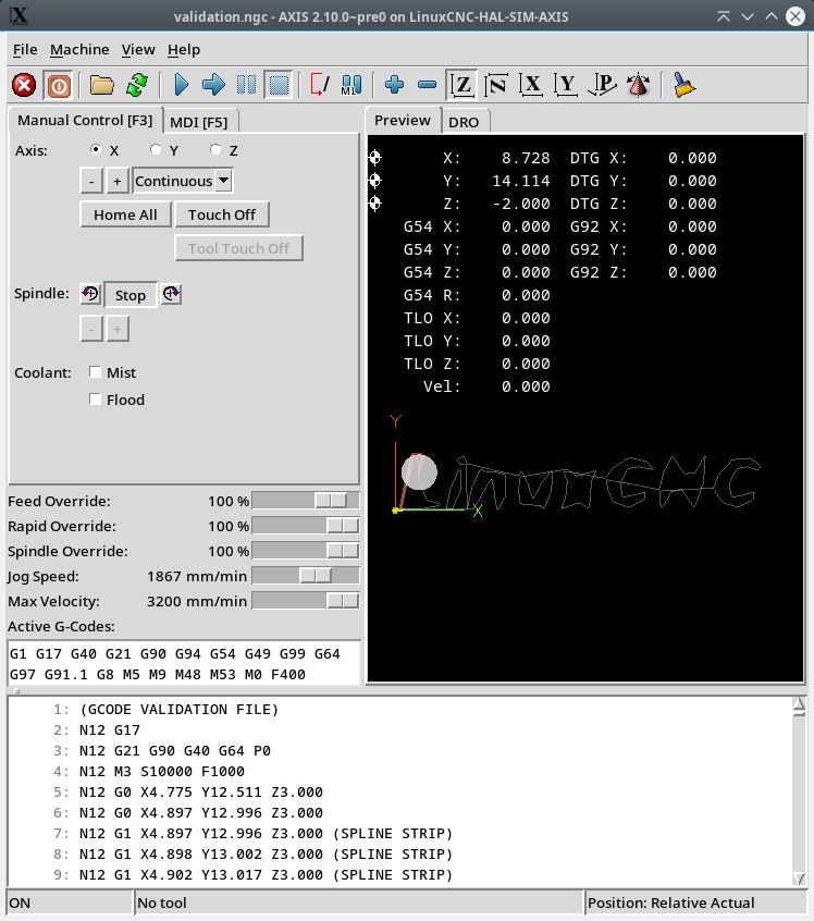

15 Oct 2024 05:06 #312140
by Grotius
Replied by Grotius on topic linuxcnc trajectory planner
G64 P0. Showing the original.
G64 P25 Showing the bspline blend.
G64 P5 Original this is a square.
G64 P25
G64 P50
So far it looks the bpsline fillets for attached line's are working fine.
However, for circles, we got this error :
I used the lcnc math to interpolate the circle at a given progress 0-1.
Now the result is used as arc point in the gcode, this should be ok.
So i have to look what is going on.
So far so good. We got already some results that looks like a bspline fillet.
updated repositiry
G64 P25
G64 P50
updated repositiry

- Grotius
- Posts: 2419
- Thank you received: 2349
15 Oct 2024 15:20 #312197
by Grotius
@Hi Julian,
As i speak for the programming world, i suggest programmers love to describe a line, arc or spline using a few points.
As memory efficient as can be.
But i get your point.
The error i was getting, i think i figur it out.
The arc function that get's the current point on the arc does this not
by giving it a 0-1 progress.
Instead a 0-arclenght input is the way to do it.
So here i was wrong. But it's also poor commented, so i could not know it so easy.
