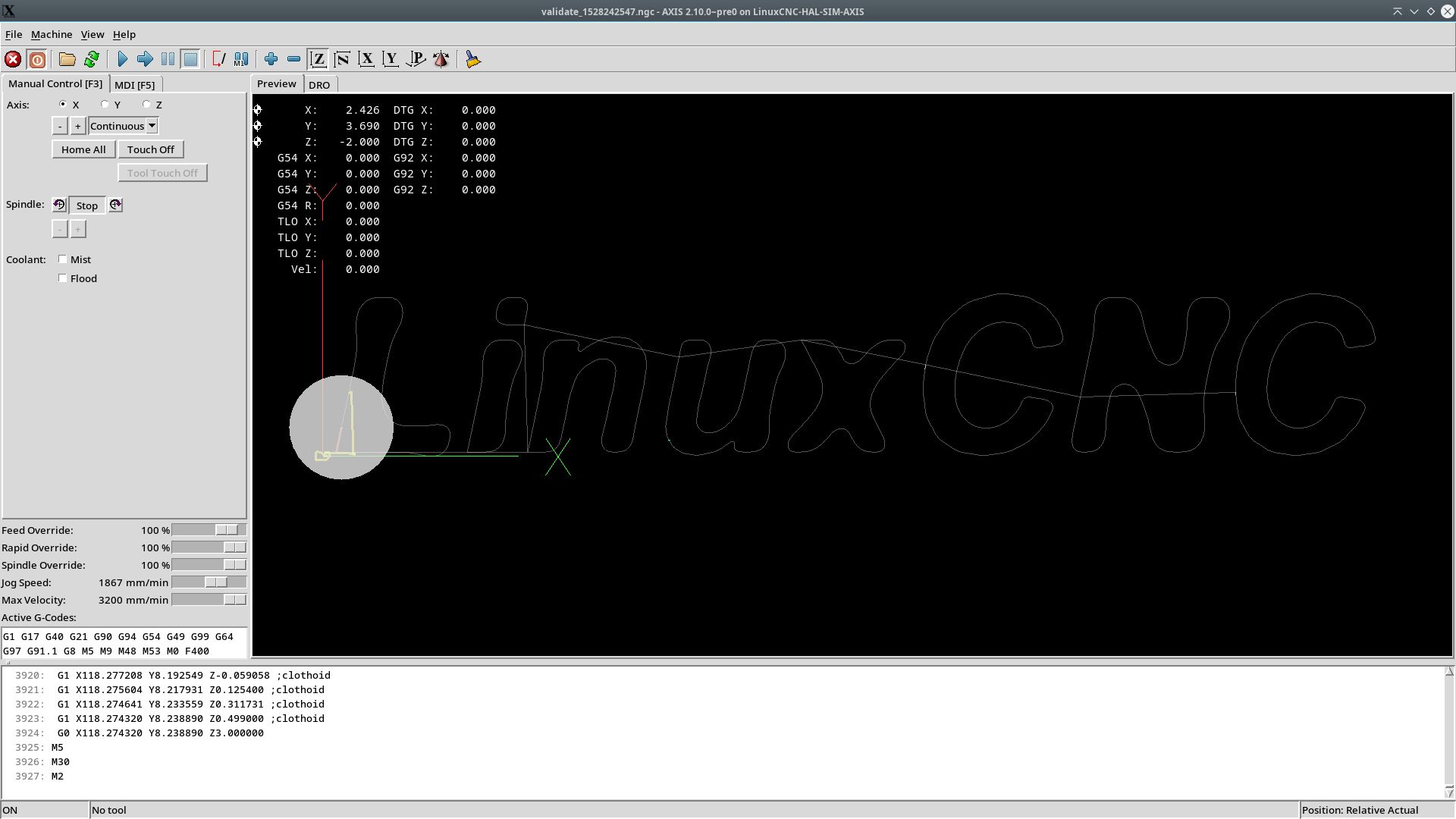

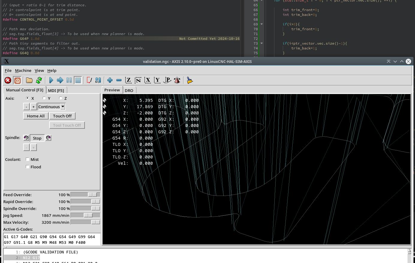

Had a weird experience. The scene was as follows.
1. Run linuxcnc with the "linuxcnc" splash gcode. Added G64 P1 to the top of gcode file. Then i pressed run.
2. Ok machine run's the file. In the background the traject optimizer was busy and a few moments later was ready.
3. Then load the produced file : ~/cmake/ "validate.ngc". into linuxcnc.
4. The gcode preview shows that "arcs" where converted to "lines". So how is this possible. Did i made a typo in the code?
5. Then i was reading online :
link
when the maximum deviation of an arc from a straight line is less than the G64 Q- tolerance, the arc is broken into two lines (from start of arc to midpoint, and from midpoint to end).
Conclusion for the test environment :
The interpreter had transformed the G2 & G3's into G1's. And the optimizer was then reading this false information.
So now to avoid this mismatch the files to blend are loaded with a empty G64 P, Q value, ensuring a valid input to the optimizer.
Then inside the optimizer the G64 P & Q values are set for now.
Ok, Then finally :
The vertical lines are for testing. It are spline control points. I had to visualize them to track the previous error.
Ok for now this is looking better.

nice! yeah not sure how to get around linuxcnc applying the G64 rules pre optimizer. may need something edited during initial load?

Replied by Grotius on topic linuxcnc trajectory planner
Hi Lcvette,
I didn't know linuxcnc would do this. When coding and testing i got my head scratched and thought : alien obstruction
Yes, indeed. We are screwed.
Tested this in top off a linuxcnc gcode file :
G64 P10 Motion blending tolerance
G61 Exact Path Mode
This then resolves the issue.
Wich means this is not applied :
Another error i was getting:
"same Y word..".
Cause, when running the "validation.ngc" file, when start is pressed, the file overwrites itself.
To avoid this, the filename now get a random number attached.
In the mean time, we learned a lot today.

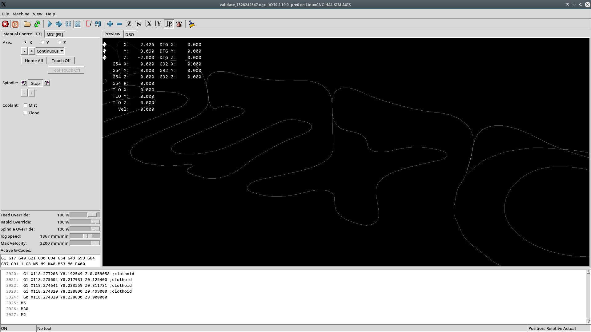

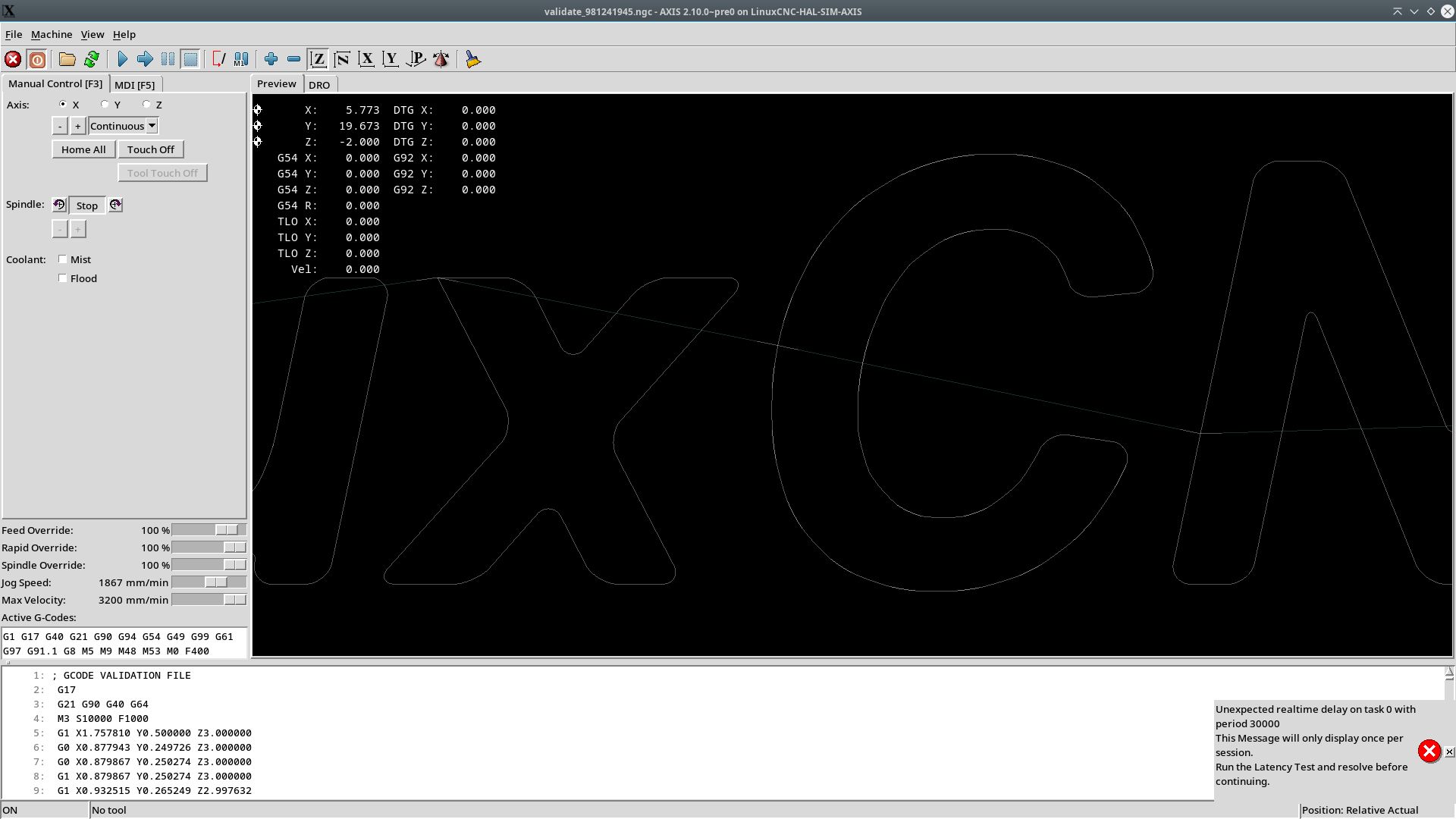

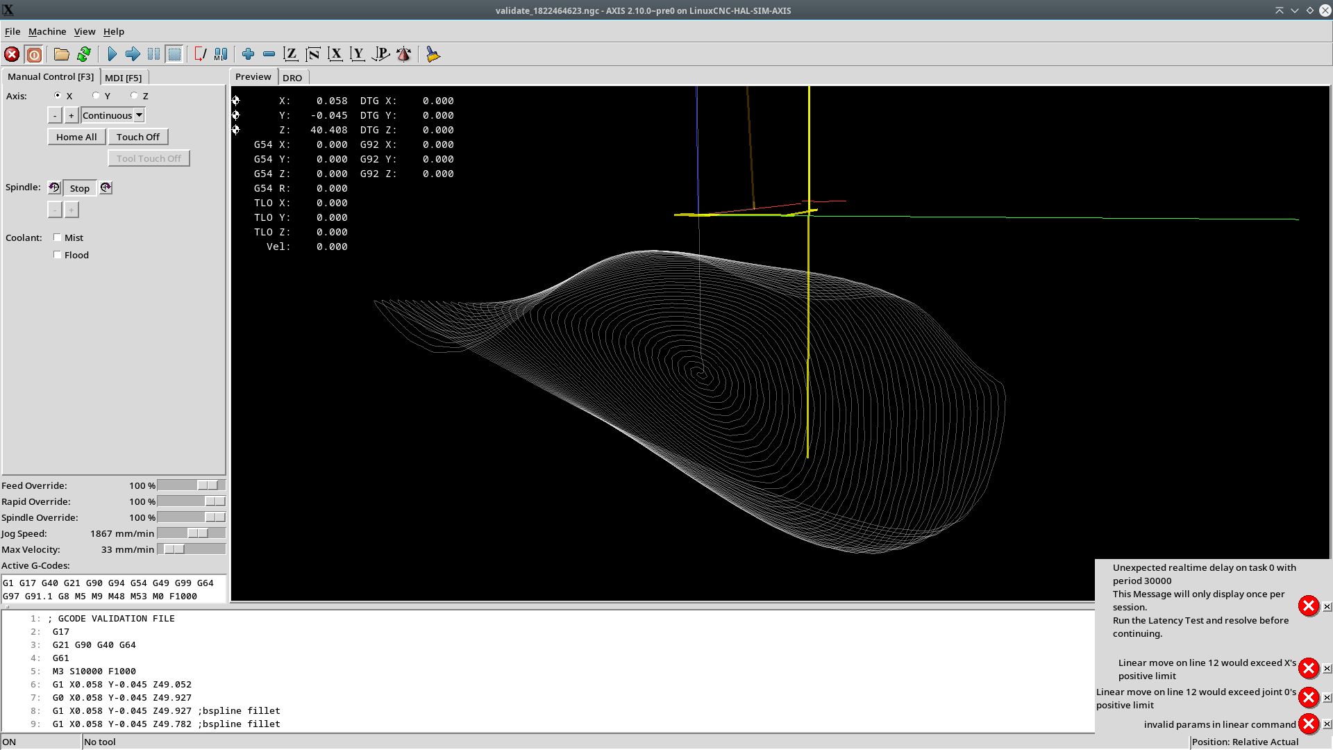

But probing is just a straight line feed that triggers a sensor event? How is this related to smoothing?
Attached a validation gcode file. You could test this in linuxcnc. It's result of a G64 P20 Q0.
To visualize this, the fillets are drawn as G1 linestrip.
This was hard work, because what you see is a filletized path using clothoids.
To use them in 3d space, i had to add logic to project 3d planes to xy planes and back to do the clothoid calculations.
At one point in the original gcode file it sees a transition from arc on xy plane to a line that goes z up.
This is a situation where segments points are not all in the same plane.
This situation is then reverted to use a bspline.
So far no tiny segments are filtered out.
For the source code, Clothoids-1 is added. This cmakelists file has to be reviewed as it is quite a mess now.
The clothoids lib integration was quite a lot off alien obstruction. But at least is works now !
repository

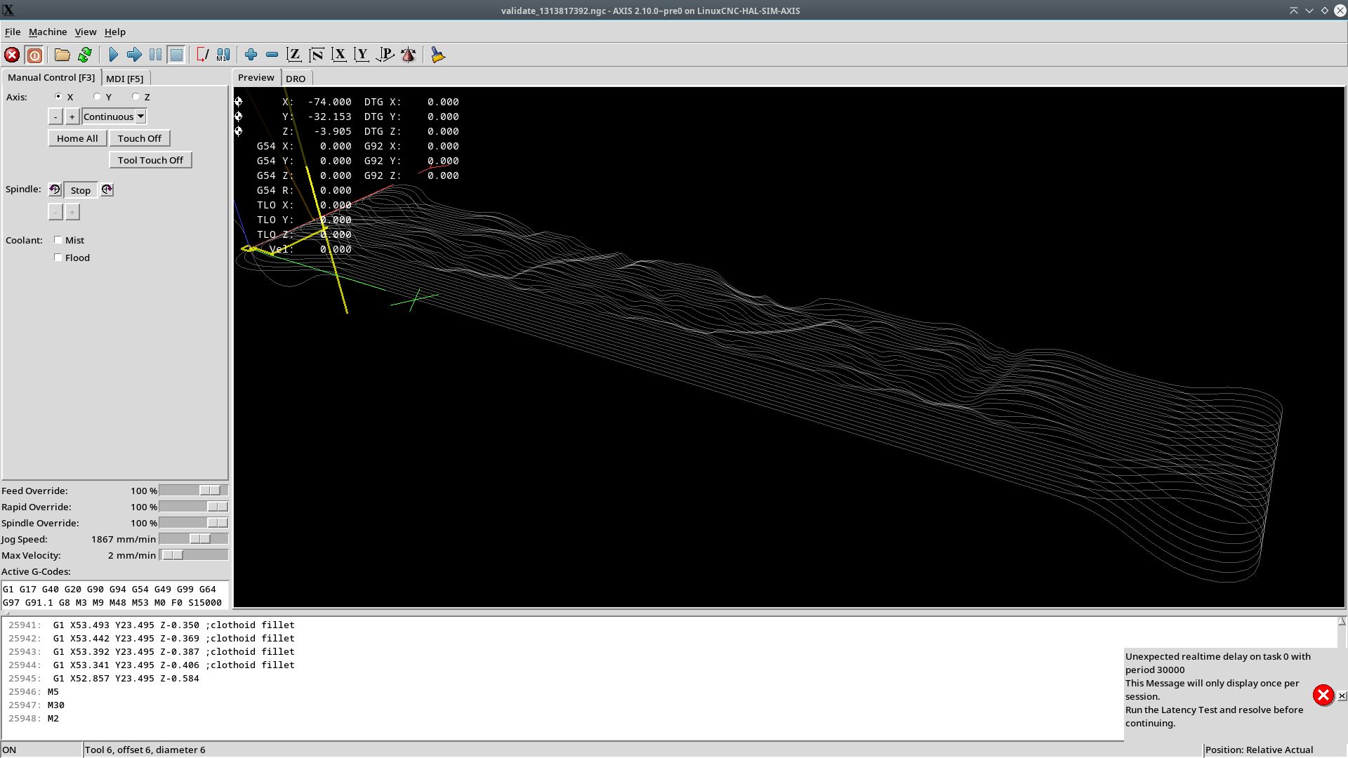

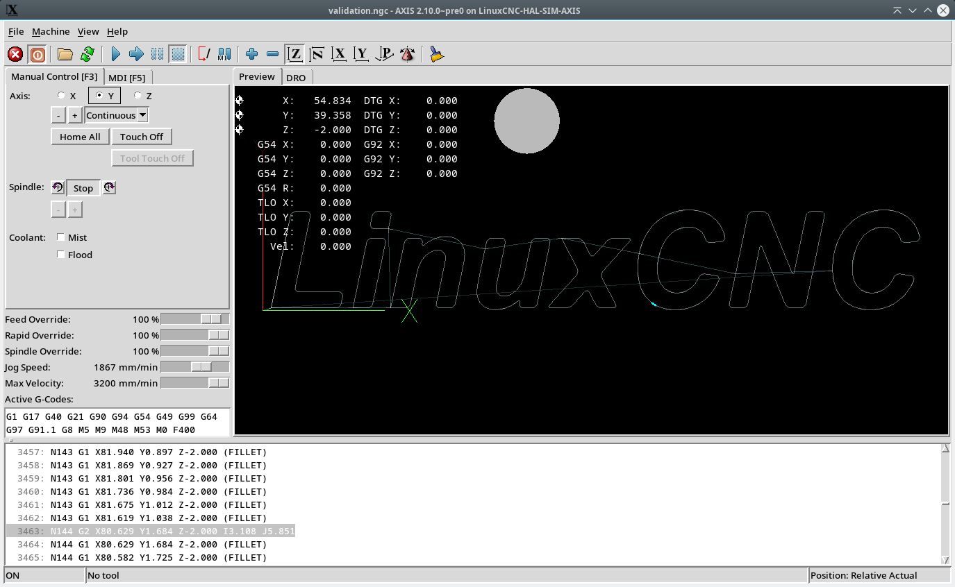

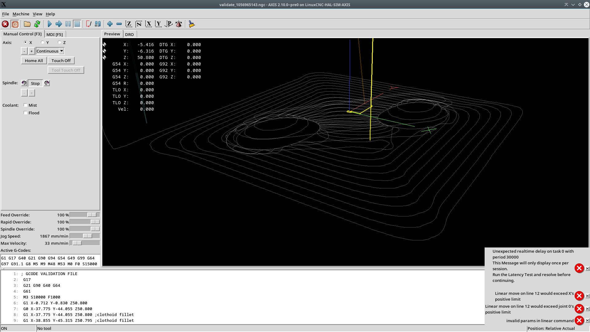

In the mean time i did some tests.
This are situations where the G64 P20 Q0 is used. Extreme situations to verify the blend algoritme for robustness.
Will show now a few pictures sets. Each set is before blending, and after blending with radius 20mm.
This are files using low dimensions so 20mm is just a incredible high value.

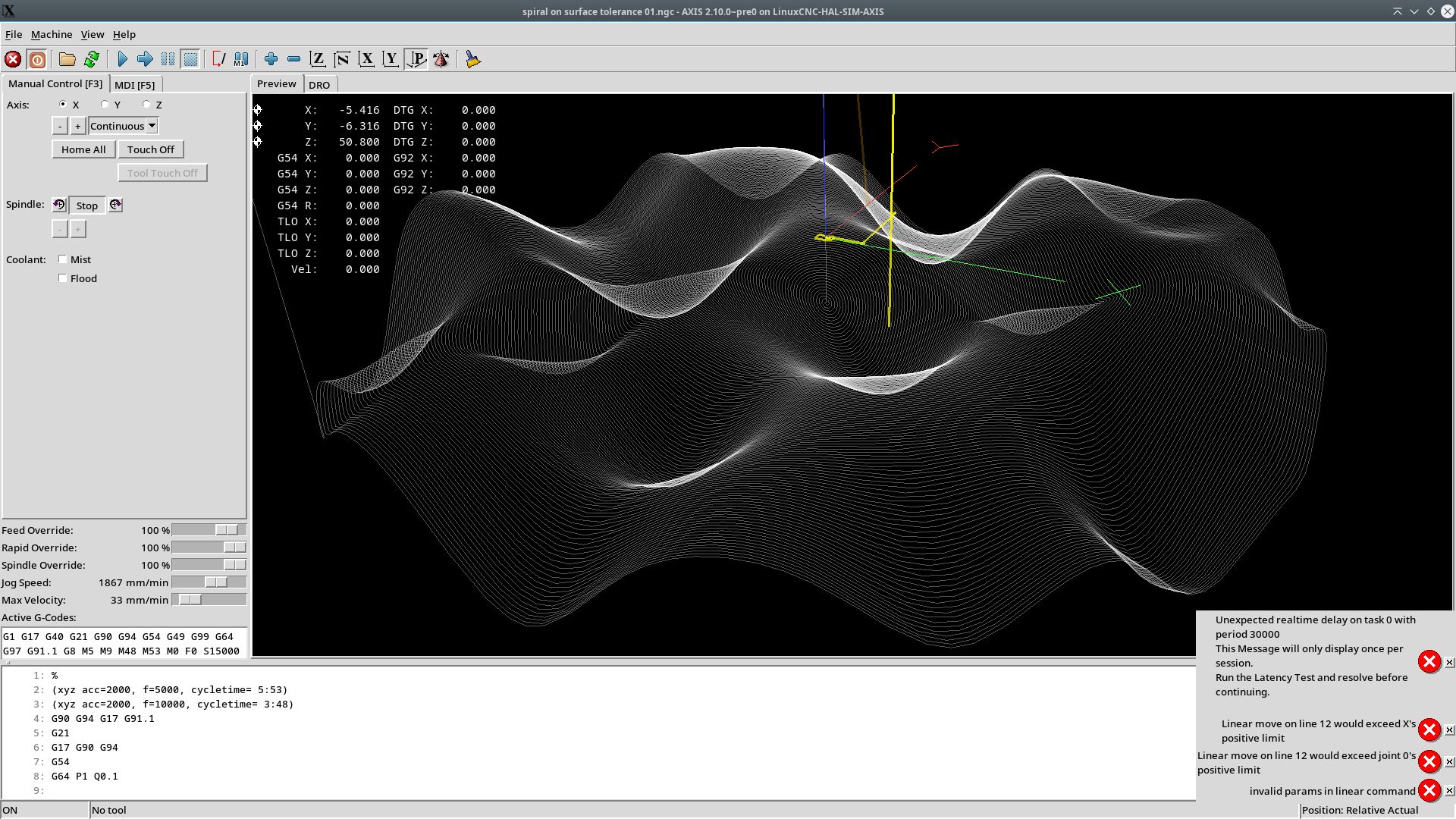

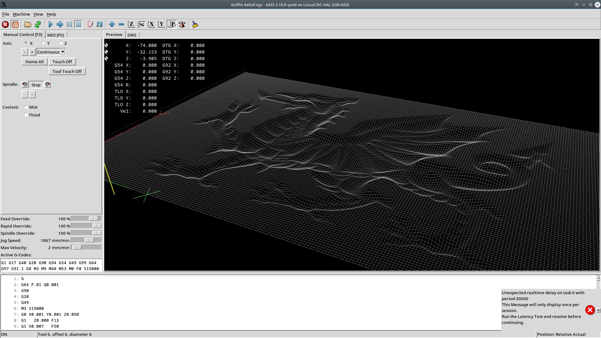

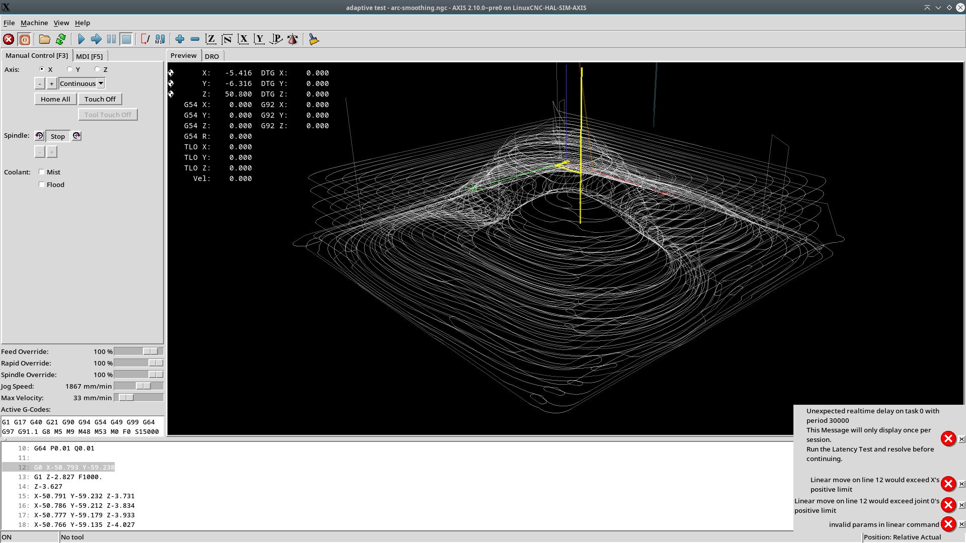

before:
after:
Here you can see the interpreter has given around 20.000 gcode lines. Not the entire file.
Therefore you see the buffered output is filletized as a result. When this then is machined, the next
load will occur.
before:
after:
before:
after:
