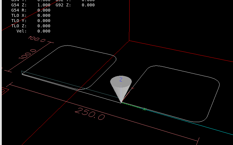

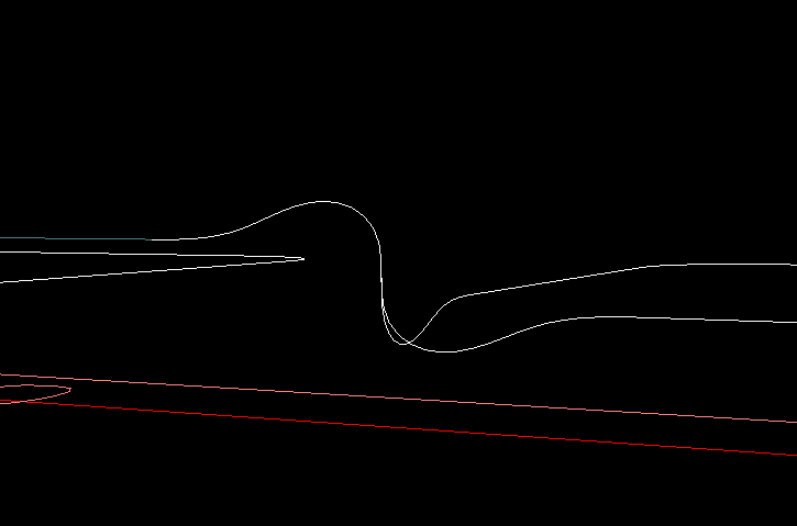

You are likely already aware of this, one issue is that some fillets are extending below the work plane:
My first intuition would make me think that this happens because the vertical line segment is too short to be trimmed back far enough to fit a fillet with the requested G64 Px Qx properties. In this case I would expect the optimizer to either
not cut the segment at all and not create a fillet
or (a more sophisticated path)
cut the segment the way it does now (ie to the minimum length) and create a fillet with adjusted parameters so it does not extend beyond the original segments.

22 Oct 2024 05:08 #312835 by Grotius
Replied by Grotius on topic linuxcnc trajectory planner
Hi Arciera,
Post 22 Oct 2024 06:03
This go trough workplane bottom problem can be avoided by checking :
1.If you have a trim lenght of 5mm. And the line is 15mm, then the line will be trimmed at the ends, resulting a netto line length 5mm.
2.In the case of your post, the trim dist is divided to fit. The line is for example 5mm. Trimming 5mm both ends will fail, then the trim is
divided to fit, wich results for example in a trim 2.4mm x 2 = 4.8mm, Then the netto line is 0.2mm.
Related calculation:
if (trim_distance >= seg.length / 2.0) {
    trim_distance = (seg.length / 2.0)-1e-3;
Solution:
When a trim distance has to be lowered to fit, this then can be a reason to skip this line trim. Let the line as is.
When a full trim fit can be done, the clothoid has no reason to go trough the bottom of the workplane. This then is valid.

So when using the clothoid filles, a divided trim is a signal to not add a trim segment to it. As this can result in going trough
the workplane.
Otherwise when using the bspline fillets, this uses a set off controlpoints. I suggest that bsplines are still valid, as they don't need
to solve the G2 problem.
Line fillets (chamfers) are still valid.

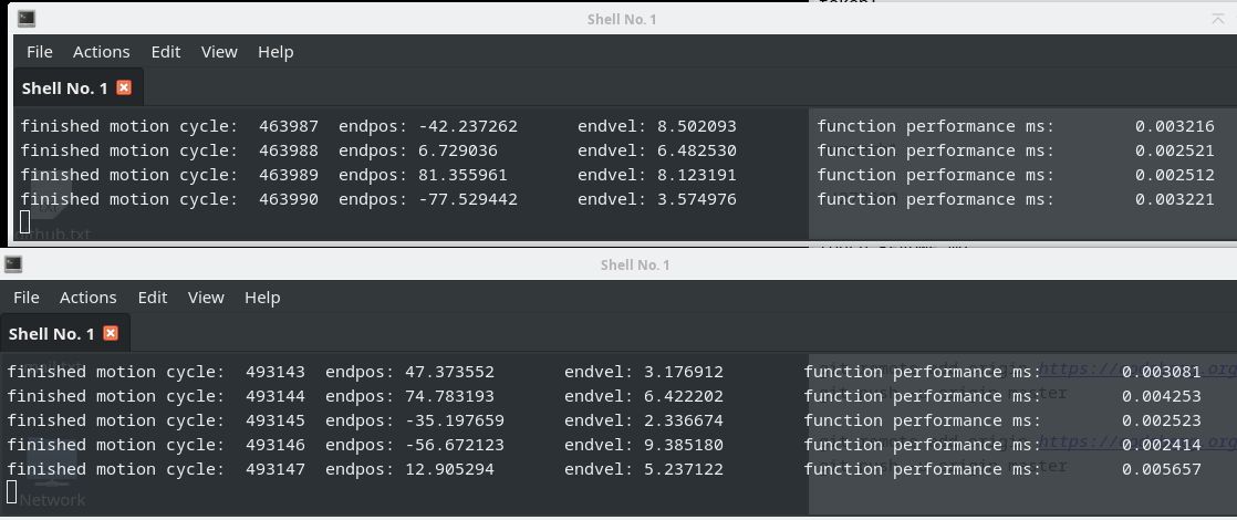

Today was a difficult coding day. I expected the stress test would go ok for using end velocity's. But not.
It took again the whole day.
Had some hard times solving a bug : using end velocity's, then when changing from negative to positive direction.
In the end this works now.
these few lines solved it.
Today the scurve lib is stress tested for 2.000.000 iterations, motions using random double values between :
1. Positions -100 to 100
2. End velocity's -10 to 10
The stress test file : stress test
Output, running 2 instances:
